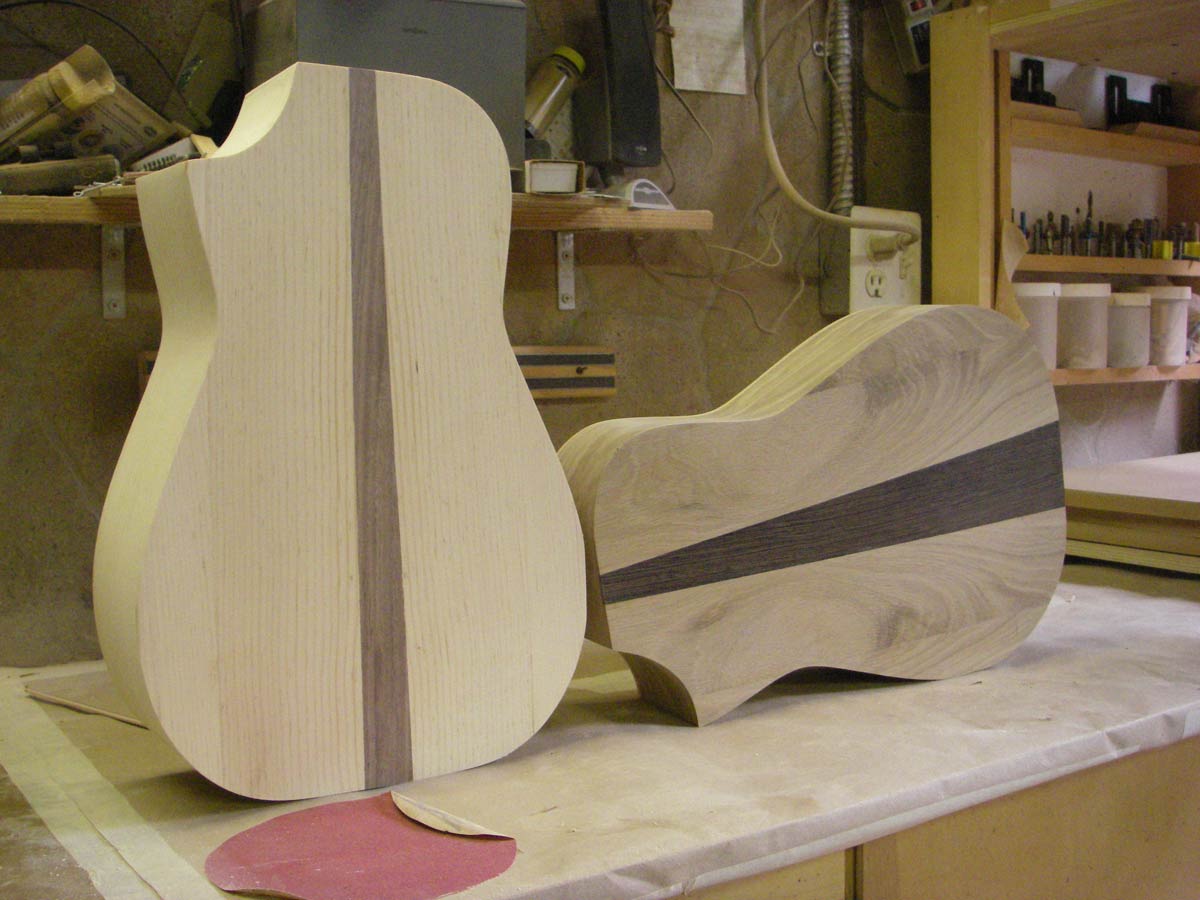

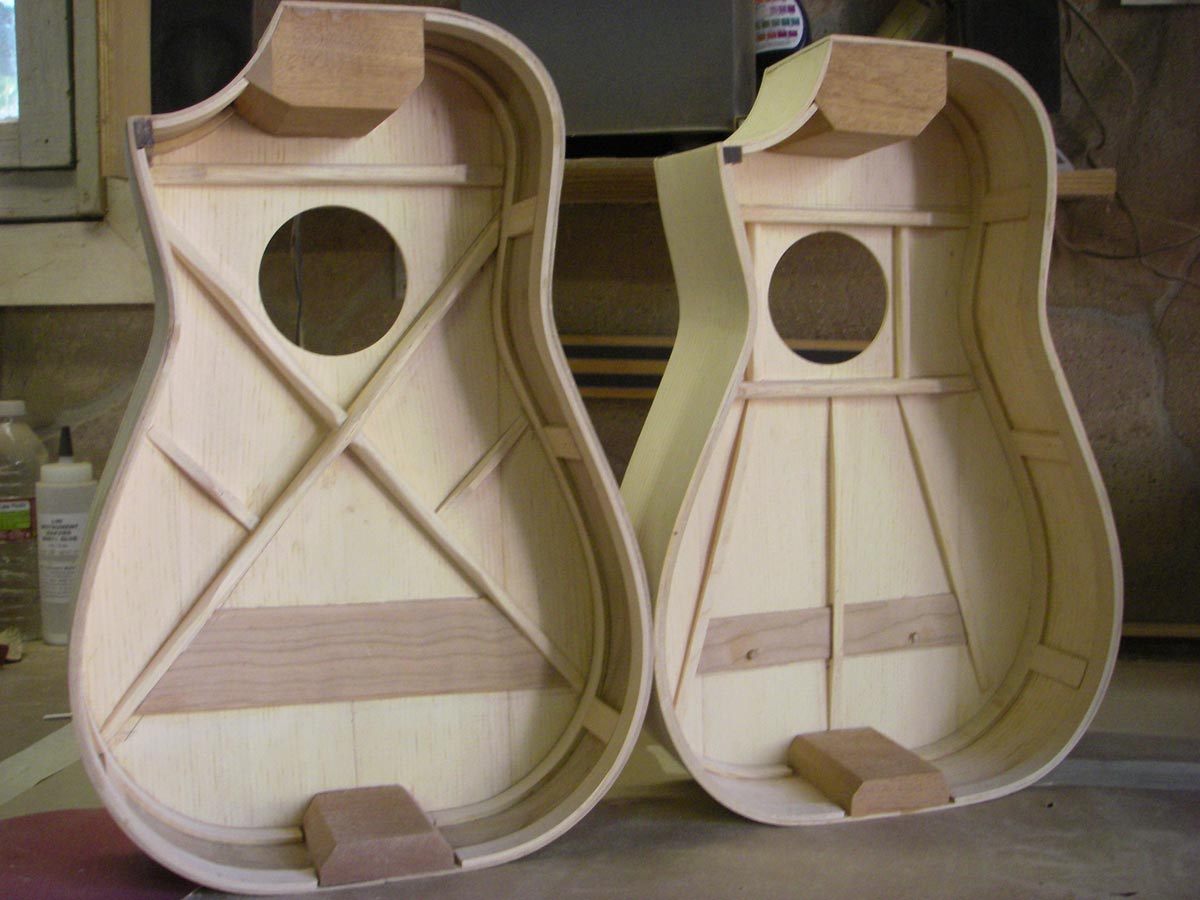

Here is a shot of the two travel guitars from the back, showing the different bracing patterns (steel srtring vs nylon string).

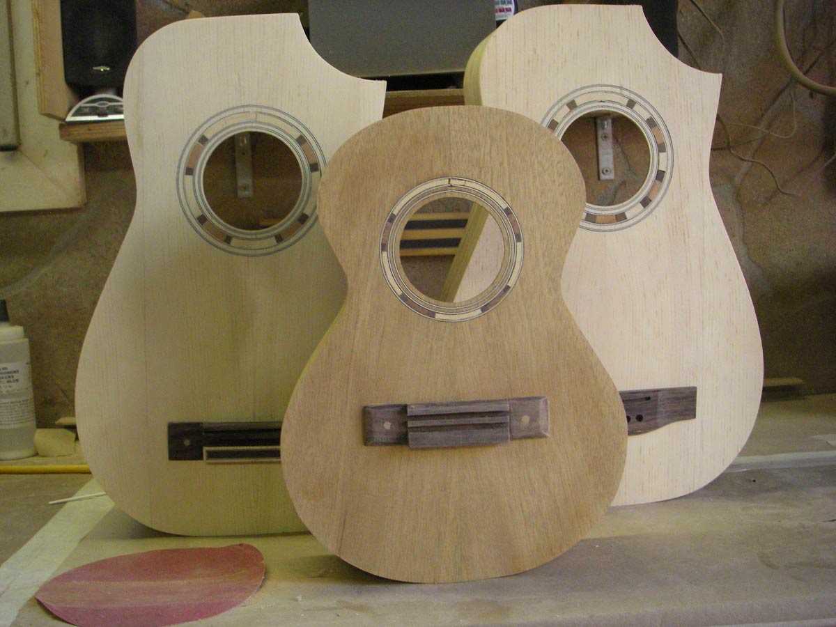

Just to give an idea of the size of the travel guitars, here is a shot of the travel guitars with the uke I am building for my other project.

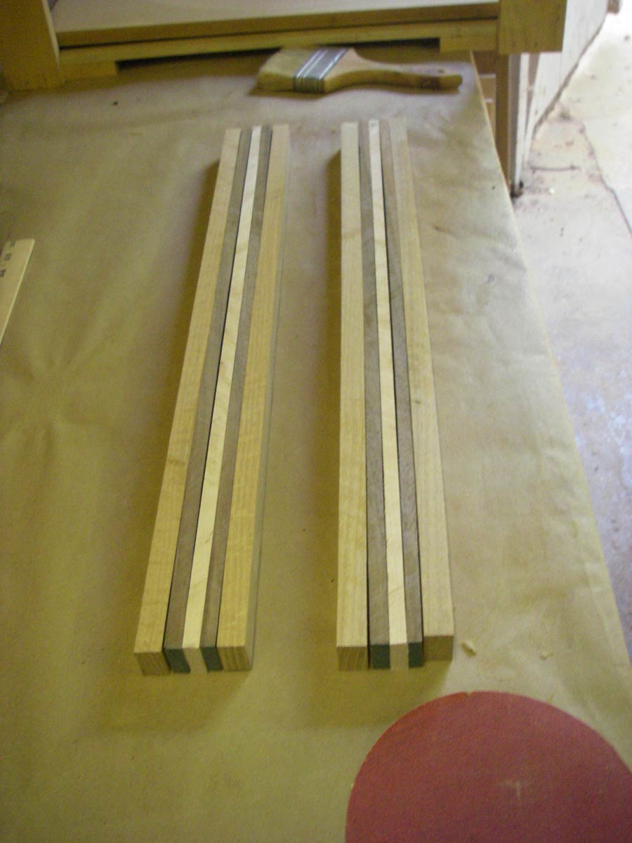

Postby Patrick DeGreve » Fri May 03, 2013 1:49 pm
Now to start the neck. I like a blocked up neck. I like the look, and it adds strength. I took a piece of the oak flooring that was flat sawn and planed off the finish. Then I cut it into two lengths 1" X 28". When I glue them up the grain will run vertical, making them the same as a quarter sawn blank. I also cut a center strip from some maple I had 1" X 3/8" X 28", and two strips from some walnut at 1/4" X 1" X 28". These will become the neck blank.

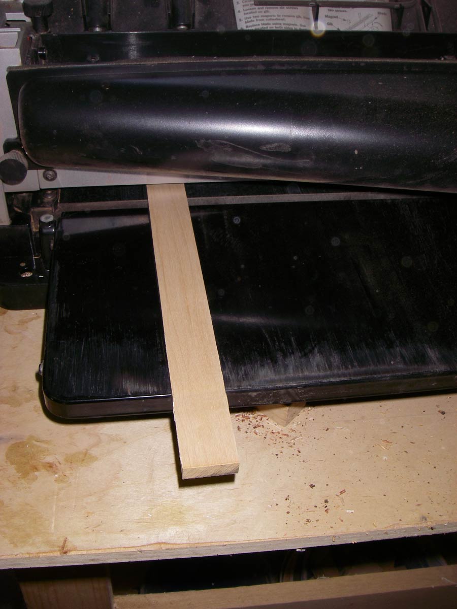

Postby Patrick DeGreve » Fri May 03, 2013 1:50 pm
Before I glue them together I ran them all through the planer.

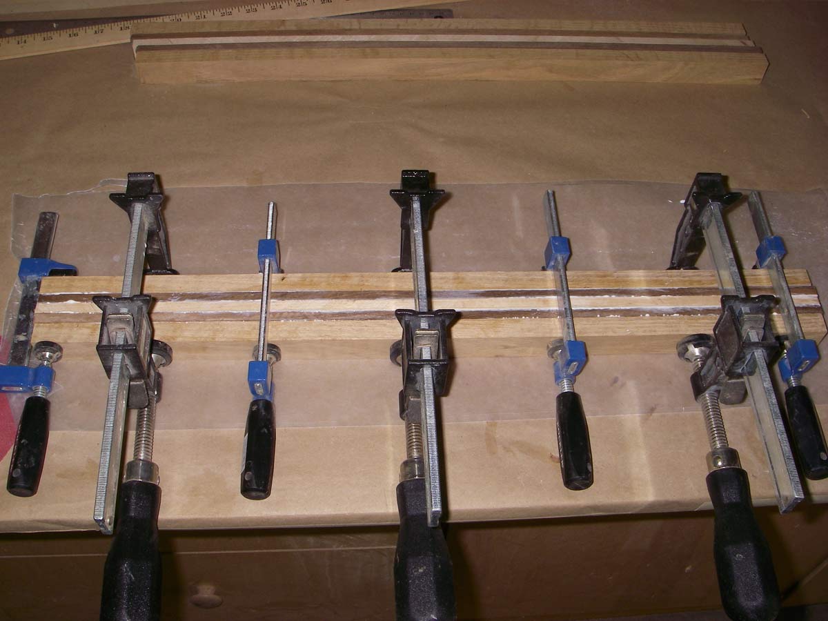

Postby Patrick DeGreve » Fri May 03, 2013 1:51 pm
Then I glued them up to make a neck blank.

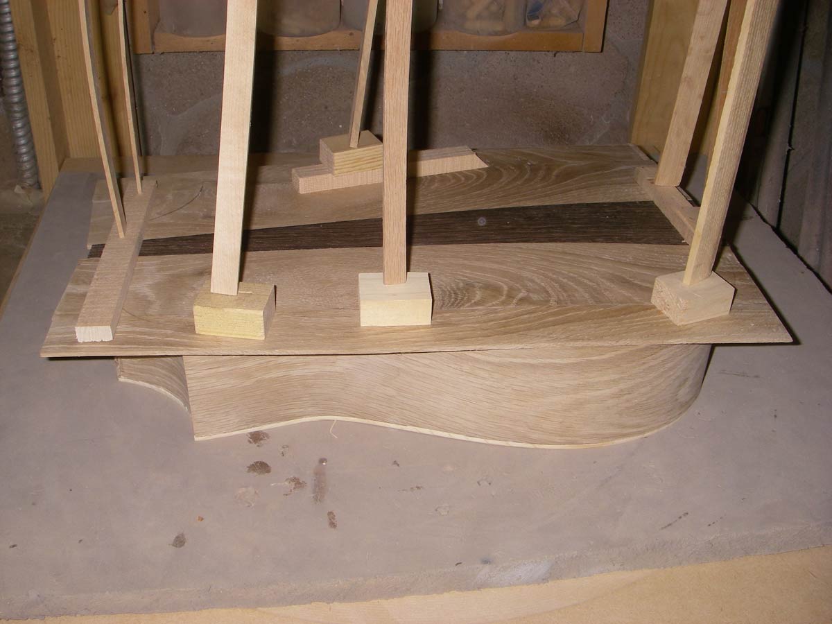

Postby Patrick DeGreve » Mon May 06, 2013 2:20 pm
Thanks Warren, when I first started thinking about making guitars a few years ago, I read that Oak was not used for guitars because it was a "dead" wood. Now I see a few wood suppliers selling guitar sets with oak. This challenge has given me an chance to see what I it sounds like. Last week I cut braces from the pine for the backs, pre-shaped them, and glued the up using the go-bar press.

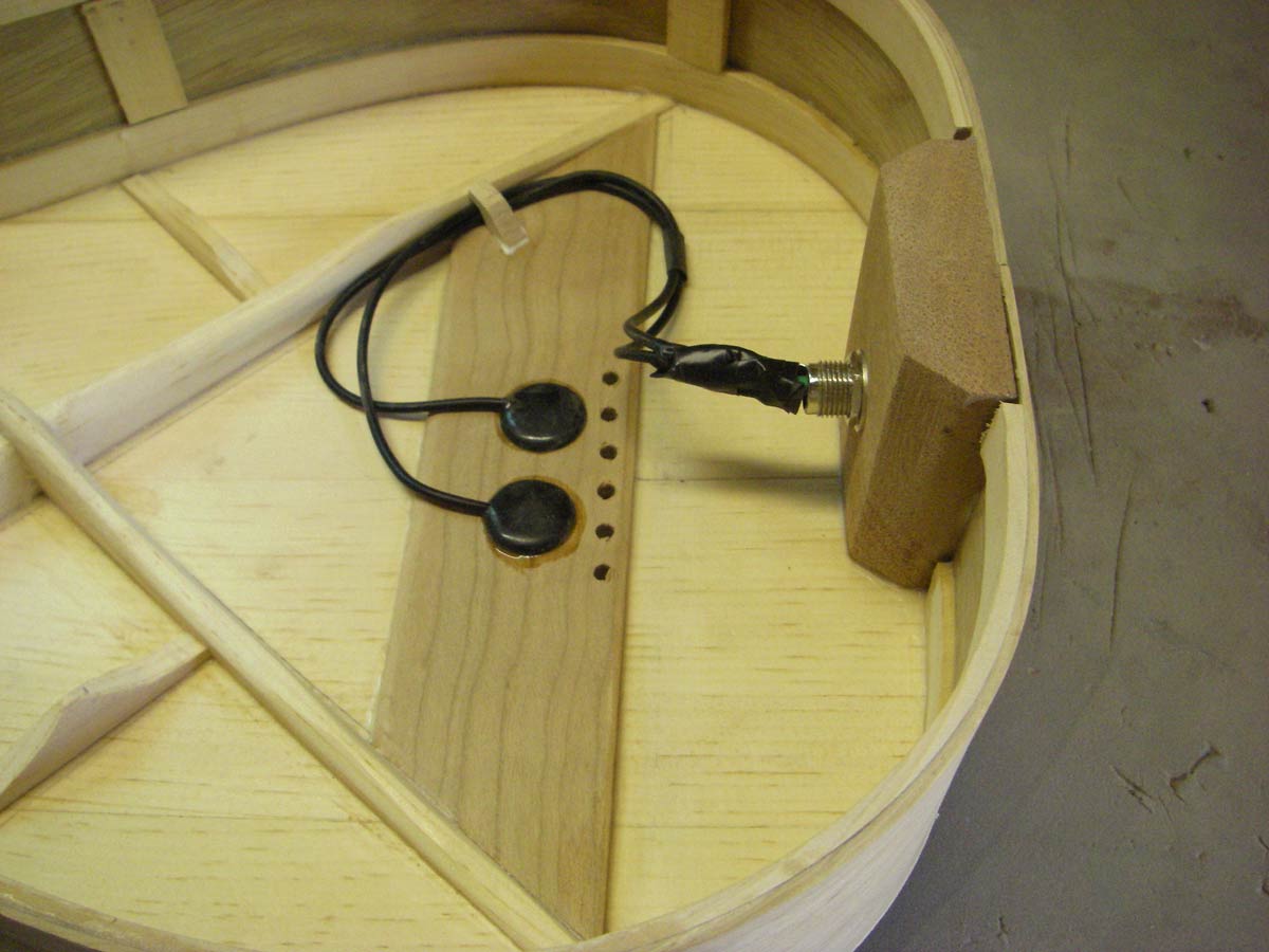

Postby Patrick DeGreve » Mon May 06, 2013 2:29 pm
I decided to add a JJB Electronics transducer pickup in the oak steel string travel guitar. I am not going to put a pickup in the nylon string guitar. I used their 2 transducer standard unit $19.95. I have used a few of their three transducer units and they worked fine. I am not going to install a pre amp in this guitar, (they say you don't need one for this system), we will see. I have a very small Fender battery operated amp that is so light and small you could put it in your backpack easy.

Postby Patrick DeGreve » Mon May 06, 2013 2:30 pm

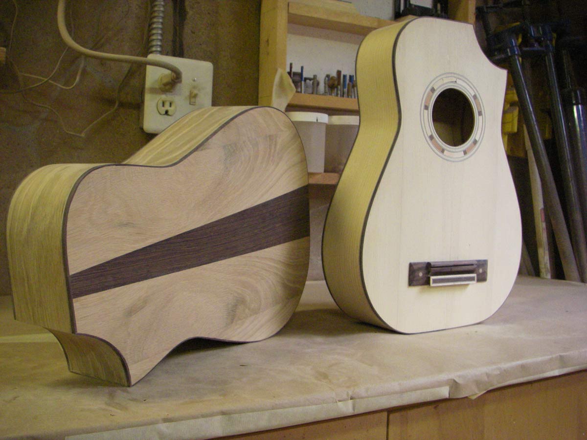

I next glued the backs onto the travel guitars, again using the go-bar press.

Postby Patrick DeGreve » Mon May 06, 2013 2:32 pm
Here is a shot of the backs of the two travel guitars.

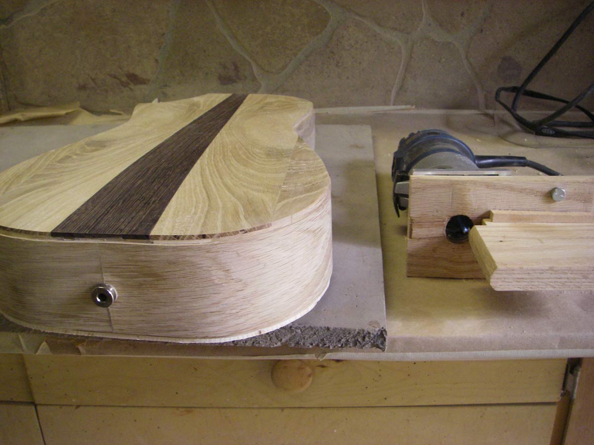

Postby Patrick DeGreve » Mon May 06, 2013 2:33 pm
Using a jig I made, I routed the recess for the bindings I pre-bent with the fox style bender.

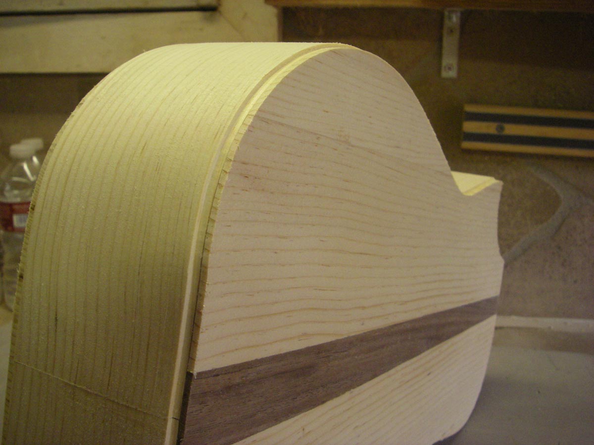

Postby Patrick DeGreve » Mon May 06, 2013 2:34 pm
Here is a close-up of the recess on the pine guitar.

Postby Samuel Hartpence » Thu May 16, 2013 1:11 pm
How about some more details on the binding channel jig. I'm in need of something similar.
