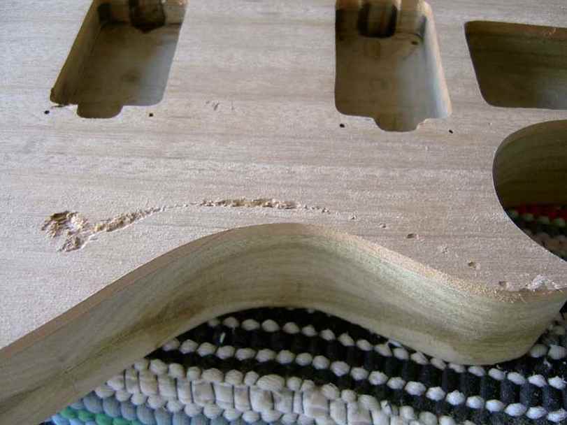

Postby Henrique Schneiter » Wed Feb 08, 2012 10:38 pm
Oh, my list is long...
A bad one I can remember now was a "flying router". The router got out of control while routing the pickup cavity and damaged the top. After a lot of sanding, the remaining hole was filled with thickened PU finish. Luckily, that hole ended being under the LP-style pickguard.
These things must be held REALLY tight while working.
