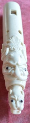

The attached pic shows a tubular ocarina, carved from bone (horse metatarsus, to be precise) having four fingerholes on the top, giving an octave, plus two more thumbholes, adding another two notes. Could have made that into a third, too, but didn't see any need for that.
With each fingerhole, start undersize, and keep on enlarging them until the right note is reached. The first fingerhole will be as tiny as 2mm in diameter. The one an octave above will reach something in the region of 8-9mm, or even more.
Otherwise there isn't much that constricts the imagination. As long as the mouth is made carefully, and produces a decent tone, the only other requirement is that the internal volume is airtight apart from the fingerholes, and there aren't too crazy internal twists and turns for the air volume to get lost in.

You made this bone instrument, Yuri? That's beautiful!

Wow, like a micro-recorder. Does the stopper at the end pull in and out for tuning, or just decoration?

The stopper is for fine-tuning the basic pitch. With any ocarina (or, for that matter, any flue woodwind especially, but to a lesser extent any woodwind) as you play, the pitch changes with the warming up and change in the moisture content of the instrument. Which means that if you play with a fixed pitch instrument(s), you are in trouble. A recorder, which is a tiny bit less susceptible to this affliction, can rise in pitch as much as 10 cents or so. So your guitar or whatever accompanist must stop and retune the guitar. (or the whatever, like the piano or the great cathedral organ ) That is, if you have a single-piece recorder. Fortunately for modern players, recorders these days are very rarely single piece ones. (you just pull out the middle joint a bit, and voila! the pitch drops.)
Well, ocarinas are even worse than recorders. Hence the stopper. You just pull it out a bit.
Actually, if you pull it out a rather considerable, but still feasible bit, you can play in A=415, and it is still reasonably in tune. Not that I ever met anyone wishing to play in Baroque pitch on one of these, but you never know...
