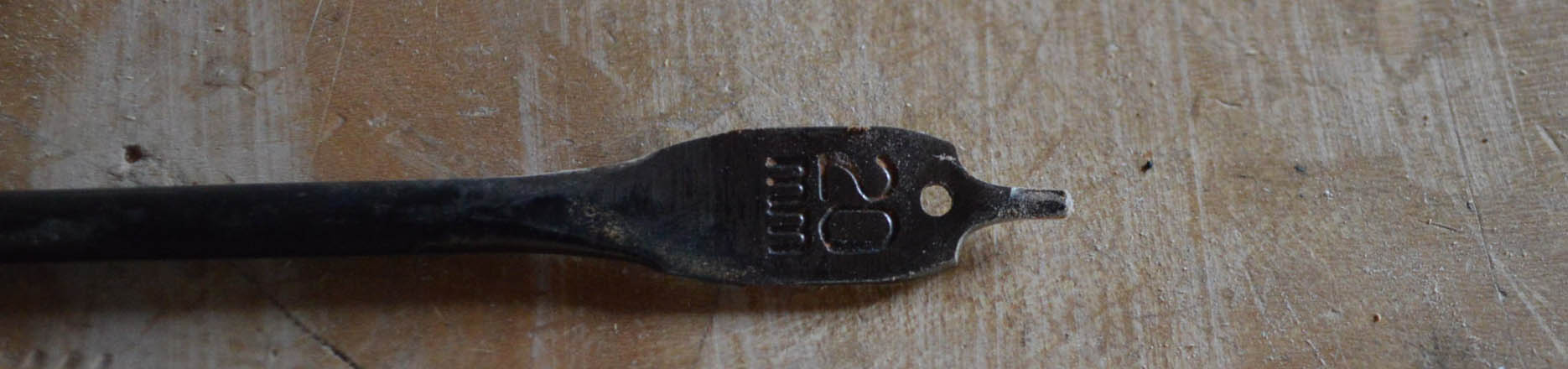

Postby Yuri Terenyi » Tue Jan 07, 2014 10:32 pm

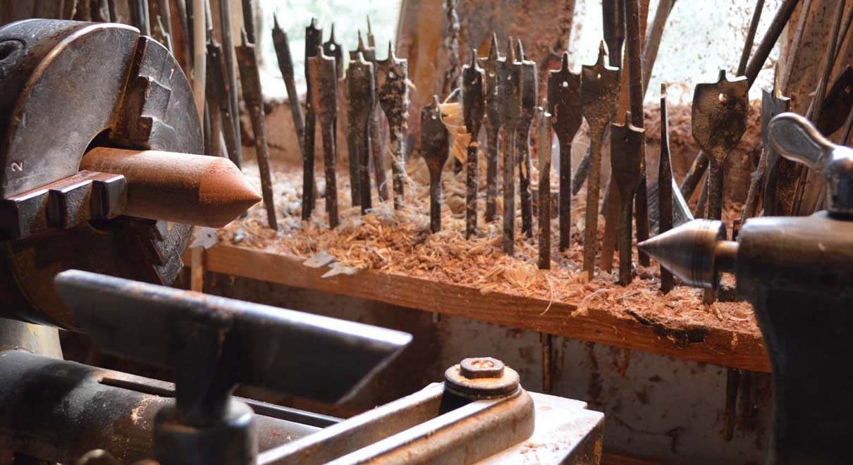

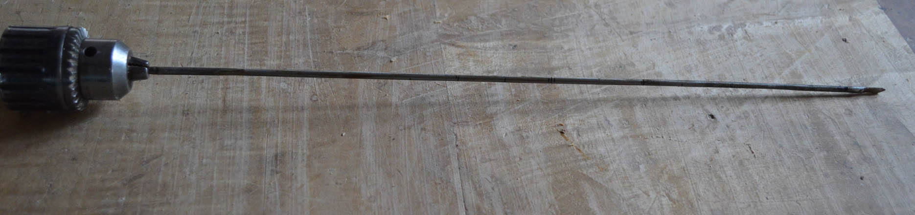

The tools I'm about to use for the drilling out. The spade bit leaves a rather smooth surface as it is, but I still prefer to ream it out for a truly mirror-smooth surface. The demo is for a cylindrical pipe, but the principle is identical for, for example, baroque recorder profiles. You just need to work a bit more on the reamers.
The profile of the eventual drill bit. A normal spade bit, rounded off everywhere, to avoid too rough inner surface.
Same in profile
The tip head-on.
It has to be noted that it has been sharpened and re-sharpened time and again, so by now it's rather short. But still serviceable.
The shank, by the way, is left 4mm only for the first dunno, maybe 15mm or so, the rest is taken down on a sander to maybe 3.5mm. To avoid too much friction.
The D-bit. Held in an old drill jaw. (by hand. You can't see, but there is no drill attached.) 4mm diameter, made in this case from the shank of a 6mm spade bit. (because tool steel in this size is difficult to get where I am.)

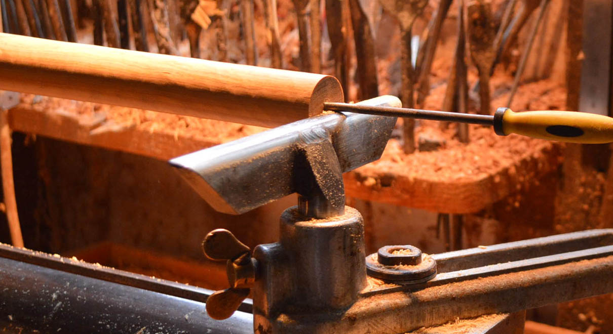

Postby Yuri Terenyi » Tue Jan 07, 2014 10:46 pm

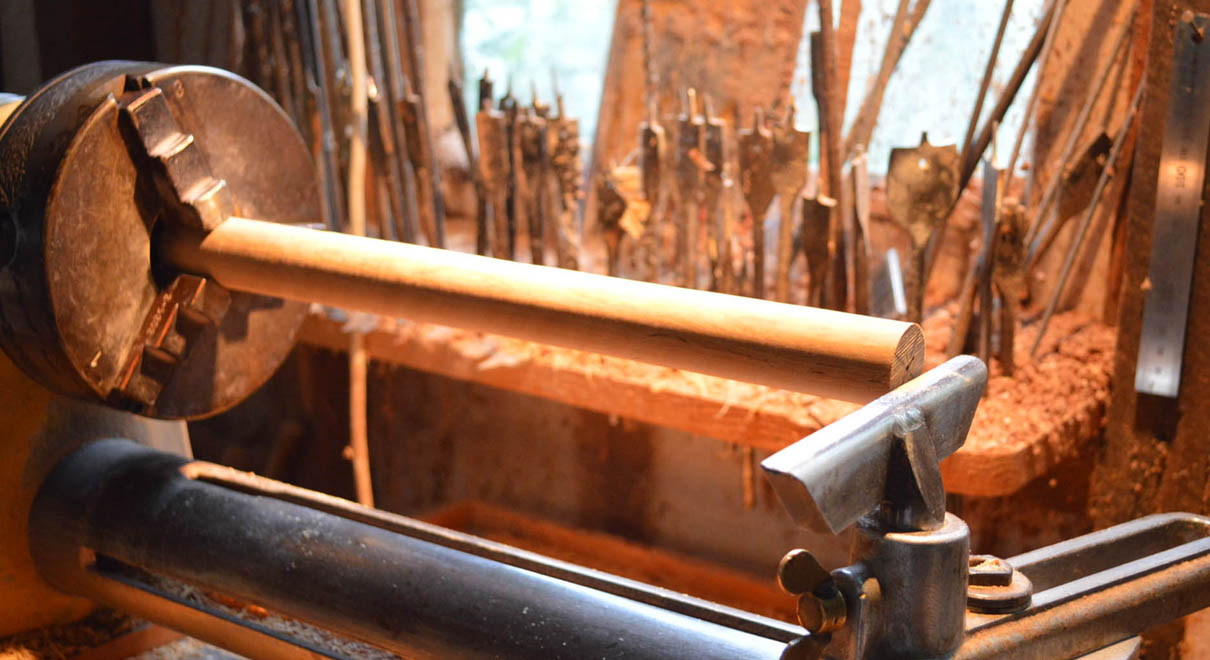

The lathe I have has the 3-jaw chuck slightly beating. Well, you get what you pay for, and I couldn't pay much when I got it... So I have to make things a bit differently. The result is that I do not use a steady even.
Step-by-step:

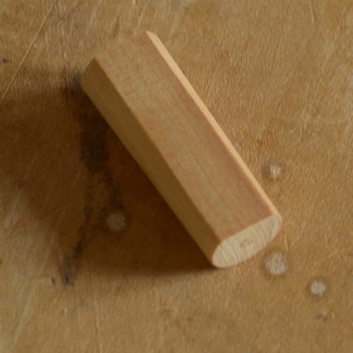

Turn down the piece of wood to cylindrical, the normal way, between two points.
Grip the cylinder firmly in the jaw.
Turn the end smooth, and turn a centerpoint using a pointy kind of tool. I make these from files, once again. (files are too hard steel for normal turning, however, for this micro-turning they are fantastic. I have yet to have one breaking, after many years of using them.) By now you will notice that however careful you are, the stick will beat slightly.
Now stick the tailstock point into the centerpoint you just turned, and trim up the beating, so the whole thing is very slightly tapered now, and running smooth.
The D-bit making, if you are about to do it. Get the rod of the required diameter. Grind away exactly half of the thickness from the tip for some 5-10mms. The exact halving is exteremely important. If it's thinner, it will drag down, if fatter, up. In either case you end up with the bit wondering out of the true center. The closest you get to exact half, the better.
The chisel I use for starting the bore is made exactly the same way, but the tip is round rather than off-centre pointy.
The look of the starting point.
Starting the bore.
The chisel for starting the bore. Made from an ordinary needle file.
Same again.
The reamer as it looks like when withdrawn from the bore.

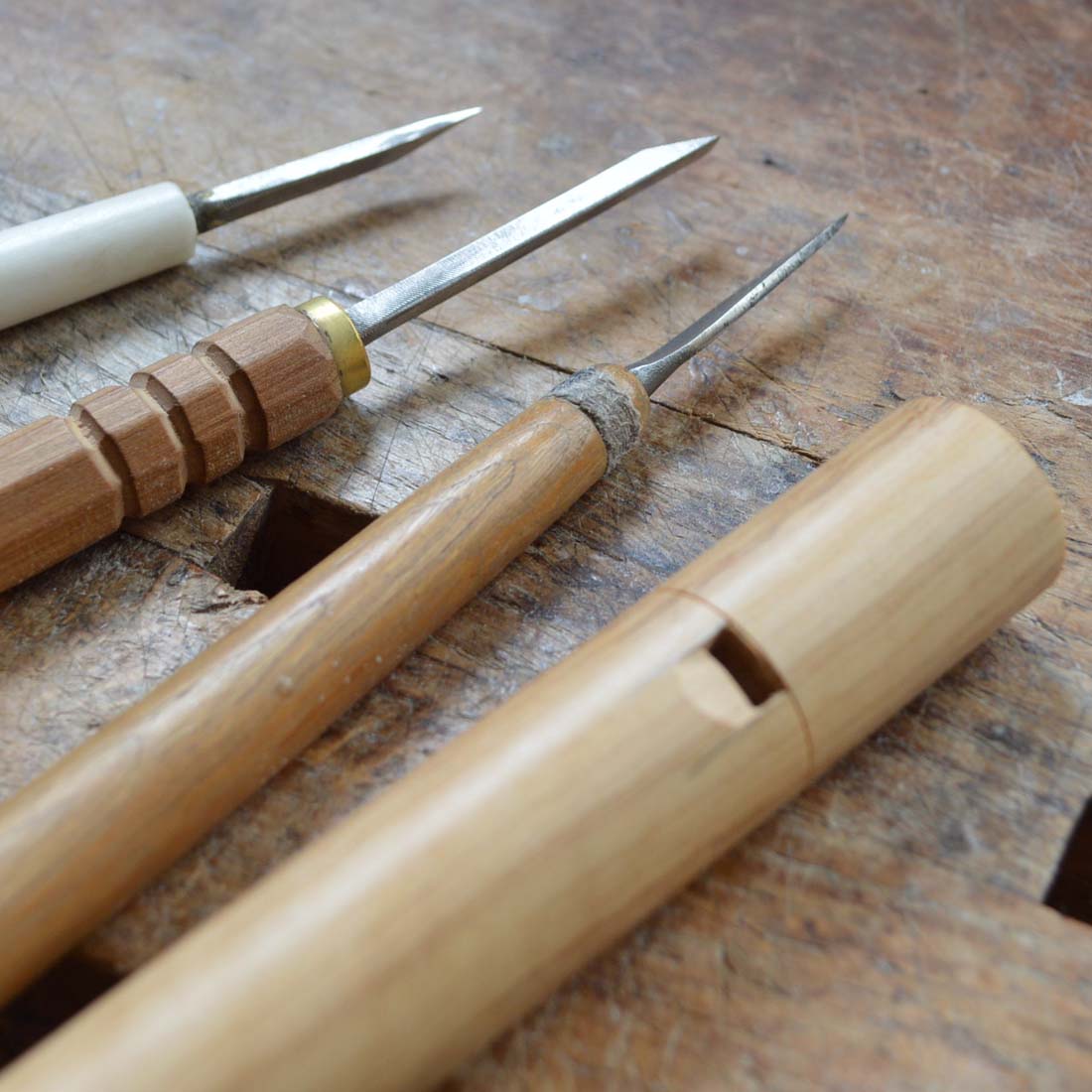

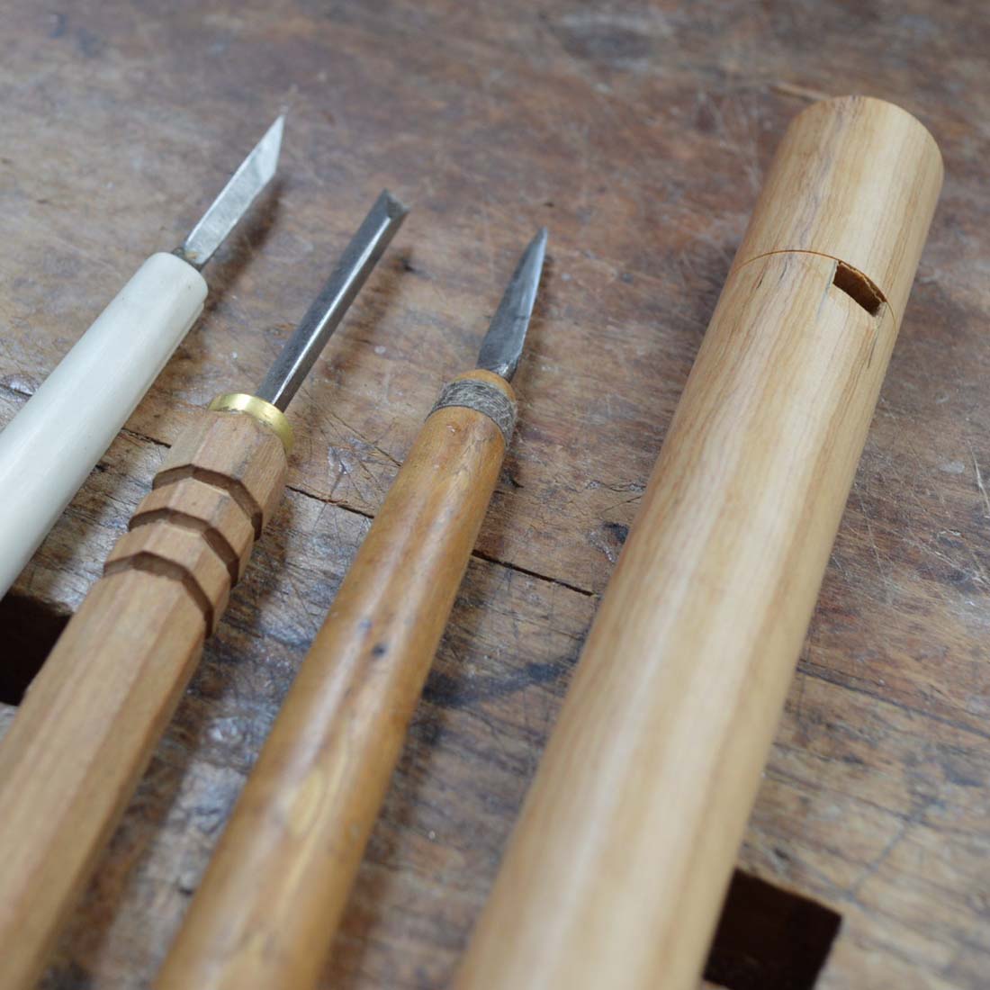

The tools for cutting the window true.
Same from another angle.
Yuri Terenyi
Posts: 132
Joined: Fri Jun 29, 2012 12:56 am
Re: fipple flute making - step by step

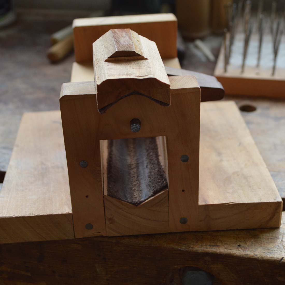

Postby Yuri Terenyi » Tue Jan 07, 2014 11:21 pm

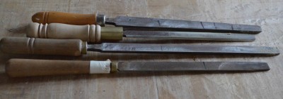

The knives and chisel above are all made from files. The one with the what looks like plastic, but is in fact bone, handle is made from a chainsaw file, the chisel from a small triangular one, and the other knife from a larger kind of needle file.

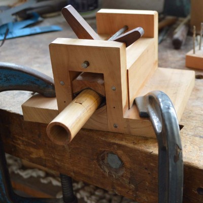

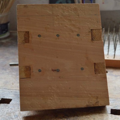

Now, the box in which all the windway cutting takes place. I think the photos are really self-explanatory. By the second photo you see a few small wooden shims of different thickness. These are the ones going on top of the upper block that grips the pipe being worked on. The hold-downs are cams made from a hard wood. Both upper and bottom blocks are lined with leather.

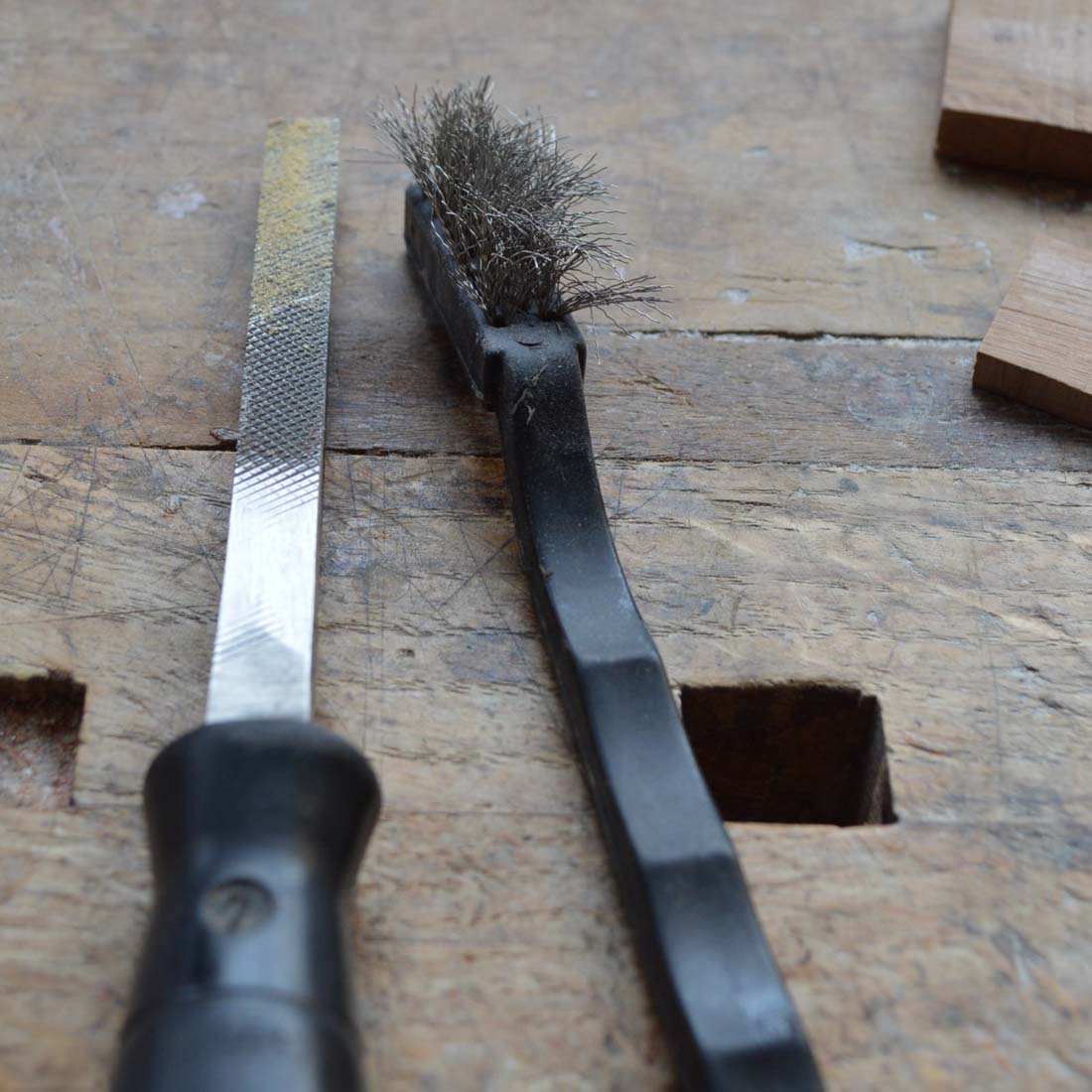

Postby Yuri Terenyi » Tue Jan 07, 2014 11:31 pm

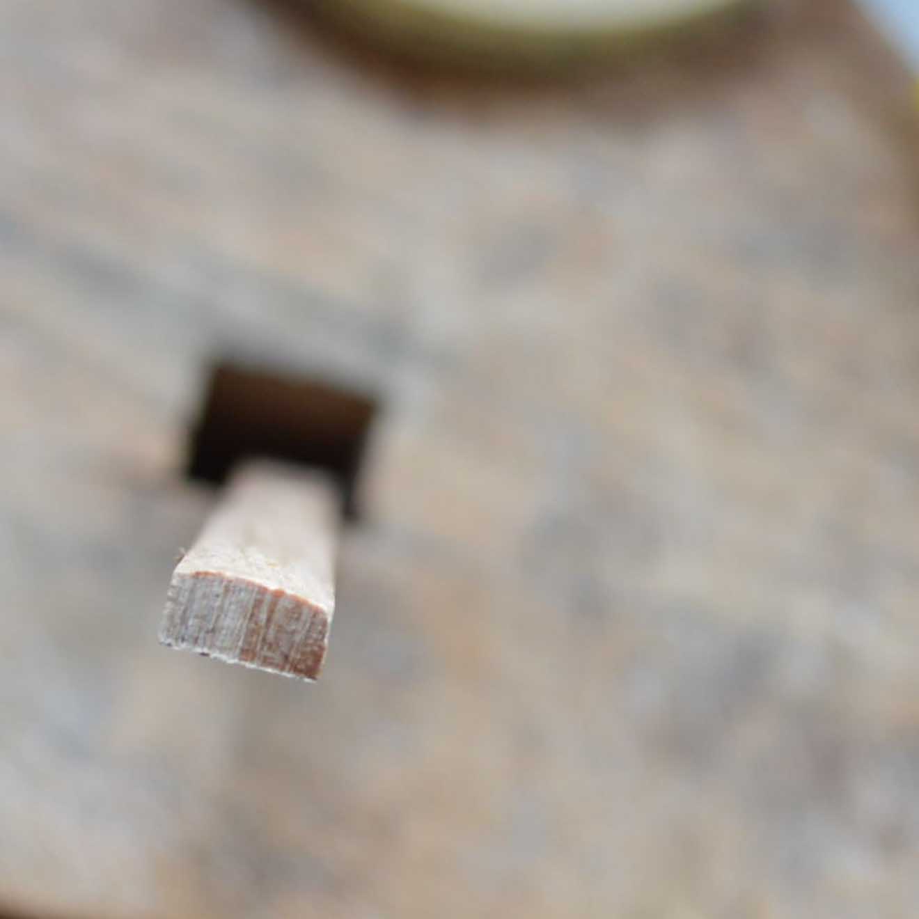

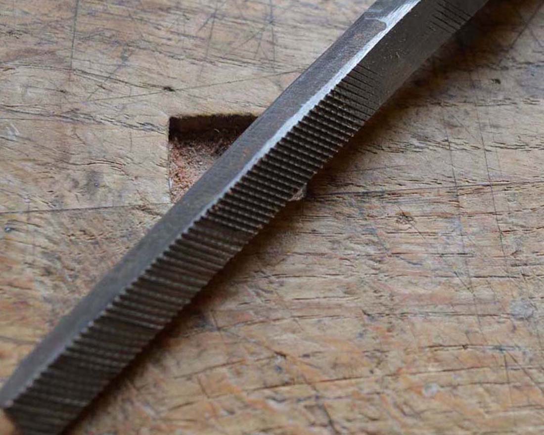

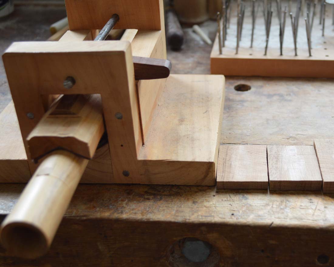

The cutting of the windway. Read the pictures back to front, I keep on forgetting that they appear in reverse, the last one should be the first one.
The first cut, just to establish the channel. At this stage the channel is a tiny bit wider than the window already cut, the idea is that you widen the window to the exact width of the channel at this stage.that
An important tool the wire brush. Sounds silly, but it is.
The file that cuts the windway channel. An ordinary bastard cut file (looks funny because it has been re-sharpened, using diamond very thin discs). The important thing is that the two sides are ground flat, to the exact width. I also use some grease on the sides, helps to prevent drag.

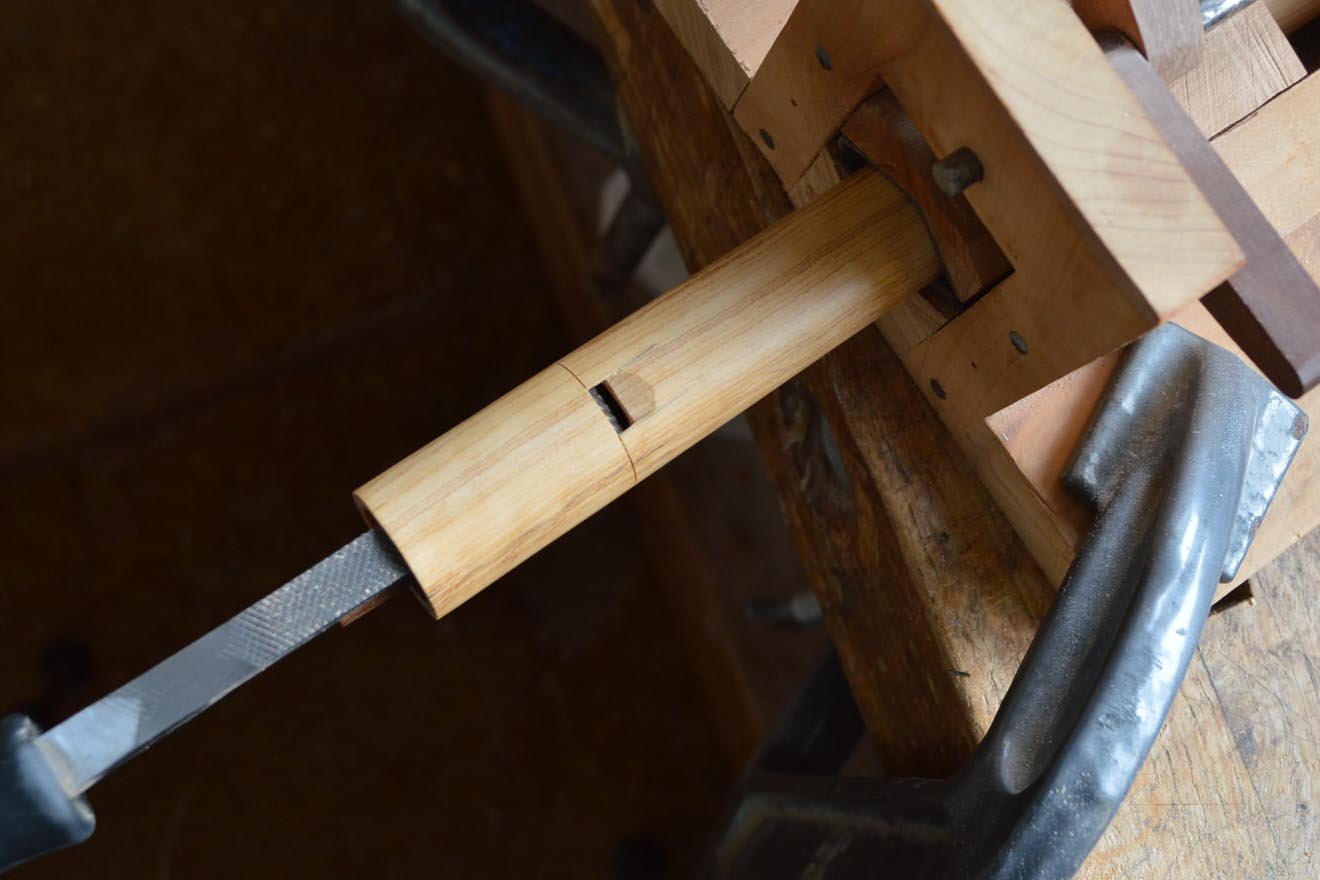

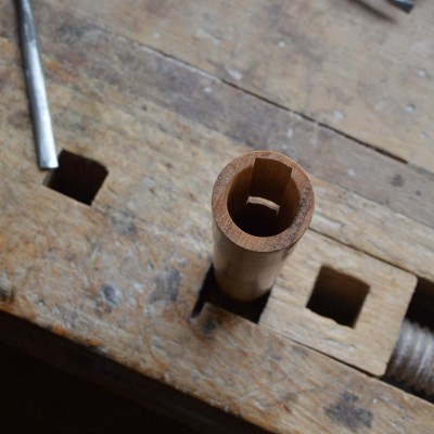

Postby Yuri Terenyi » Tue Jan 07, 2014 11:38 pm

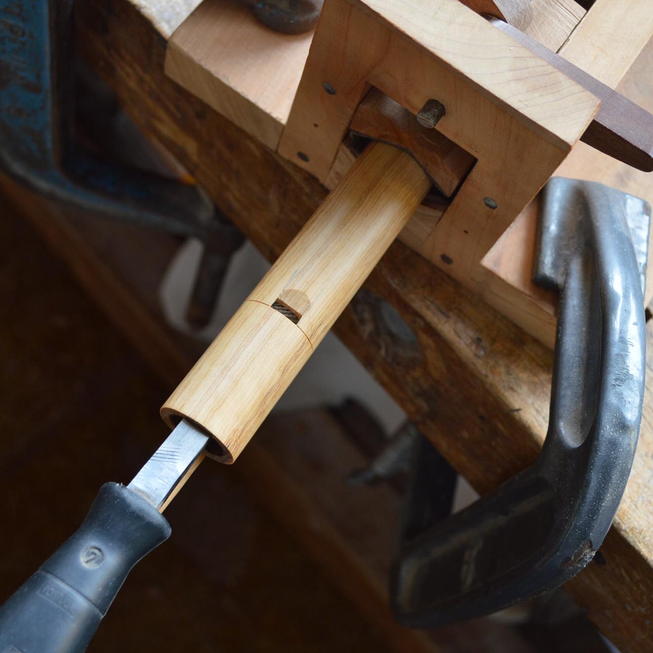

Cutting the windway roof and the bottom of the labium (lip.)
Since I am making a curved labium, the process is described as well. But if you are after a straight one, you need to take the windway roof somewhat higher, so the underside of the labium can rise until it clears the curvature.
Position of the file when cutting the windway rood.
Position of the file when cutting the underside of the labium. You will notice that the cutting ridges are smoothed out towards the handle. This is the reason. So they don't enlarge the windway roof in undesirable ways.
The look after the underside of the labium (lip) has been filed. Be very careful at this, as only a couple of strokes will get the edges up to the required level. The two edges of the underside of the labium should be (for instruments of soprano-alto size) be about some 0.8mm or so below the underside of the windway roof. (at the edge, that is.)

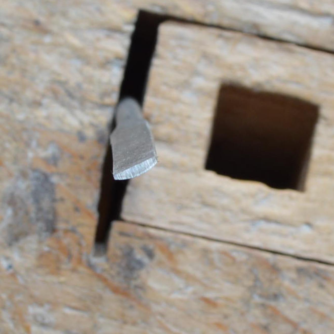

The chisel. Or rather, the scraper, really. The edge is at about 80 degrees or so. Made, once again from a needle file.
What it looks like after the rough cutter work, before the finishing refinement.

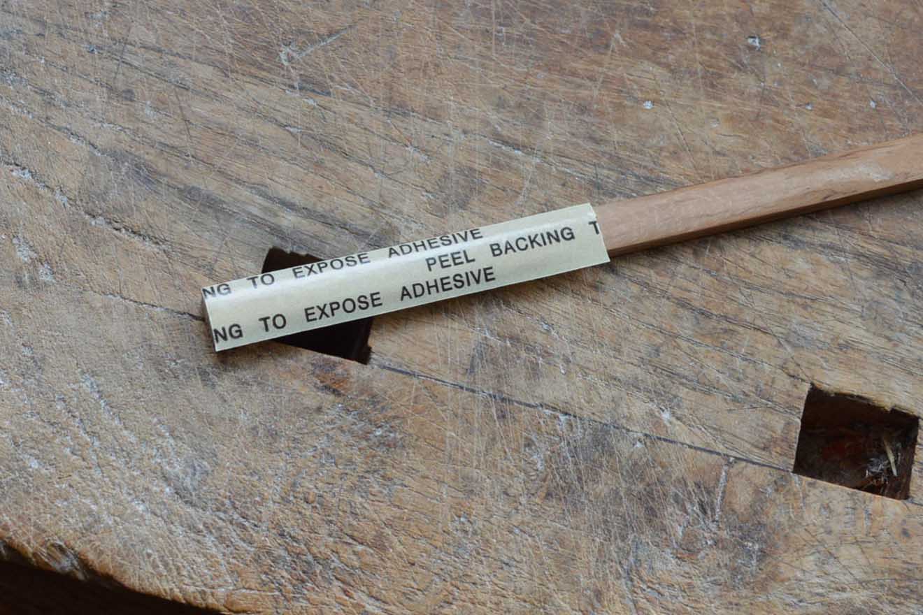

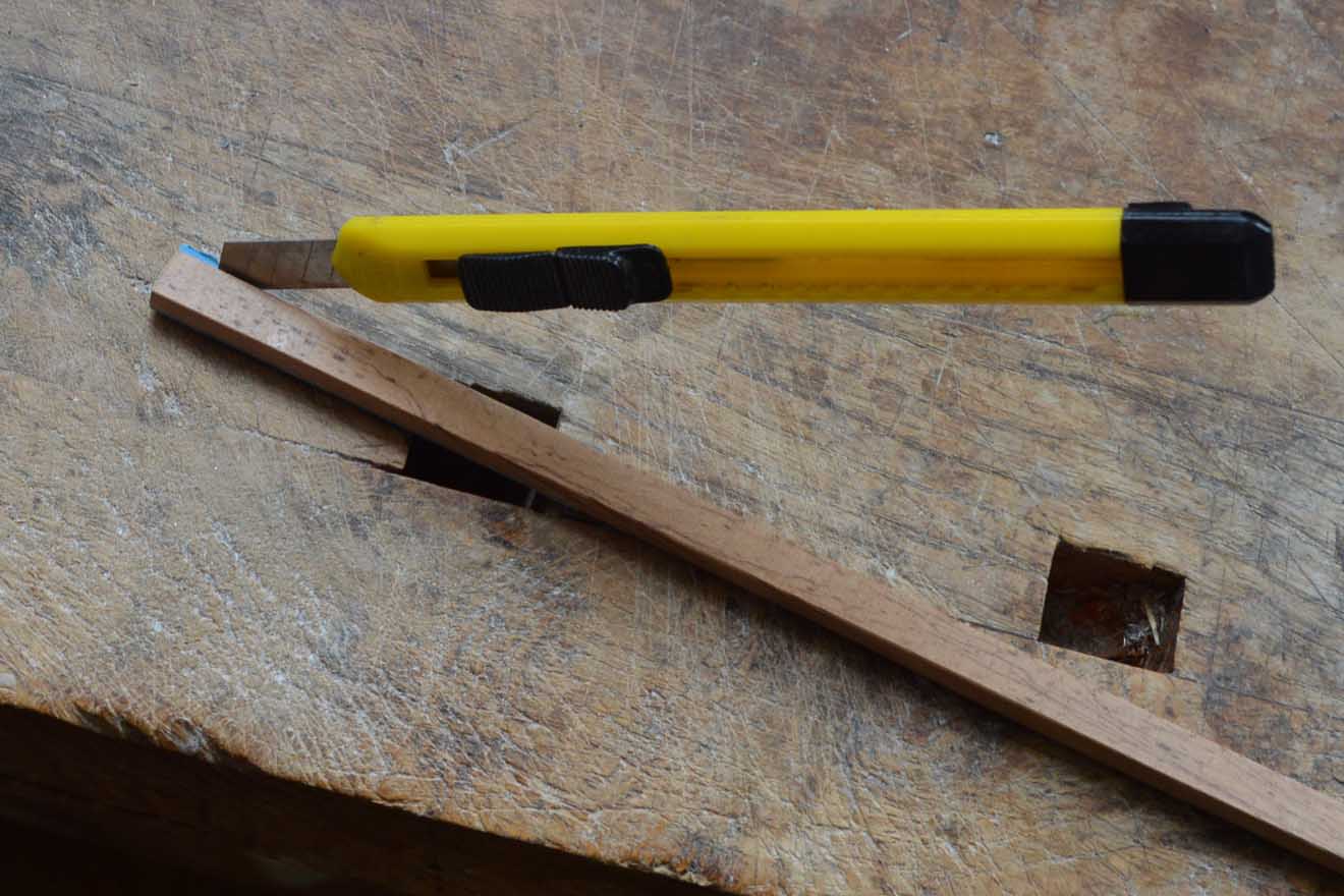

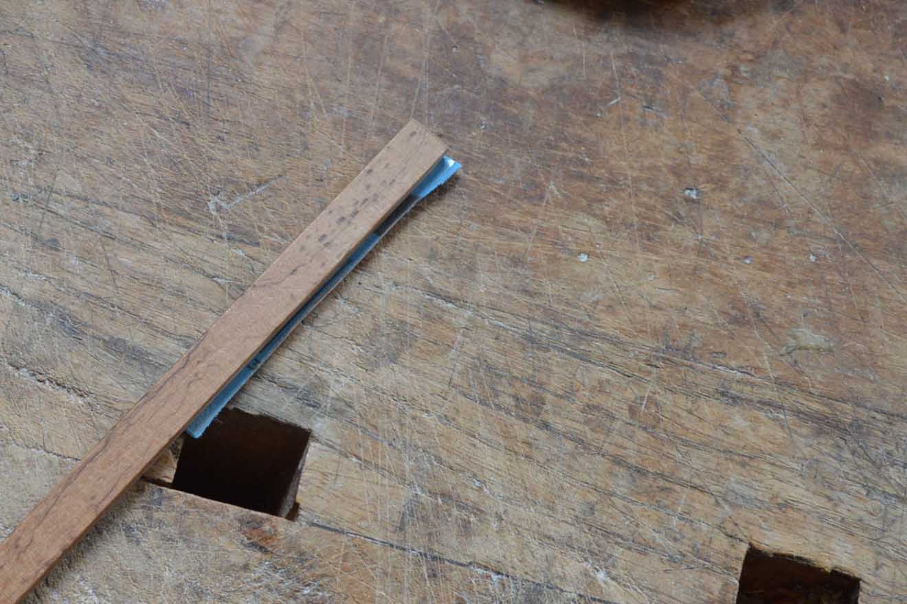

The "file" for the final shaping of the windway roof. The photos say it all, really.

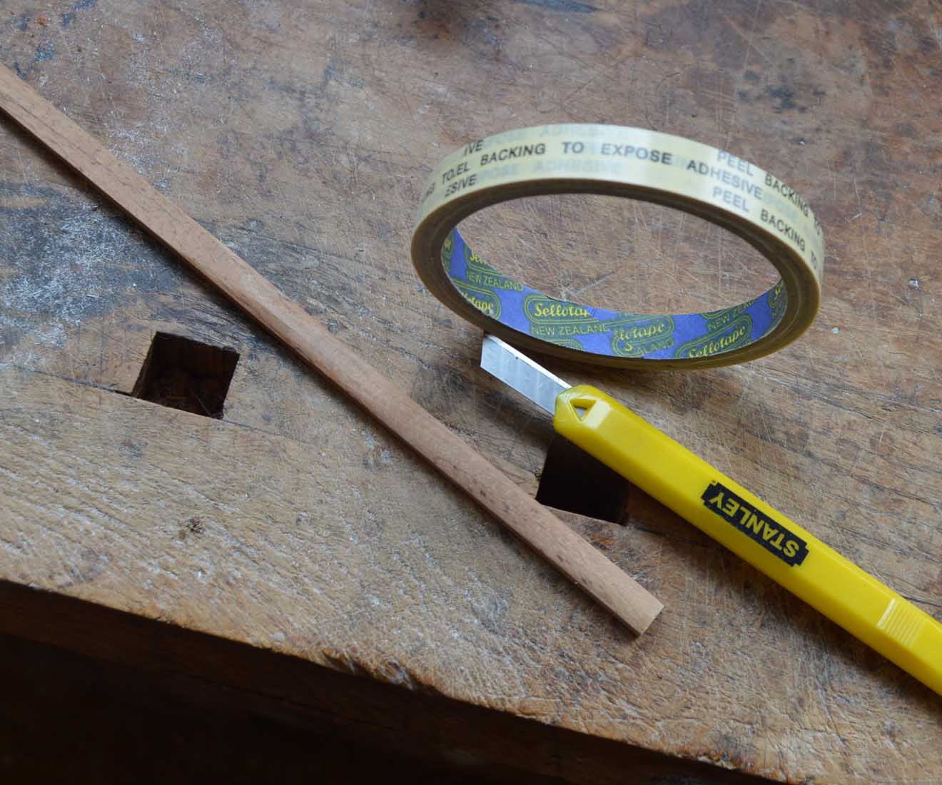

The tools to make the "file for shaping the windway roof. A shaped piece of hardwood, a double-sided tape, and snap-off craft knife. Oh, and sandpaper. I use P120 for the rough shaping, and finer for finishing.
The shape of the windway roof "file".
Double-sided tape in position.

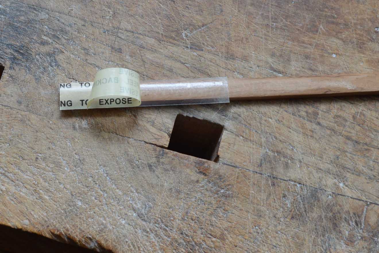

Just so you see how to peel off the backing strip.

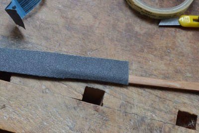

Sandpaper stuck on...

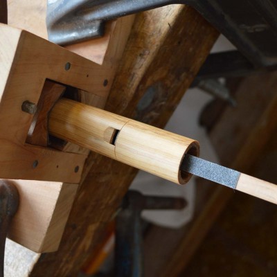

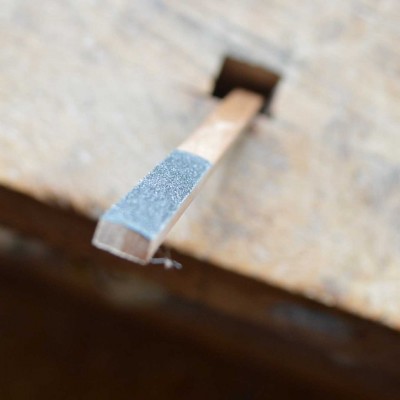

How to make a file.
In fact, I found this tool rather helpful in quite a bit more applications. You can make it to any profile, shape, size and roughness you like.
(The cork in the last photo is simply holding the file in place, that's all.)
Sandpaper cut off on the top and one side, still hanging out on the other.
The file ready to go.
The file in position for the windway roof.
Once again, the "file" is much deeper in for the underside of the labium.

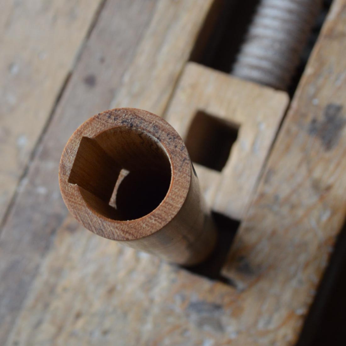

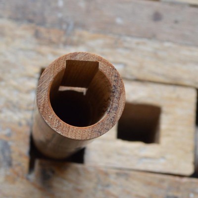

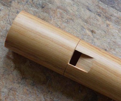

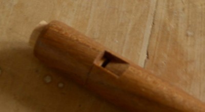

The finishing stage.

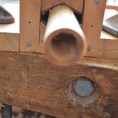

I forgot to mention, you cut the bottom of the labium after enlarging the cutup (the distance from the windway to the edge of the labium) to its final size.
Undersides of both windway and labium finished. What you see down the barrel looks very much like the finish, except the labium is a solid wall.
The tools to carve the top of the labium. You met them before. Good old files.
What you should see looking down the barrel. The bottom of the labium is some 0.7-0.8mm lower than the roof of the windway. Obviously, the smaller the instrument, the narrower the gap, the larger, the bigger.
General look.

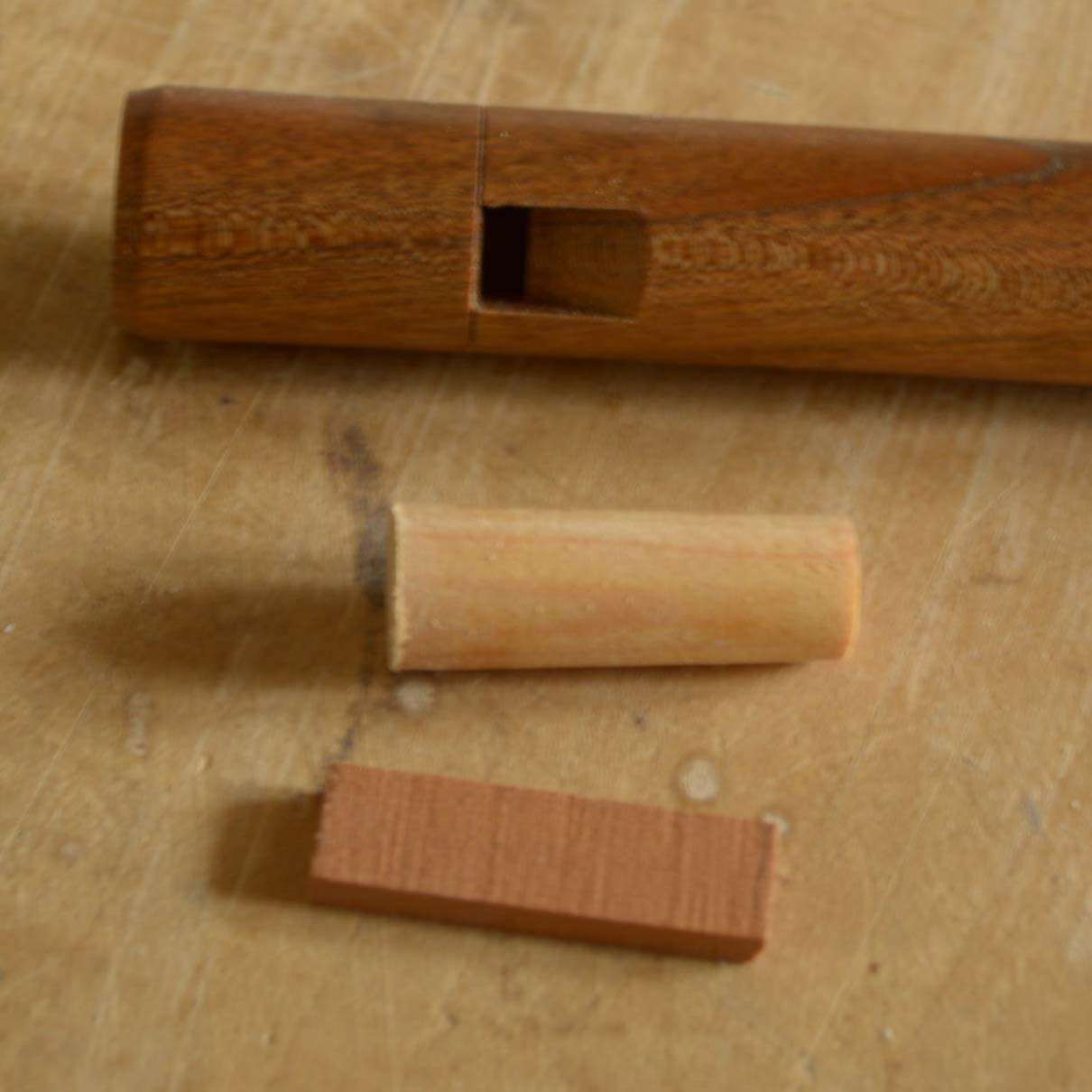

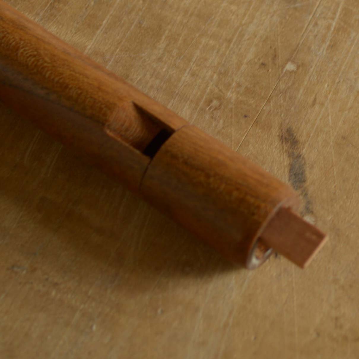

To finish it off. The block and some other thoughts.

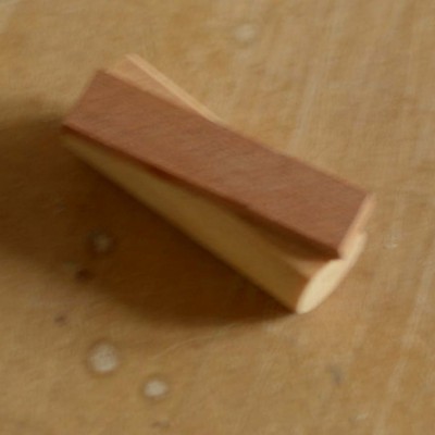

I make the part that takes the block slightly tapered. The block's body it turned on the lathe to fit snugly into the pipe's recess. No play allowed at all, the fit should be up to engineering standards.
The other part is the wooden slip that actually forms the floor of the windway. It is simply a thin slip of cedar, planed on all surfaces (I use a block plane, held in the hand and push the wood across the blade sticking upwards.) The width should be such that you can push it into the windway's passage, but not too heavily. Snug is the word.
The body of the block now has to have a surface planed into it, to take the slip. The surface, needless to say, needs to be an exact match to the slip.
The turned block pushed in position. Still way oversize.
The two components, the block itself, and the top slip, which will form the floor of the windway.
The top slip pushed in. It should fit snugly all the way.

The block planed to take the slip.
Block body and slip showing off.
Block body and the top slip glued up, and pushed into the body of the pipe.
