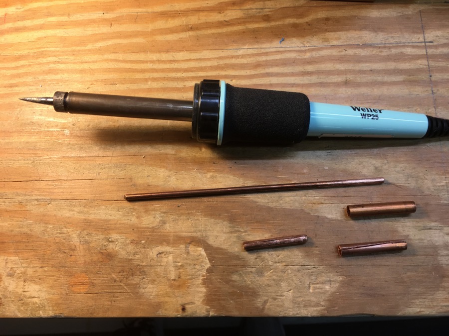

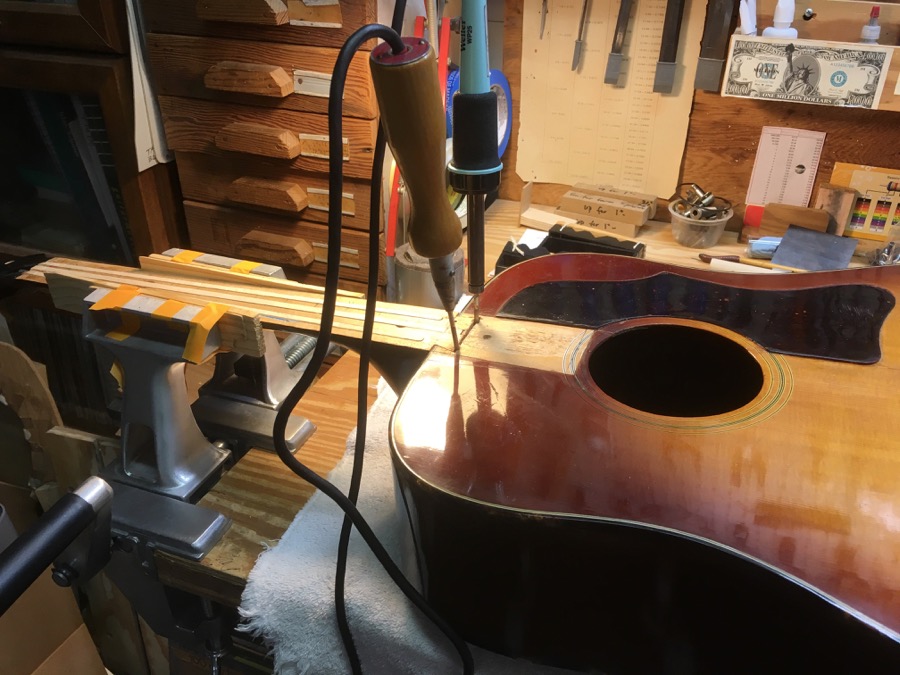

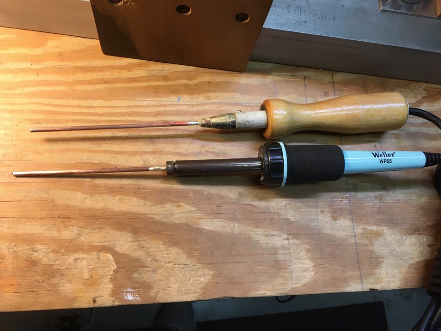

Back in the shop after being in Phoenix for 10 days. I let the neck rest and stabilize during this time which I believe is helpful. Next up is removing the neck. I am always looking for better ways to upgrade my tools and techniques. Our favorite tool supplier has a new tool for neck removal that is a copper stick that inserts into a soldering iron. The benefit is that steam is not used so finish damage should be minimized. The heat stick is fairly expensive and they did not offer a version for my Weller iron. I also feel that it should be necessary to have a heat stick on each side of the dovetail so I decided to make a couple of them, one for my Weller WP25 and a lacquer stick iron which is similar to a soldering iron. I bought a couple of pieces of 1/8" diameter copper rod and then made some fittings for the ends that fit into the irons. The fittings for the solder iron rod were three pieces of 1/4" copper water tubing. The two inner pieces were split, trimmed, and crimped around the rod and each other to achieve a good fit. The last piece of 1/4" pipe was left whole because it was the diameter needed to fit into the solder iron. The pieces of copper tubing fit together tightly.

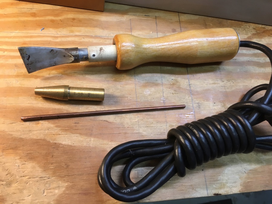

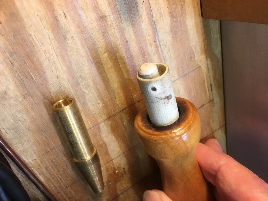

The rod for the lacquer stick iron required a brass fitting to be turned to size. All the parts for both heat sticks were silver soldered together and placed into the irons.

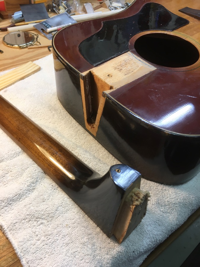

The heat sticks were inserted into slightly larger holes drilled at the end of the dovetail and plugged in. The neck was held in a vice in order to elevate the body above the workbench. As the dovetail joint heated up at several intervals I squirted a few drops of water into each hole as described in the Stew-Mac instructions. The slight amount of water was not enough to cause steam but it appeared to help soften the glue.
Posts: 2017
Re: Repair of 1968 Gibson J-45
Postby Barry Daniels » Tue Sep 25, 2018 7:18 pm
The elevated body allowed me to wiggle the body to get a feel for when the joint got loose. When everything felt soft and loose I applied a bit of side to side pressure to the guitar body and held it there for a few seconds. I could see the sides of the neck heel pull away slightly from the body and then the body lowered about 1/8" from the neck. I pulled the irons out and the body fell cleanly from the neck. My irons are not high wattage versions so it took 30 minutes to achieve removal, but it went well and there was no finish blushing.

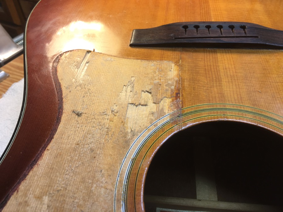

Postby Barry Daniels » Tue Sep 25, 2018 7:24 pm

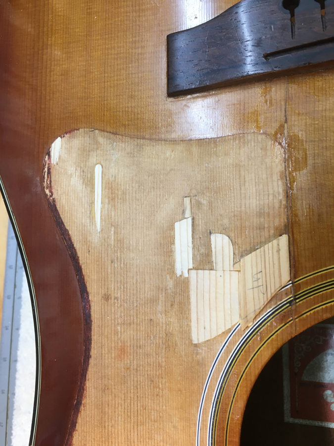

I also took off the shrunken pickguard with more heat and pallet knives. The pickguard had been taken off by someone in the past and there was some old tearout of the top. But the deep one on the left side of the picture was my doing.
This photo also shows the stain someone applied to the top that was exposed when the shrunken pickguard was reglued.

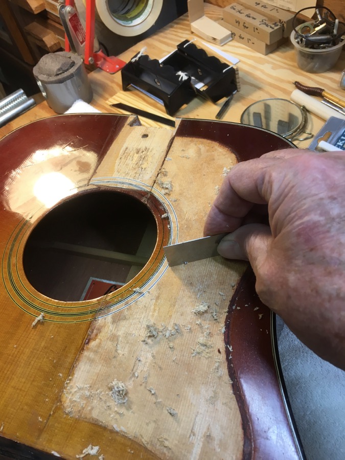

Took a small scraper to remove some of the glue left behind.

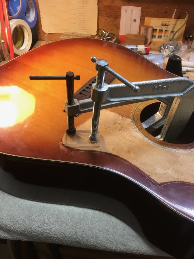

Postby Barry Daniels » Tue Sep 25, 2018 7:27 pm
I peeled the spruce tearout off the back of the pickguard and reglued it.
I will have to fit some spruce into the other tearouts to repair them. I plan on brushing some lacquer into the pickguard recess, making a new, slightly larger pickguard and using adhesive film to attach it.

It was the cleanest neck removal that I have ever done. Pretty happy with the homemade heat sticks. The only downside was they are soft copper so they bend easily, especially when hot. But they bend back straight easily too. I noticed that Stew-Macs heatsticks are hardened copper. But I am not quite sure how I could harden mine. You can't heat treat copper like you can steel. I have read that the only way to do that to copper is to work harden them.

Postby Barry Daniels » Wed Oct 03, 2018 12:04 pm
A little progress. Got the tearout under the pickguard patched.

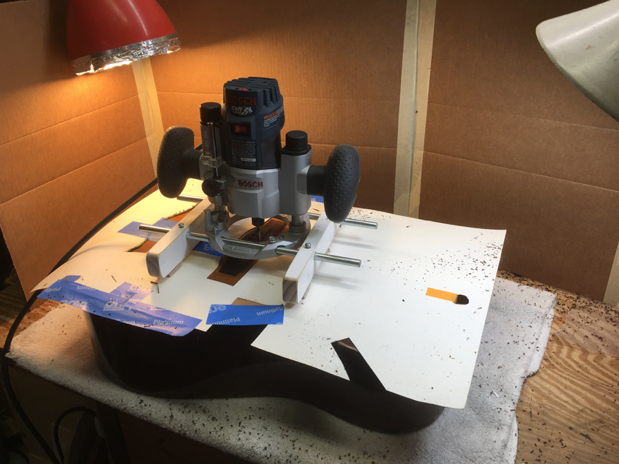

Postby Barry Daniels » Wed Oct 03, 2018 12:06 pm

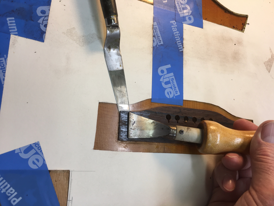

And I decided that the bridge would be easier to remove before I take the top off. Since the bridge is too thin and has poorly cut pin ramps and saddle slot that it was not worth saving. So I took a router to it to reduce it to veneer thickness.
Posts: 2017
Re: Repair of 1975 Gibson J-45
Postby Barry Daniels » Wed Oct 03, 2018 12:10 pm
The thin veneer was easily removed with heat and pallet knives. (Note: Having the bridge reduced to a veneer allows it to bend during removal so you don't have to apply near as much heat or prying pressure. Also the heat soaks down to the joint much quicker.)
