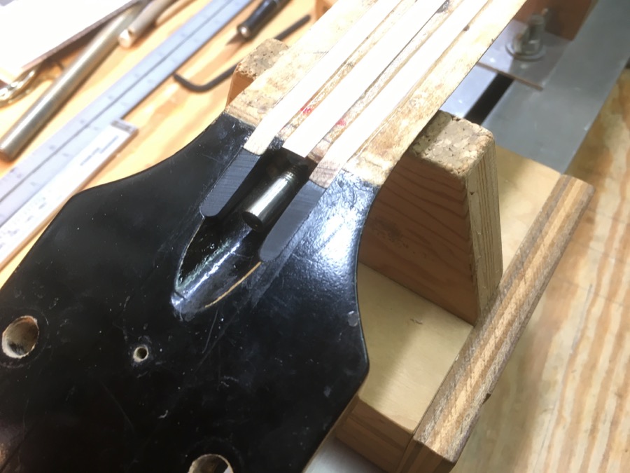

I also want to show a photo of how I ran the carbon fiber rods into the truss rod recess. I took them about as far as possible into the peghead in order to minimize future neck breaks (aka: Gibsonitis). The exposed ends of the rods will be covered by the truss rod cover when complete.
I am going to let the neck sit for a week or two to see if it wants to move. Then I will pull it and do the neck reset.

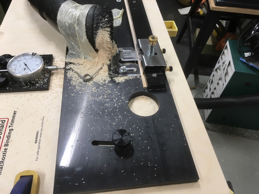

I recently got a MacRostie Binding Trimmer to use on this project when I get the binding replacement phase. I would previously size plastic binding by hand scraping and using feeler gauges to try to keep the thickness consistent. This was always fussy and time consuming and the results were never perfect. So out came the credit card and another tool added to the quiver. I used the trimmer to size those maple filler strips and it worked so well that I give the tool my highest recommendation. The device is basically a small router table with a precision controlled fence and spring loaded vertical and horizontal hold downs. I was able to quickly size the wood strips with a precision of nearly one thousandth of an inch. For the work I do this thing is a game changer.

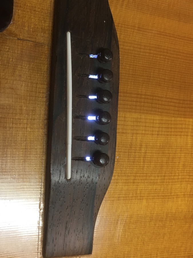

The strange thing is that someone did some really funky work on the bridge. Please look at the following pictures. There is an inset around the bridge pins that looks like black plastic and it is the size of the adjustable saddle monstrosity. And the photo of the bridge plate indicates that the bridge pins were moved and the old ones were plugged. It is a mess and I am not sure of the best direction. I can't remove the bridge plate due to the double-X brace butting up to all sides. I at least need to use a Stew-Mac bridge saver and try to restore the damage around the pins. I am also considering replacing the bridge. The existing bridge is really thin (.2" thick) and the saddle slot is poorly cut and too shallow.
Didn't most of these J-45's have reverse belly bridges? Could someone have taken the bridge off and turned it around which resulted in all these weird things? This is an area where I really need some advice from those more knowledgeable about Gibsons.
Your idea to pull and rebrace the top is intriguing but I am not sure my client is willing to go that far. But the bridge issue is still up in the air.

It could be that someone routed out the area around worn bridge pin holes to install that piece of black material. And that somehow necessitated moving the pin holes slightly. One other piece of evidence that indicates that the original bridge was belly down is the foot print on the top which shows no sign of a belly up orientation.

That is truly a mess under there! The bridge doesn't look like it ever had a different footprint, as far as I can see! but, the old adjustable bridges were sometimes made of plastic and they were bolted to the top with no glue, and so maybe that is what the original one was... when the new one went on there wasn't much finish marking from the old one.

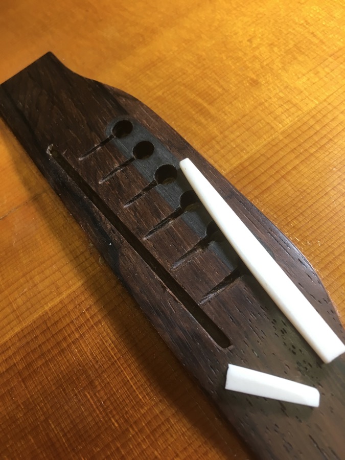

My client has approved pulling the top and re-bracing it. We will wipe the Norlin stink right off this thing. I will be really glad to get rid of that bridge plate. I will be replacing the bridge too. Someone in the past cut some humongous string ramps. Several of them look to be a 1/4" long. I tried to take a picture of that with a flashlight in the guitar. The bridge pins are in place so the light you are seeing is just the string ramps. Also, a couple of the ramps were cut off vertical by about 20 degrees. So I will also have to plug the top a bit even after removing the bridge and bridge plate.
Thank you Mark for steering me in the right direction on this.
Many years ago I replaced a couple of those plastic bridges on J-45's with a solid wood bridge and it made a HUGE difference in the tone and volume. I hope this one has a similar improvement.
This photo shows an impression in front of the bridge that could have been where the front of the plastic bridge sat. I hadn't thought of this possibility before but it makes a lot of sense.

Replacing the bridge is a necessity due to the inappropriate alterations in the past. The original is just not salvageable. But I will be using real brazilian rosewood and will be shaping it like an original except for one major thing. I will not be installing an adjustable saddle with all the metal parts. So in that regards the bridge will not be original, but I believe this alteration is an accepted approach that makes the guitar better for the player. So many vintage Gibsons have had this alteration that it is not an issue as far as I can tell.
