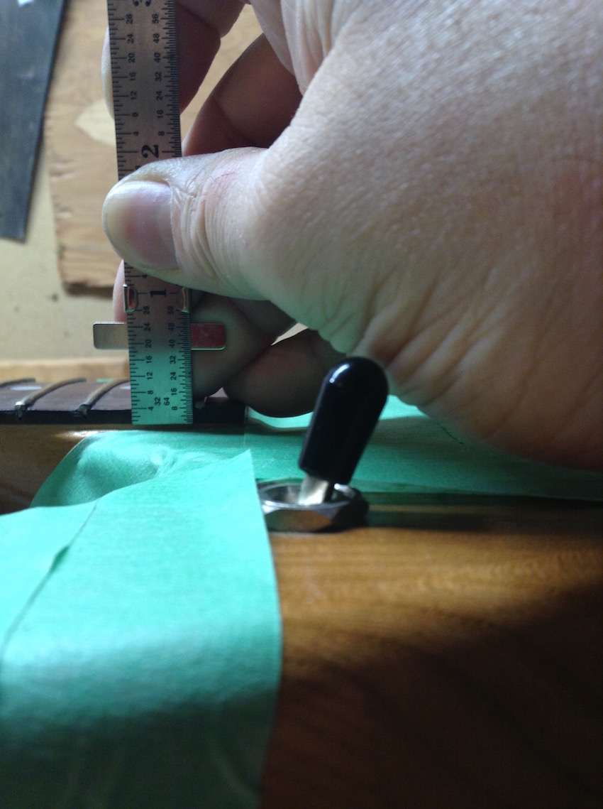

I just got an electric guitar with 2 problem. First, the neck was broken and fix but the FB came unglue around the 12 fret, That is giving a bump. On top of that, it look like the fret board was sanded, but not equally. The fret board is 3/16 at the nut and 1/8 at the 22 fret.
So impossible to properly give this guitar a descent action.

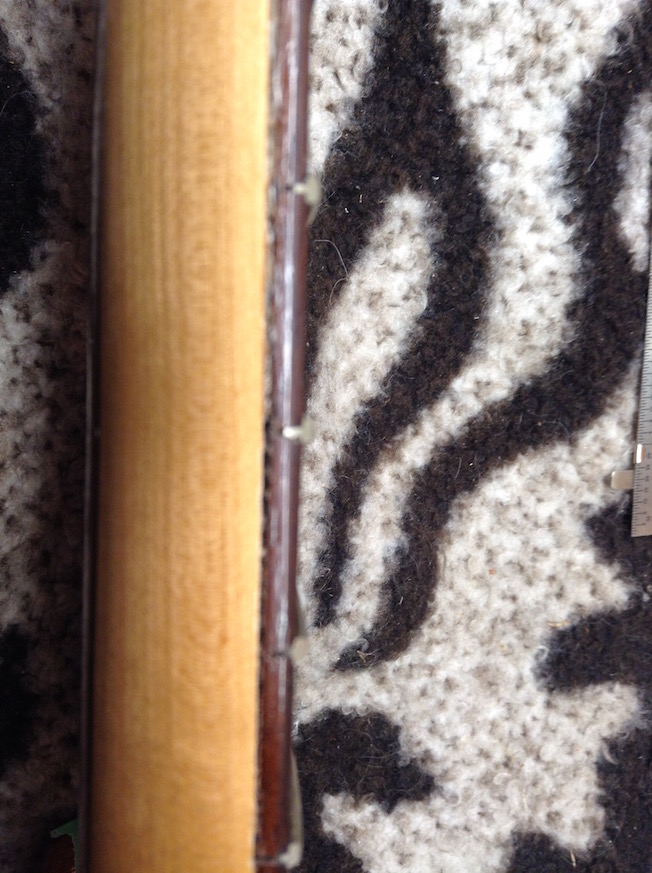

Postby Didier Savard » Thu Feb 15, 2018 6:09 pm
Here are 2 photo.
The thing is, the board radius is 15 at the nut and 12 at the 22 fret, it should be the otherway around, no?, so making the FB straight should be fine.

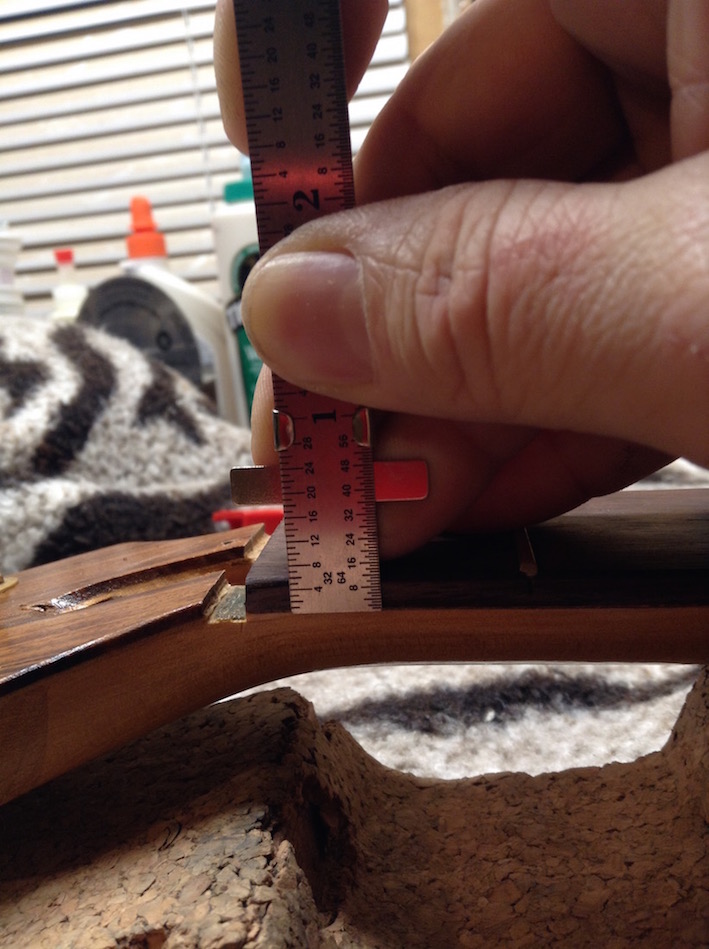

Postby Didier Savard » Thu Feb 15, 2018 6:13 pm
And here is the part that is unglue.

Postby Barry Daniels » Thu Feb 15, 2018 8:29 pm
Yep, that joint is a mess. The fretboard will need to be pulled off, both surfaces scraped clean and then reglued. You might be able to do this without removing the frets.
