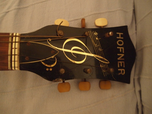

The headstock has at some time sustained a knock and there is a chip out of the plastic facing.

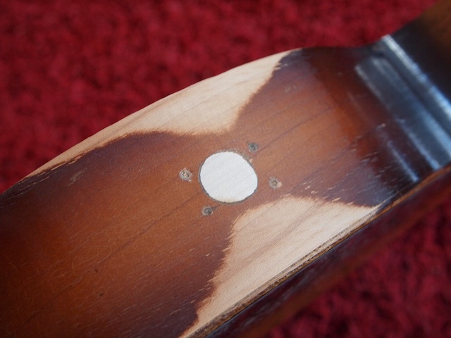

While there were no holes drilled in the soundboard for pots thankfully a makeshift jack plate was attached over a crudely 'drilled' hole on the side of the body. this has been filled and sanded flush.

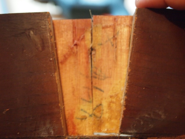

I removed the old binding and took off the soundboard with a razor saw in order to fix the issue with the braces and to fill the hole left from the pickup aperture (again, described with all it's trials and folly above). further to this i also packed the crack to the f-hole and put a very small spruce patch over the area which succeeded in closing the crack and reinstating the integrity of the top.
