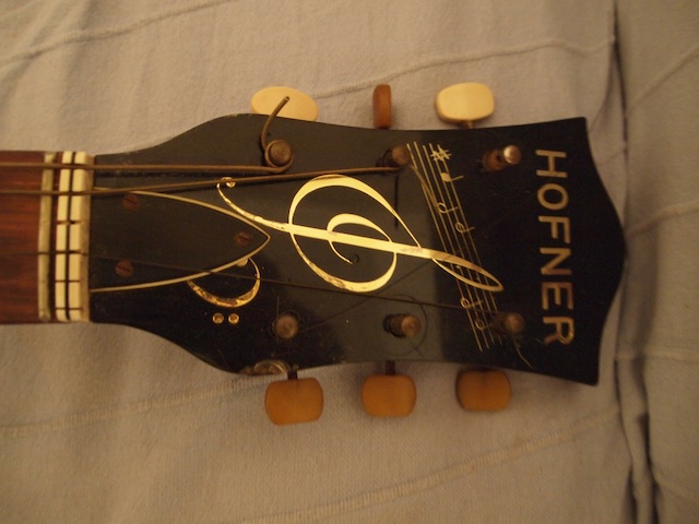

The headstock has at some time sustained a knock and there is a chip out of the plastic facing.

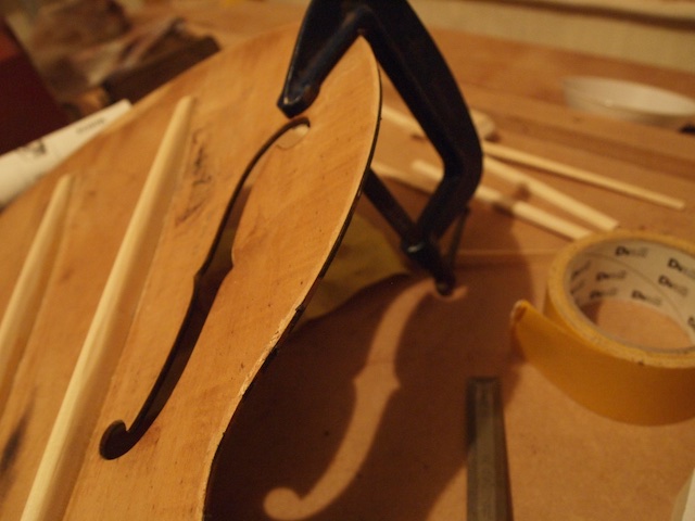

I removed the old binding and took off the soundboard with a razor saw in order to fix the issue with the braces and to fill the hole left from the pickup aperture (again, described with all it's trials and folly above). further to this i also packed the crack to the f-hole and put a very small spruce patch over the area which succeeded in closing the crack and reinstating the integrity of the top.

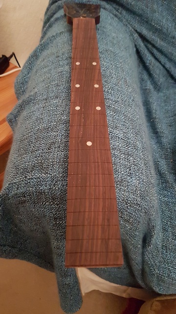

I applied apposing force and heat to the neck to correct the back bow in readiness to install binding and re-radius the fingerboard to 12 inches. I have also removed all of the frets.
Because I want the guitar to be more reminiscent of a n L-5 than it already was i had never been happy with the amount that the fingerboard encroaches on the soundboard as these Hofners have 22 frets and a large toe beyond the frets at the top of the fretboard. I have therefore, maybe controversially cut the length of the fingerboard back to 20 (maybe 21 i can't remember) frets and reshaped the underside of the neck/fretboard to accommodate. I just prefer it that way myself.

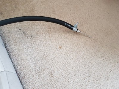

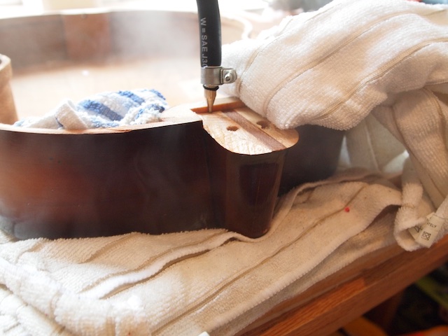

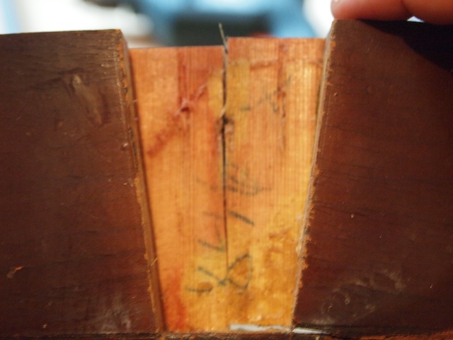

On to steaming the heel block out of the neck block. i bought a hand held steamer, some injector hose and a football pump needle and constructed a steaming device. it didn't exactly go swimmingly. the heel block finally popped out after some technical difficulties surrounding the connection between the hose and the needle which was finally resolved only to find that the neck block had a vertical crack and had come away from one half of the back upon removal. fiddlesticks.
so after waiting over a week for the wood to dry back out we are finally at today's juncture where the heel block is being glued back together and back down to the back of the body. luckily both halves of the neck block remained glued in place to the sides and the sides remained glued to the back so there was little alignment to be done only some... novel clamping solutions.
I am leaving the heel block to dry back for a little longer to ensure that any swelling has subsided before reattaching it to the rest of the neck.
