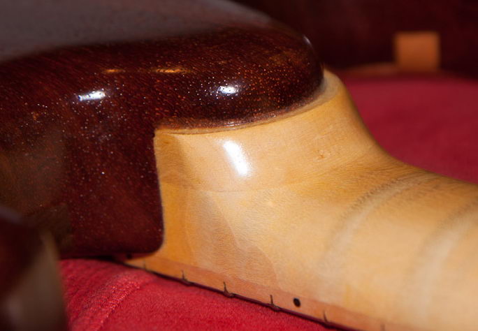

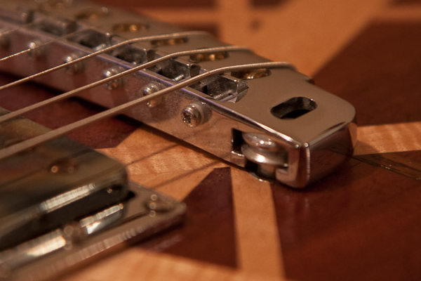

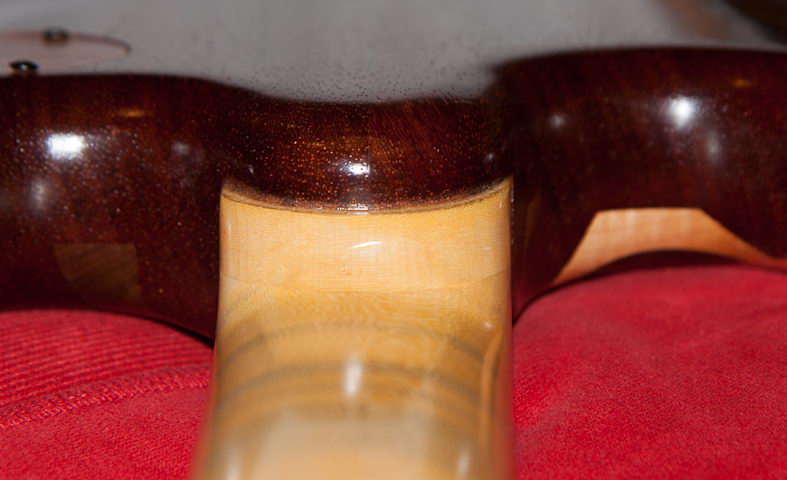

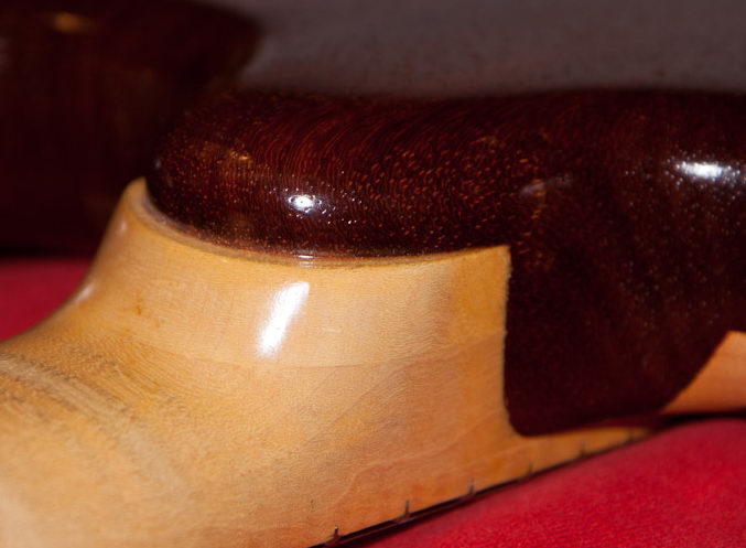

Joshua - Thanks for your comments regarding my guitar, and the info + link. The bridge is just a little too close to the neck to allow for spot-on intonation. If you have a look at the pictures below, hopefully it's clear that the saddle is at the extent of its rearward travel (both individual saddle on the low-E, and the grub-screw adjuster on the stud-fixing) and also that the bridge is as low as it can go currently.
The pictures below should also give an indication of the length of the tenon/pocket and the rough geometry of the tenon a full-width extension of the neck. The neck was certainly a fairly tight fit, and the part of the body that curves around to meet the neck is quite thin too. I have also included a photo of a plectrum (1.09mm) that was the closest thing to hand to gauge the string action around the 14th fret (strings sitting open). Fretted at the first fret and at the body join gives a little string buzz, so perhaps a bit more relief in the neck would be a benefit if I get it that far.
Remaining photos to follow.

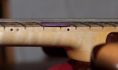

And another few photos of the finished neck plus some WIP shots :
Hopefully that should give you enough info, but if not I can take some more. Thanks for all the help so far.

There is no way you are getting the neck out without breaking off those ultra thin cheeks. Trust me on this.
If you need a bit more neck angle, the easiest way would be to pull the frets, plane down the nut end of the neck, and then re-fret.
And Matthew's advice about moving the posts back a bit a good approach. Easy fixes are the best especially when there is no risk.

Yeah, I have to agree with Barry. It would be much easier to move the bridge, than take the neck off.
To lower the bridge I would remove the bridge posts and bushings. Fill the holes with plugs, and re-drill them just a hair further back with a good brad point bit, if that is the direction you need to move it.
Before drilling the new holes for the bushings, drill out just the top of the hole with a bit the same size as the lip of the bushing. Drill just deep enough so that the lip of the bushing sits even with or just below the surface.
If that isn't enough downward movement, you can also file the saddles down to gain a bit more.
If your intonation isn't out too far, you could simply turn the saddle around, so the square edge is to the rear of the bridge.
This moves your break point to the rear, possibly being enough to set intonation properly.

Before removing your bridge, measure your action at the 12th fret, with a capo on the 1st fret.
If you have less than .050 to lower, you may be able to simply file the saddles down.
The only limits to that is the string clearance at the front edge of the bridge, and the saddle itself.
Once you get your action low enough, you can file the tops of the saddles down to match the groove depth.
Also, try and turn the saddle around so that you move the break point to the rear. This MAY be enough to intonate the guitar properly.
If that were to work, you have saved yourself a lot of work.
For removing the bridge post bushings I found a threaded rod with the same thread as the post.
First I heat the bushing, then thread the rod in, and use it to pull the bushing. A small wiggle usually does it.
You will have to plug the holes anyway, and you may have to drill the holes out bigger to do that depending on what size the hole is, and what size plug cutter you have.
Try not to drill a hole larger than the top lip of the bushing.
In the past I moved a T.O.M, bridge back 3/64 of an inch. The top lip of the bushing covered the repair almost completely.
