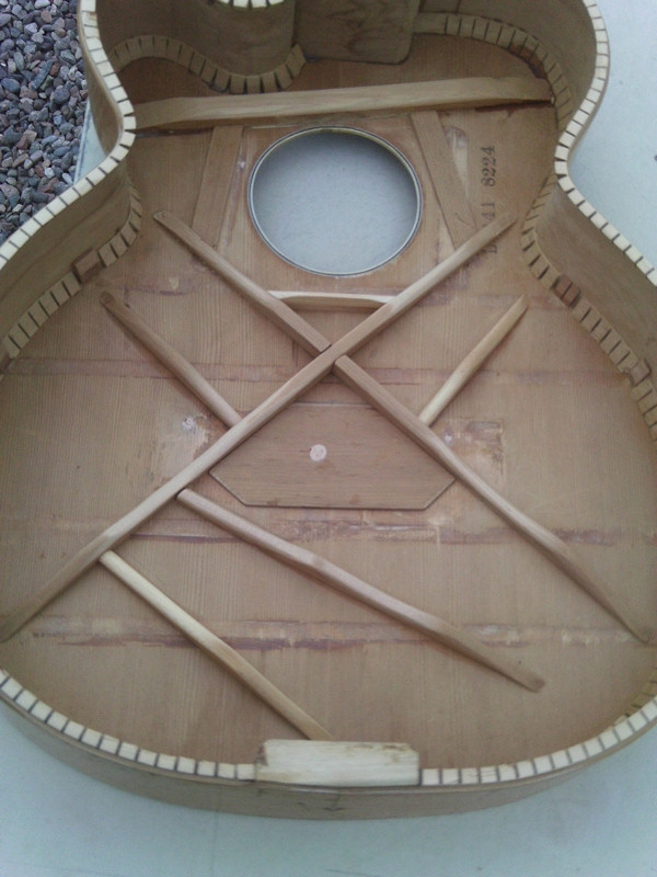

I'm preparing to create my x brace pattern but I have a dilemma.
The ladder braces are just a couple inches short of creating an x brace that I can tuck under the kerfing. (see pic)
I want them to intersect with the soundhole braces and I can tuck them under the kerfing there but they will be too short to reach the kerfing in the lower bout.
Can I get some opinions on this? Should I go ahead and glue them in short? I really want to use the old brace material rather than new wood.

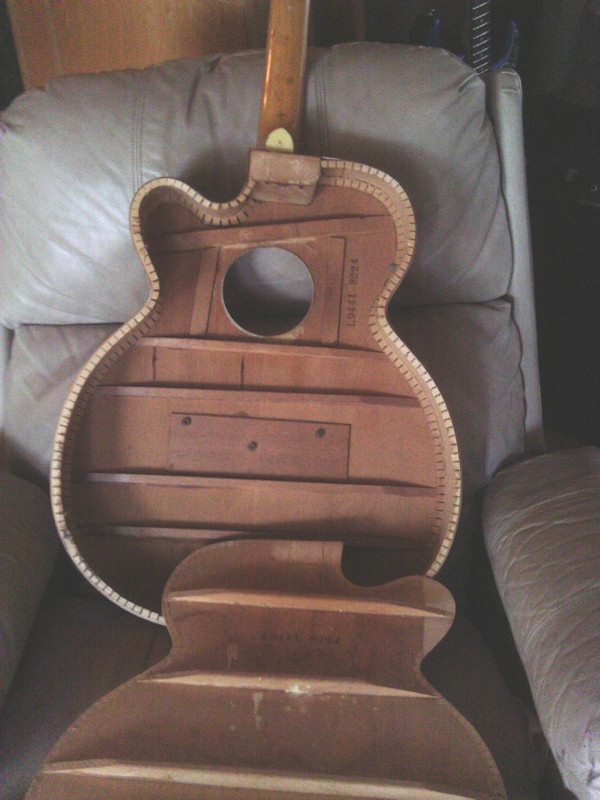

I've included a pic of the bracing before it was removed also.

Not tucking on the lower end of the X is standard practice for many.

+1Barry Daniels wrote:Not tucking on the lower end of the X is standard practice for many.
You're in good shape. I always used to tuck in the the X braces in the lower bout until I was corrected a little while back.

Thanks guys. I'm still building out of my Cumpiano book that I bought 15 years ago. I guess I'm just an old dog.

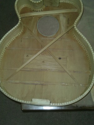

Braces are in. See pic.
Back and binding glued back on.
Bridge is built and glued on.
Waiting for glue to dry.

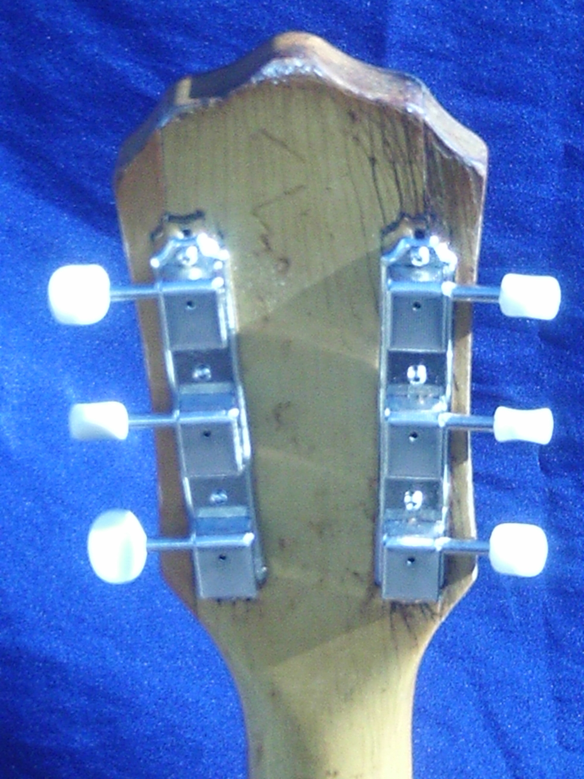

Can anyone tell me what this headplate veneer is made of? See pic.
Some kind of plastic maybe even bakelite but I don't know.
I'd like to clean and polish it but don't want to ruin it so I'm asking first.
I'm thinking some rubbing compound will do it.

Face of headstock might well be celluloid. If you scrape or sand it, if it smells like camphor it is celluloid.
