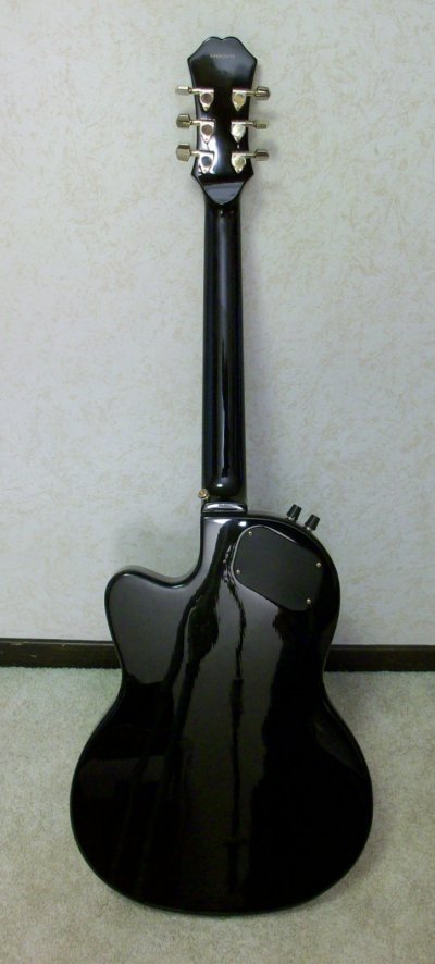

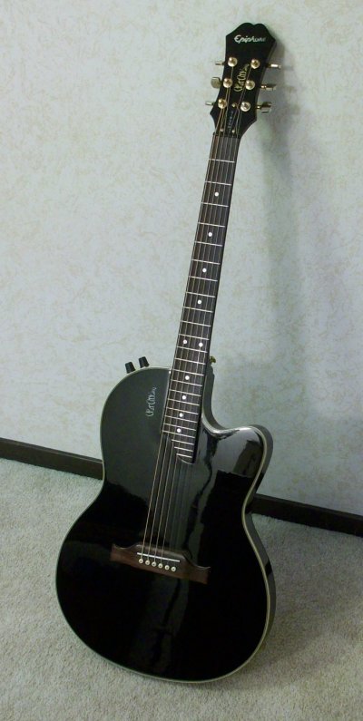

So this is one of those Chet Atkins SST semi-hollow guitars, right? Chambered body with a flat top, no soundhole, piezo in the bridge. What does the neck geometry - relief, set - look like? I can't find any pictures online of the internal chambering and construction, but I'm guessing the top is not bellying behind the bridge. If you do end up shaving the nut/bridge, watch out for the piezo element and reseat the nut correctly.

I believe that it is a Chet Atkins SST semi-hollow guitar. Pictures attached.
I can't see the chambering, but it is.
On the neck set: I should have known better, but I was so excited after I strung it up and the head didn't go flying off, I forgot to check it. After reading your post, I did. The truss rod was almost completely loose. The set, if I am using the term correctly --- the "concavity" of the neck in the middle was way too much! No wonder the action was so bad. I adjusted it to what I usually do --- don't have a number for it --- until it "looks right". The guitar is much easier to play now.
I am going to leave the bridge alone. I am sure my friend will be extremely happy with it. It is better than before it broke. I shined up the hardware, polished the frets. Cleaned and oiled the fret board.
