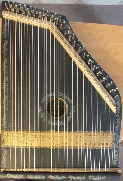

Postby Caley Hand » Thu Sep 13, 2018 5:59 pm
James, I used bronze wrapped strings on my Zither refurbishment. I had the same problem with those strings being too fat. The only solution to using the same pins is to remove the wrappings from the core music wire.
What I did was pull each string taut to measure how long it needed to be. I then cut it to length. After that, I again pulled the string taut, and then measured how far past the bridge I wished the wound string to remain wound. I then used my various pliers and wire cutters to get the windings loose, then just pulled the windings off to the point I had just measured. Things turned out OK for someone who has never touched a musical instrument until the Zither came into my hands. I've attached a picture of the old Zither with new strings. CaleyAnn

Postby James Thomas » Sat Sep 15, 2018 9:13 am
Caley Hand wrote:James, I used bronze wrapped strings on my Zither refurbishment. I had the same problem with those strings being too fat. The only solution to using the same pins is to remove the wrappings from the core music wire.
Thanks, I hadn't thought of trying that
