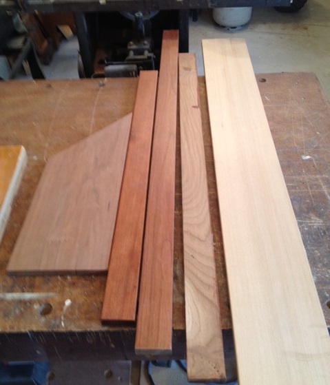

Back, sides and neck are cherry, scraps from a friends cabinet shop
Top is hemlock, I found a nice quarter sawn board at the local big box store.
Fretboard is rosewood, pre slotted from Stew Mac along with the hardware.
Fretboard position markers are maple
Bracing is some kind of pine

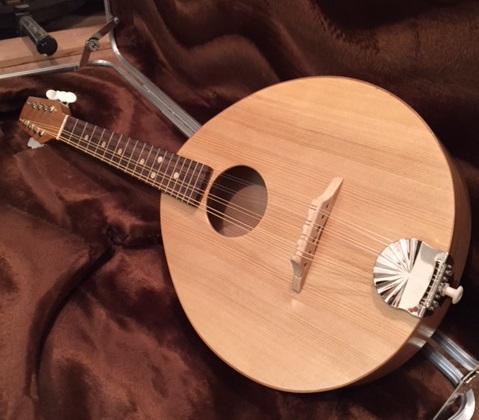

Postby Brent Bischoff » Fri Apr 22, 2016 8:25 pm
here is a picture, will try to get more loaded later.
Brent

Postby Brent Bischoff » Fri Apr 22, 2016 8:27 pm
one more. I apologize for the quality of the pictures, they are off of my phone.

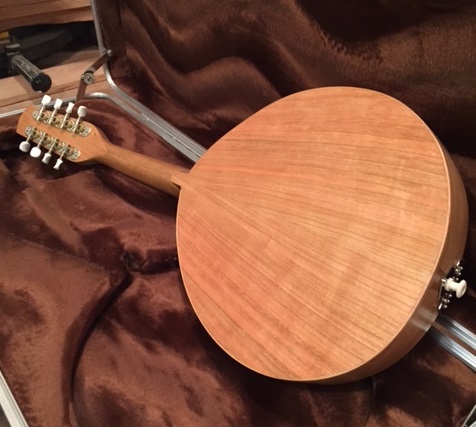

Postby Mike Conner » Sat Apr 23, 2016 7:03 am
Nice. I like the way you joined the back grain pattern.

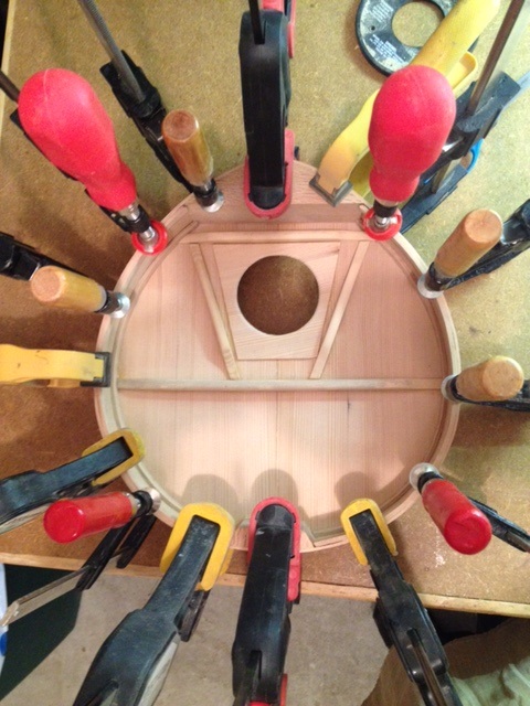

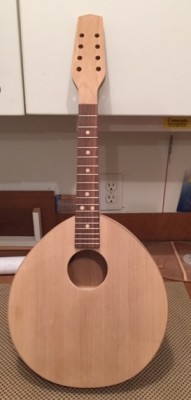

This is what I started with
Top braced, glued and clamped to the rim

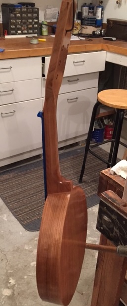

Carving the neck

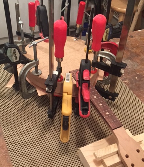

Gluing the back on
Brent Bischoff

Postby Brent Bischoff » Mon Apr 25, 2016 7:40 pm

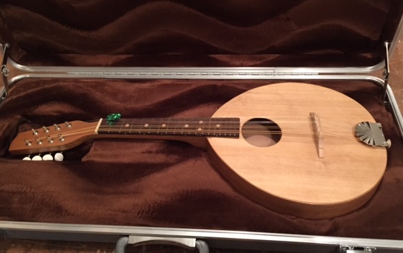

Ready for finish
During finishing
And one more of it finished.
