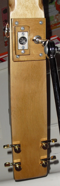

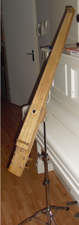

A couple of weeks ago, I had a couple days with some sparetime. I thought it would be fun to make a simple stick (double) bass.
Although the instrument is rather simple, the sound is great.
I've used two pieces of birch plywood which I glued together after routing a trussrod slot and installing a martin-style trussrod (although the trussrod is not needed, but that is hindsight).
The taper I saw with an electric scrollsaw and cleaned it up with the router and a fence.
The stringlength is 800mm (little less then 32"), and I choose this stringlength to match the strings I had lying around (0.145 - 0.090 - 0.055 - 0.032).
The bass is tuned in fifths starting with a low C.

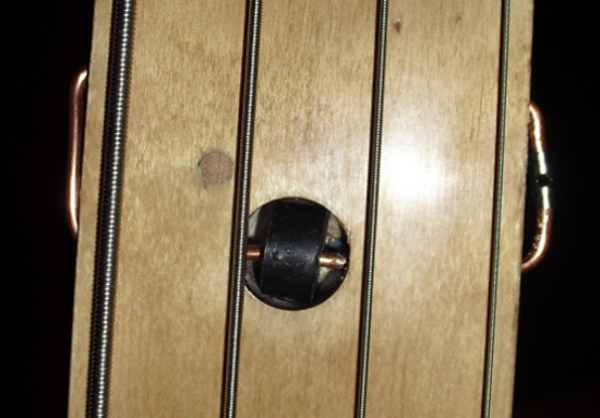

The pickup is made of a piece of electric wire connected to a 1:500 current transformer and some ceramic magnets, this yields a signal which is comparable with a microphone signal. With a mic to line adapter it can be connected to a regular bassamp. I just feed it straight into my usb soundcard.
It has a flat fingerboard, because I don't intend to bow it (I used roundwound bass strings) and for the sake of simplicity.
I've stained the wood with strong coffee and finished it with a hard floor finish from Glitsa.
I've used an old cymbalstand to mount the bass.
Simple stick (double) bass tuned in fifths

Cool...! Explain the pickup further?

The pickup is a so called low impedance single loop pick up.
It works pretty much the same as a regular pickup: When the strings are plucked, a voltage is generated in the coil around the magnets.
Where a regular pickup will have a coil with a couple of thousands of windings, this pickup has a coil of only one winding (the electric wire).
The voltage that is generated is really smal (that's the reason why a regular pickup has more windings, to get a higher voltage), but this can be transformed to a higher voltage with a transformer.
The alumitone pickups from Lace are based on this design.
There are two things I really like about this design:
- It picks up low and high frequenties evenly, so it can be used for instruments with an extended range
- A pickup is very easy to make. A prototype can be assembled in 15 min.
I've used this type of pickup for a studiorecording and it worked out fine.
Downside is that the signal is at microphone level, so you either need a microphone preamp or a mic to line level adapter (about 25 dollars).
I generally connect my instruments to a usb soundcard with a micpreamp and use my laptop as a effectprocessor and this works works great, but I've plugged them in a regular guitar amp as well and this worked fine although I had to adjust the eq a little bit.
Hope this explains it a little bit.
There is a thread on the MEF explaining this design: http://music-electronics-forum.com/t5447-4/#post315021

But like with any other low impedance pickup design You will lose the bandwidth advantage if You use a transformer, don't You?The voltage that is generated is really small (that's the reason why a regular pickup has more windings, to get a higher voltage), but this can be transformed to a higher voltage with a transformer.

You are right, but you still have a lot less windings then a conventional pickup. I haven't made a frequency response curve (and don't know how to do so), but that would give some good data to evaluate the pickup.But like with any other low impedance pickup design You will lose the bandwidth advantage if You use a transformer, don't You?
