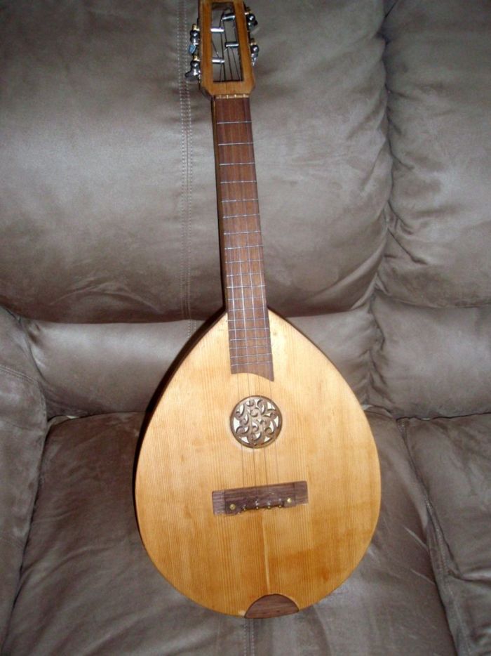

Greetings people!
Here is a picture of an instrument I just finished. Its a flat back lute with a Ukulele Scale! Came out nice and sounds good.
http://sphotos.xx.fbcdn.net/hphotos-snc ... 7418_n.jpg
I used popular, red cedar, and black walnut.

Terry, looks very nice. What scale ukulele? Tenor? BTW, it would be good if you uploaded the photo here.

It would be an Concert Ukulele scale.
