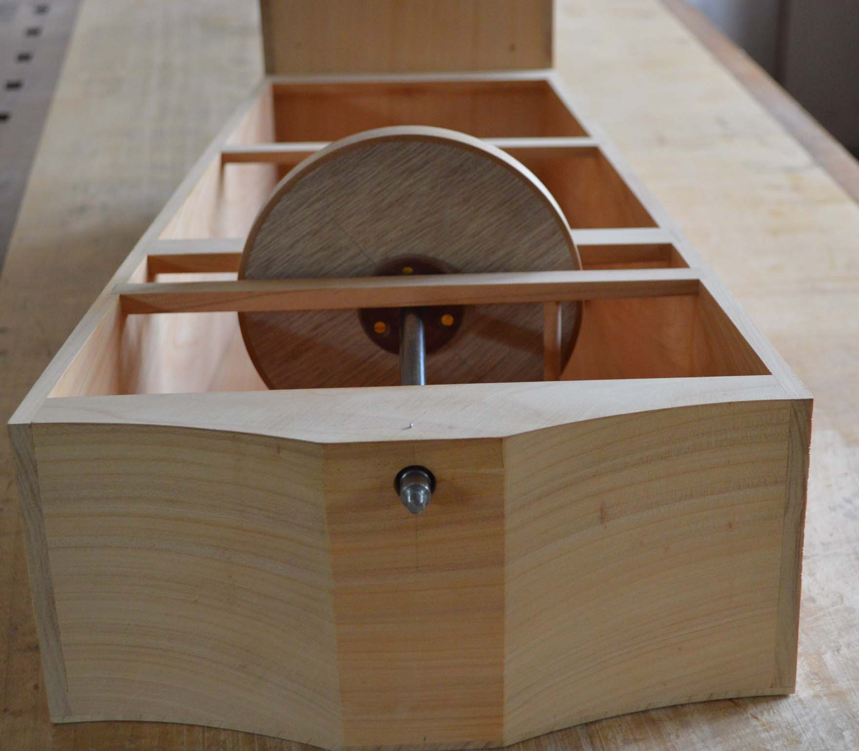

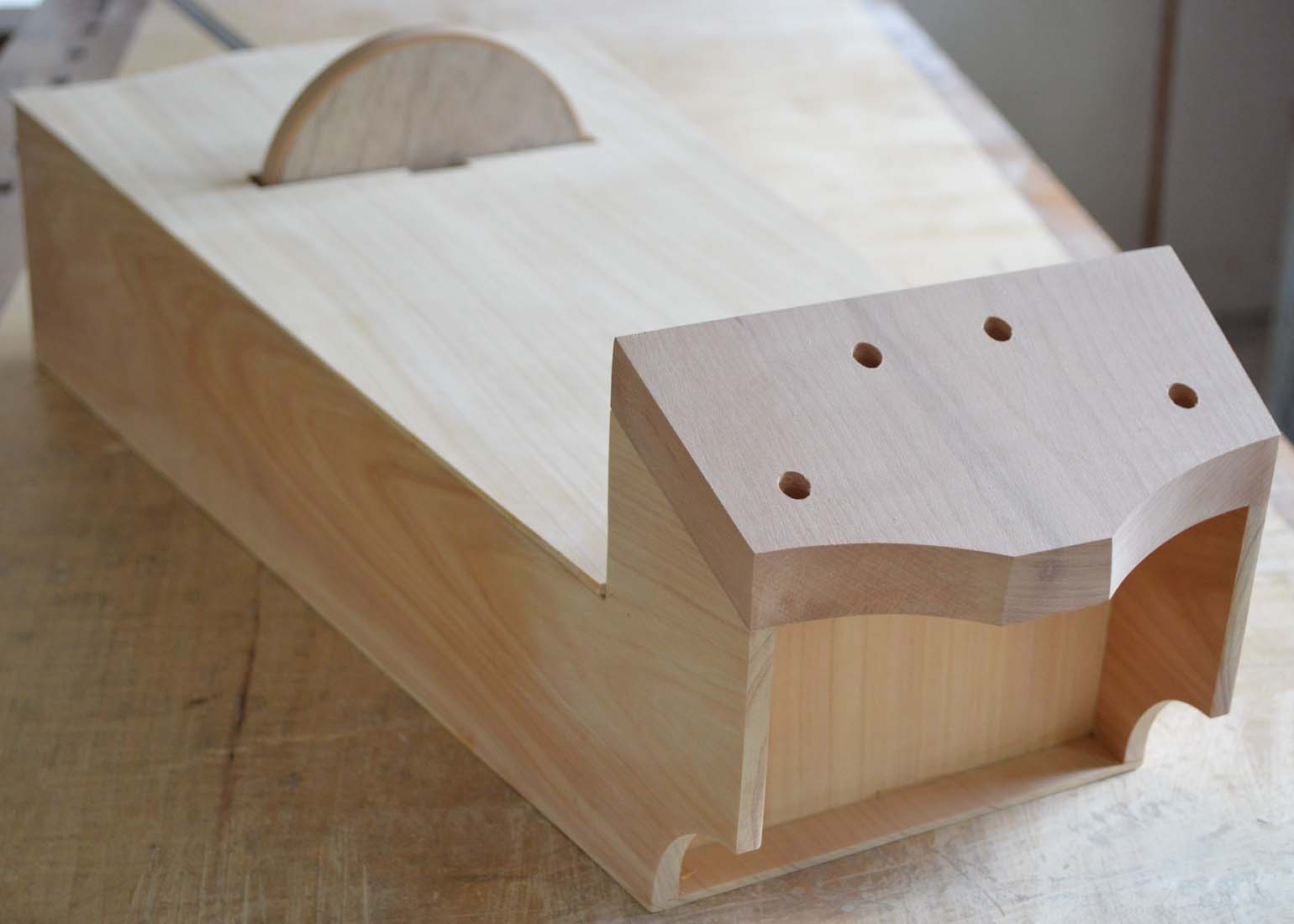

The wheel turned thinner, to about 15mm. The final truing up will take place when everything is finally assembled, both the circumference and the sides. (hopefully these only will need very slight touching up.) The pear strip is in place. I actually cut it some 3-3.5mm thick after all. It bends like a dream.
The wheel in position, with the shaft obviously far too long on the other side at this stage. And none of the screws are employed yet, not even the holes drilled. The whole thing is a very tight fit, but pushable by finger pressure.

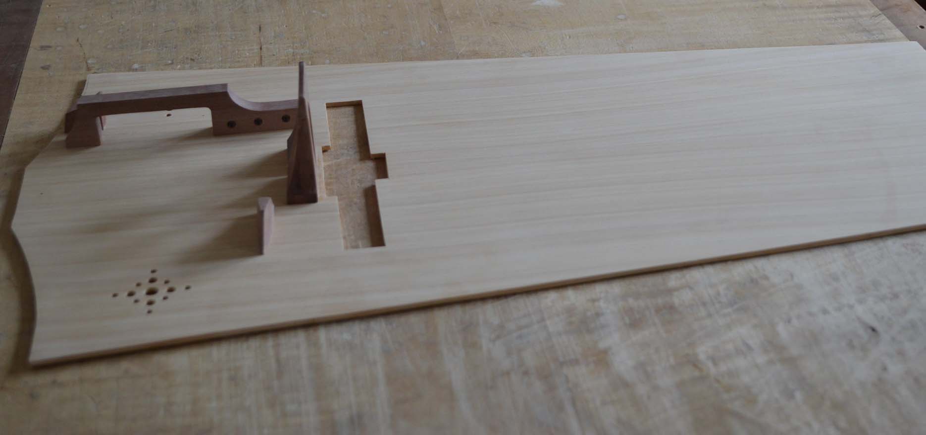

And finally, the soundboard with the slot for the wheel cut out. The shape is a bit unusual, as the slight cutout at the back is normally not present. I did it simply because the unit joining the wheel and the shaft is made of wood, and hence quite a bit thicker than it would need to be if made from brass. So it needs that extra space if you want to be able to take the wheel out for repairs.
And obviously, the headstock or whatever you call it, is in place. Made from Red Beach, a native NZ timber. Macrocarpa would simply bee a bit too soft for a headstock, though maybe it could work. I just feel it would wear under the pressure from the pegs too fast. Red Beach is a kind of medium hard timber, comparable to walnut and similar.

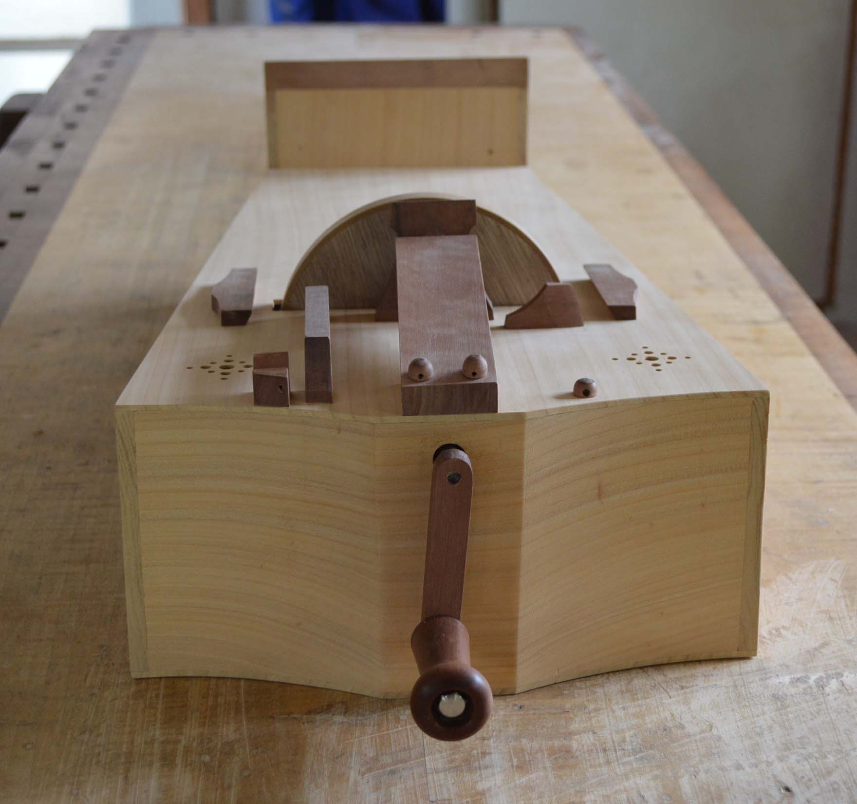

Well, the wheel is trimmed, all screws in place, the end cut off and threaded for the handle. And that groove, dunno what is the technical name, cut into the shaft. The one that will have a thin steel plate riding in it, to stop any longitudinal movement of the shaft.
The soundboard with some of the bridges. The trompette will be of the Hungarian kind, you will see how it all works at the end. I glued these on before the soundboard goes onto the body as an experiment. I don't much like the pressure on the back when things are glued onto the soundboard afterwards. But I still need to glue on a couple of things, though these probably don't require as much pressure.
It is drying right now.
The soundholes, well, I thought there still should be some a bit more interesting than just a round hole. That's a bit boring. Hence the fancy design, that is still extremely easy to make, thereby keeping the price down.

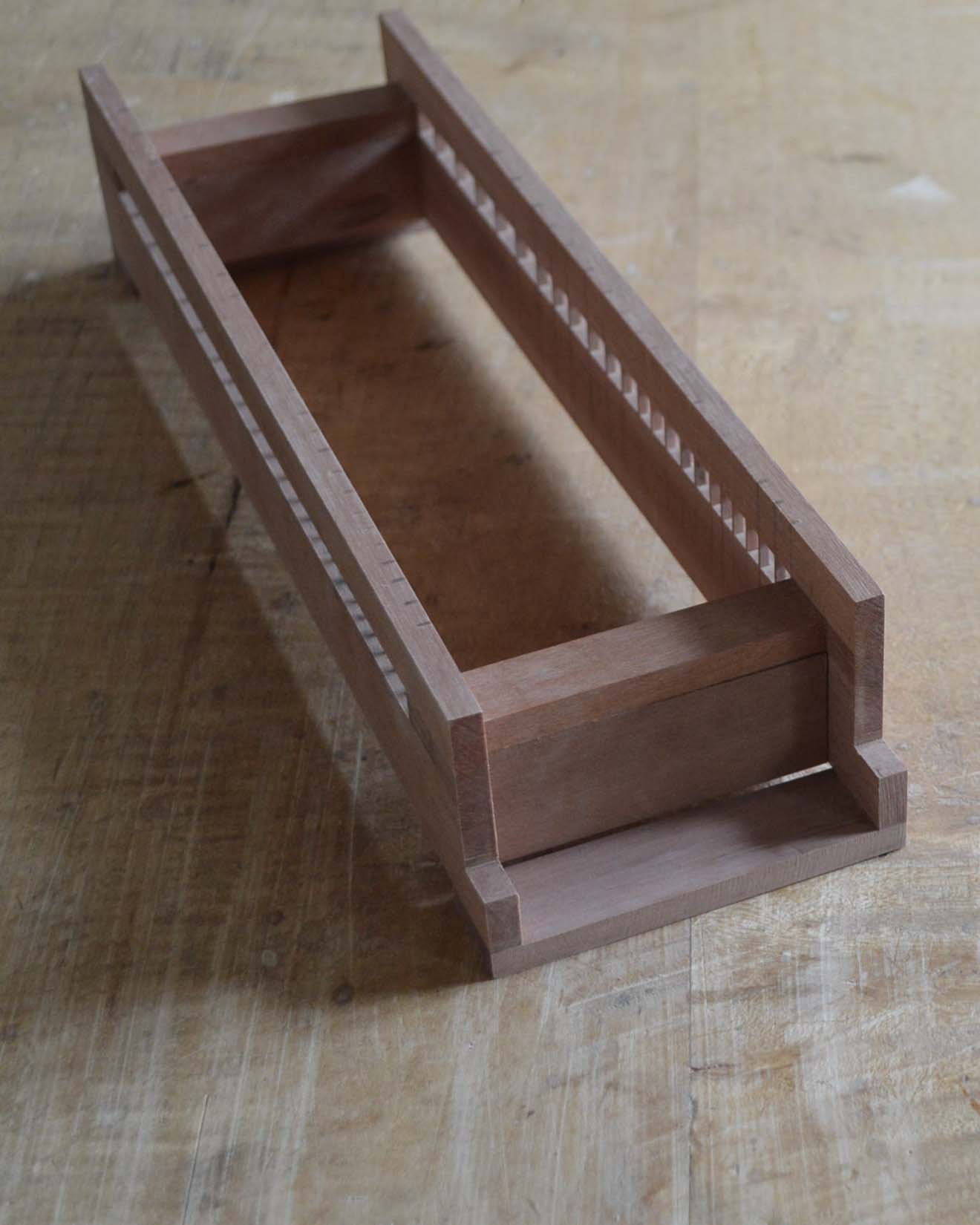

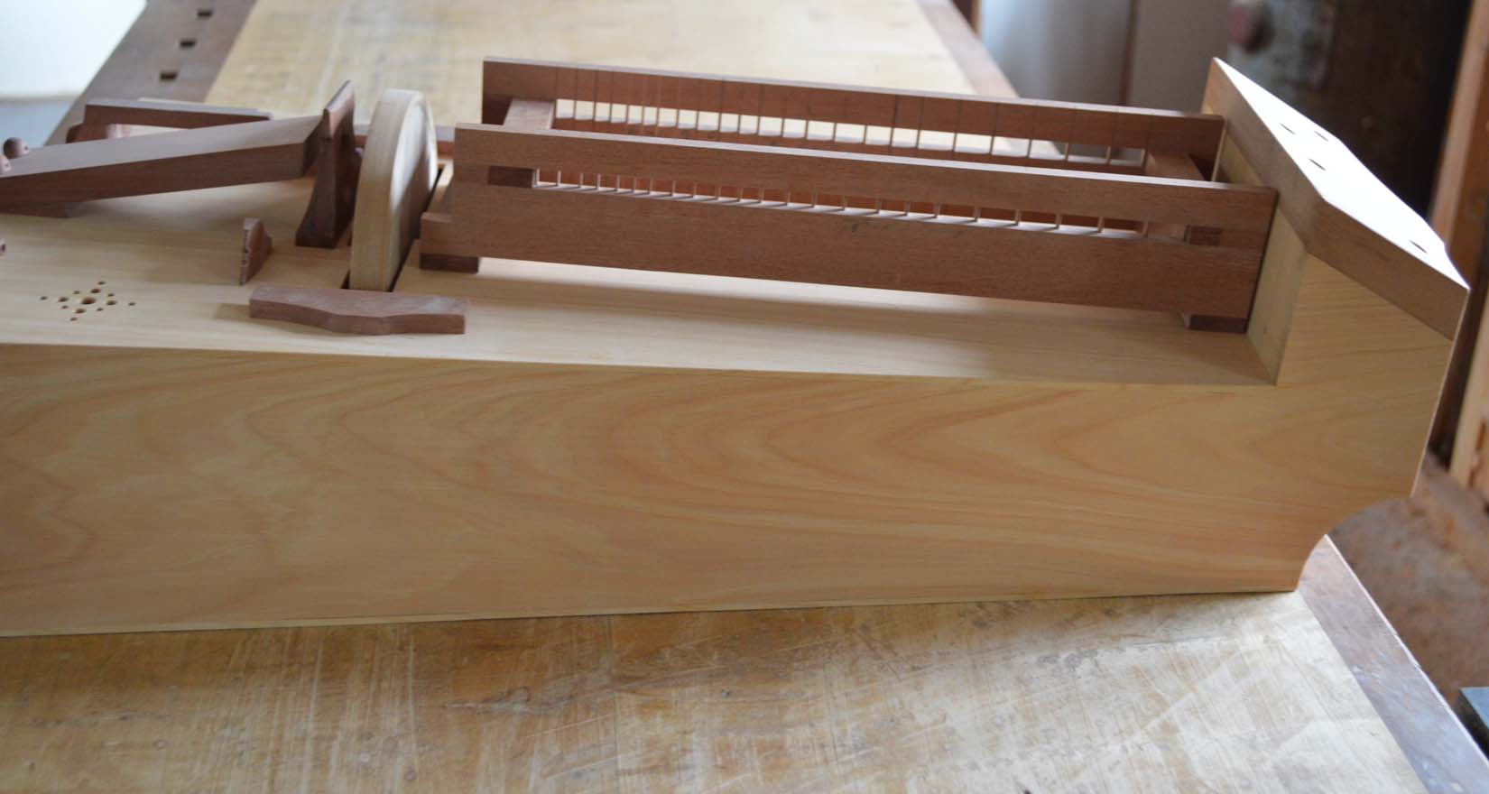

The keybox itself minus the lid is done. The corner joinery has been kept to as simple as possible, while making sure it will not fall apart. And also being quite precise.
I think the photos explain it by themselves. If there are any questions, out with them!
The last photo is the general view of the instrument with the keybox in position, but not secured. (It will be bolted down eventually)

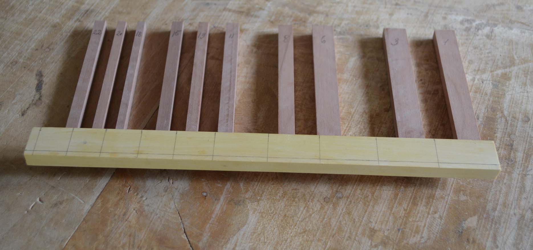

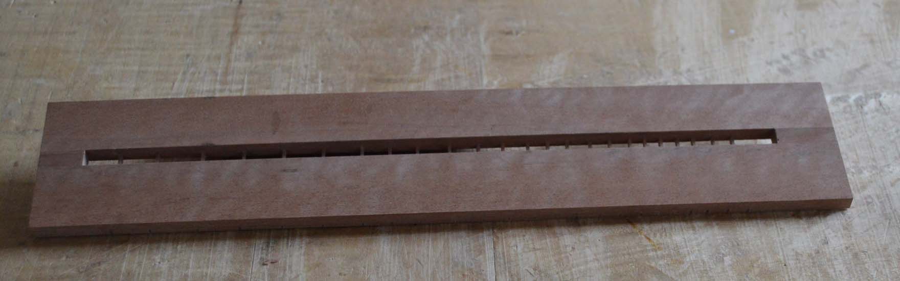

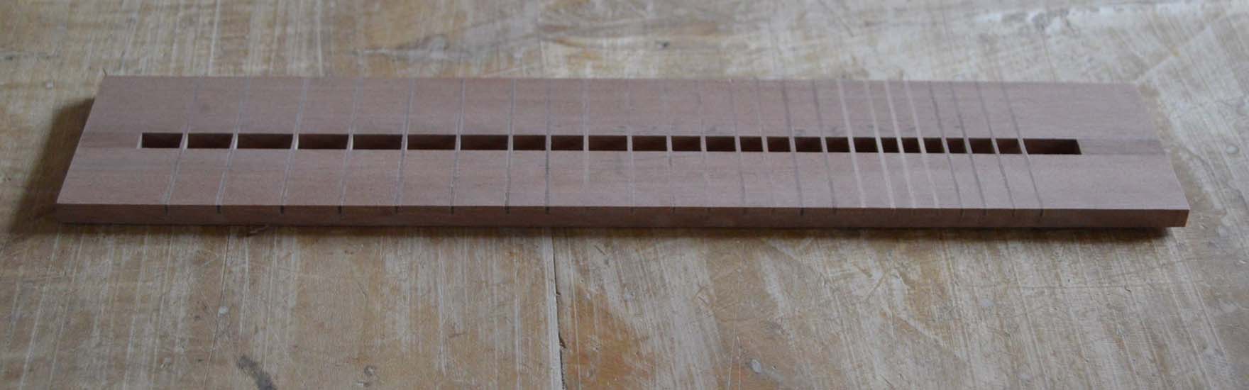

The keybox is starting to aquire some tenants...
The keyshafts cut o7ut and fitted. I have to say that using this method I achieved considerably more precision than the traditional, morticing way.

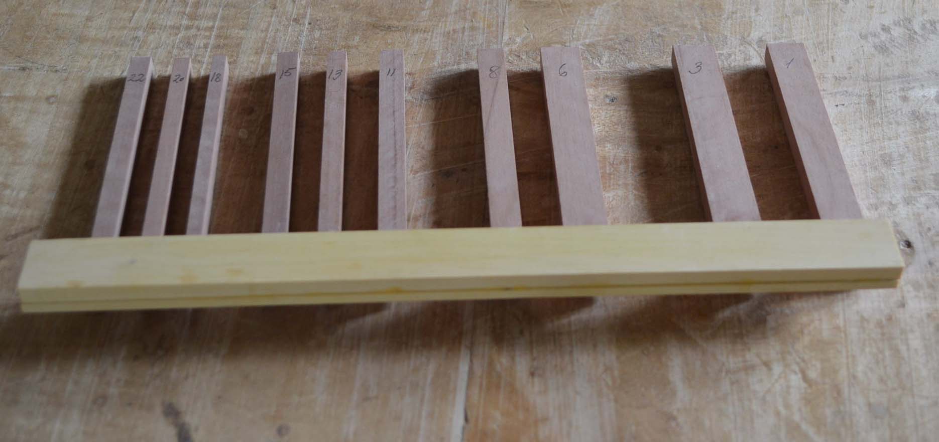

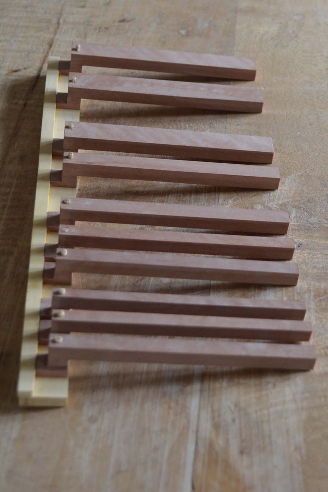

The keys with the added bits; to lift the level of the keypads in the case of the semitone keys, and to add a bit more of a gluing surface in the case of a few really thin diatonic keys
Same with two of the keys shown from underneath.
The semitone keys receiving the top part of the touchplates. The reason for doing thm all at once is simply to make the whole thing perfectly aligned the easy way, not to cut down on the work. (Though that happens as well, an added bonus.)<br />The two clamps at the back are holding a strip of wood making sure the keys are aligned there, as well as at the front.
