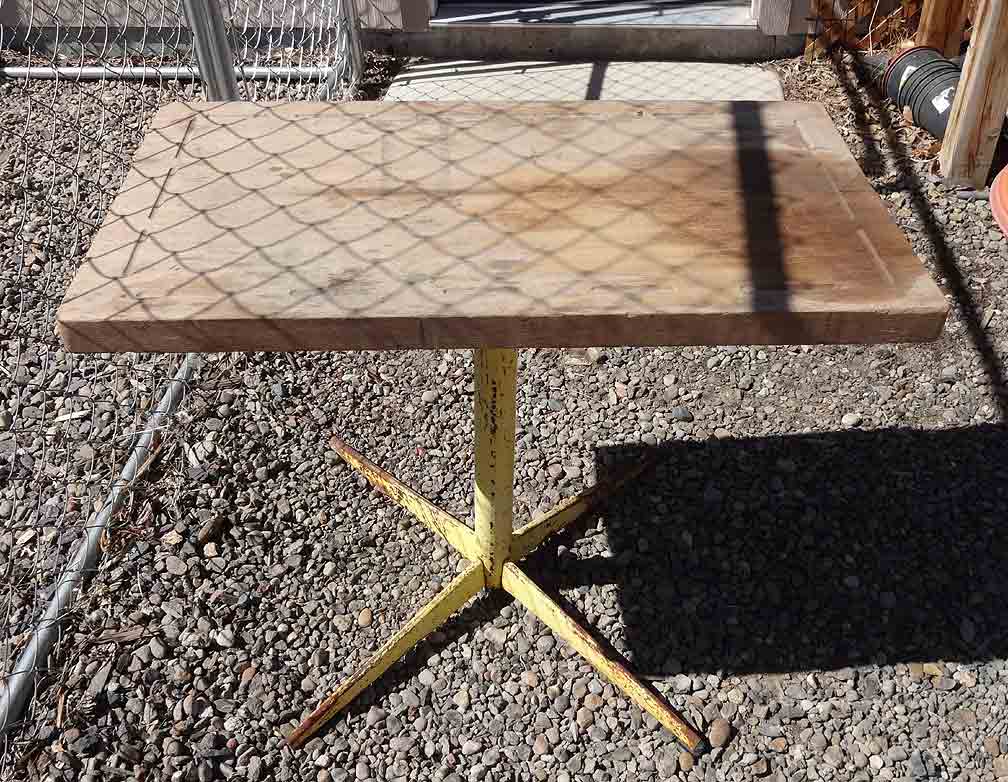

Better late than never. I started these last week. I found a table several years ago that someone had set down on the main road for anyone to scarf up. It looked like a nice piece of wood so I took it home.

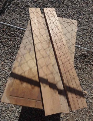

I found the floor boards last year at the hardwood store in Reno - 3 for 25 cents.

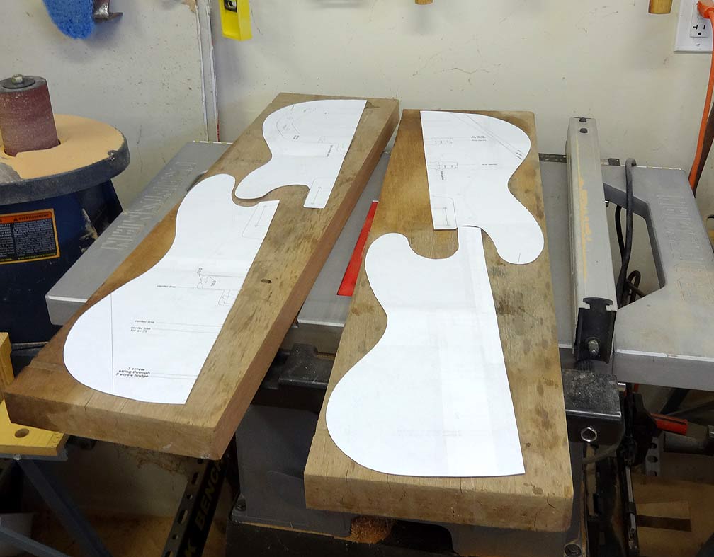

I cut the table down the middle on the glue line where the two pieces were joined. I initially thought the wood was oak, but looking at the fresh cut and calculating the weight per cubic foot, I now think it's luan.
Then downloaded some patterns, one for a j bass and one a p bass, cut them out and traced them on the wood.

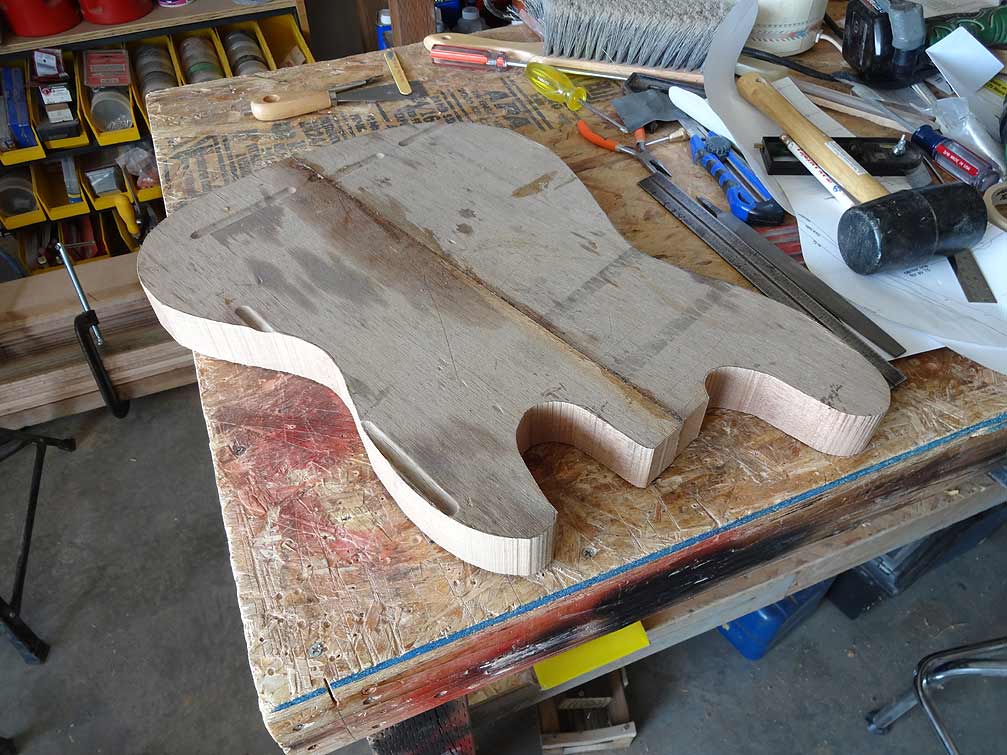

Glued. UJnfortunately, to make the patterns fit better and leave me a long piece of wood, on the first one I flipped one piece of the pattern over. This left the grooves in the table top on both sides of the glued up body, necessitating thinning it down on both sides. The top was initially 1 3/4" thick, but after thicknessing only 1 7/16". I learned from that and did the other one right, leaving it a little over 1 1/2" thick.

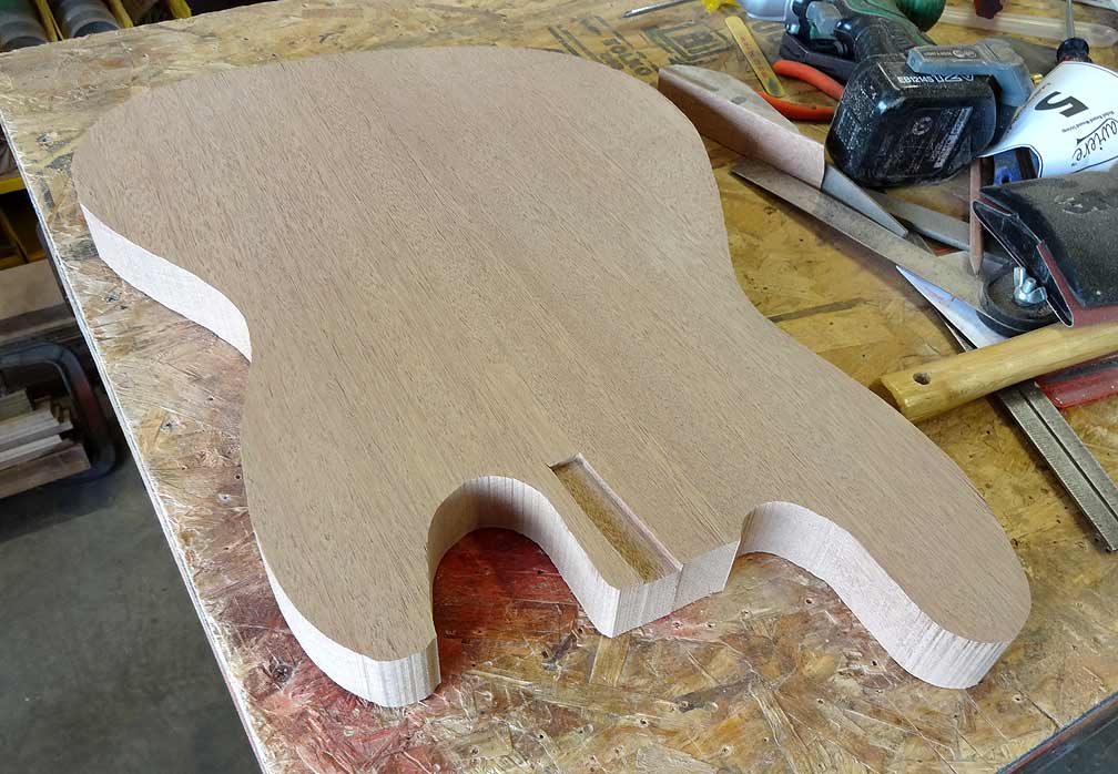

For some reason my router bit moves down about 1/4" sometimes when I turn the router on after putting in a new bit, even though I've set it correctly when stopped.
Posts: 1317
Re: Two basses from a table top and floorboards
Luckily, it's in the neck pocket and under the pick guard, so the fix won't show.

What the fuzzy... did the bit drop and chew the top in the exact same place on both blanks?! Is there something going on with hitting end-grain?
Posts: 1317
Re: Peter Wilcox's two basses from a table top and floorboards
Jason Rodgers wrote:What the fuzzy... did the bit drop and chew the top in the exact same place on both blanks?! Is there something going on with hitting end-grain?
No, that's the same body. The second picture (different lighting and some sanding) is after I repaired the part that will be under the pick guard. I just left the groove where I will route out the neck pocket anyway.
