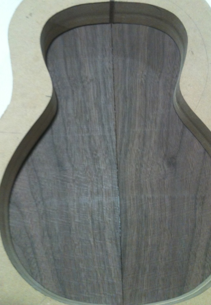

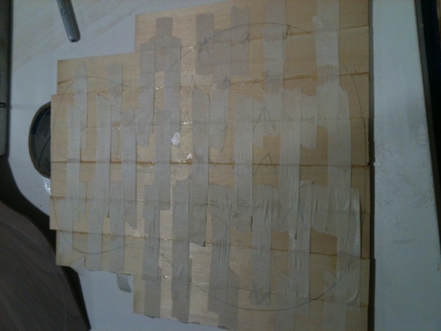

For the record, I am actually working on this project. I have about 30 min of shop time in. As proof I offer the only crappy cell phone shot I have that also happens to be small enough to post.
This is the 48 x 1 1/2 x 3/8 inch spruce lathe board I got for free from Lowes. I slip matched the 4 pieces to fit the outline so that I would not have alternating runnout every 1 1/2 inch. Then resawed all the pieces and bookmatched the other side. I could have done the other half as a slip match of sorts and avoided the whole color mismatch all together, but I am hoping it will take your eye away from the extra joints.
I haven't had a chance to clean this up and see how it looks. I was lucky enough to be able to squeeze a second walnut plate out of my scrap wood, so if the spruce doesn't look good I can go with a walnut top.

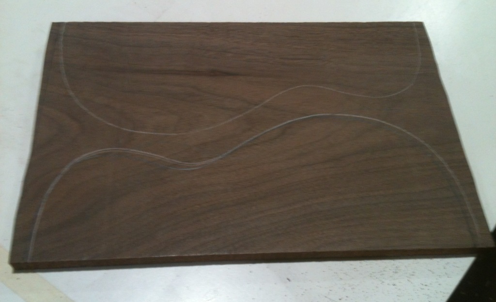

Postby Bryan Bear » Tue Apr 23, 2013 9:10 pm
Once I cut off the section of the board with the errant cut, I realized I had enough width to get two outlines. The grain on one side isn't so nice but it will serve as a nice backup plan if the 8 piece spruce top doesn't work out.
Here is the not so nice set with the knot shadow. If I go with a walnut top, this will be the back.

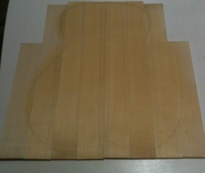

Postby Bryan Bear » Wed Apr 24, 2013 11:21 pm

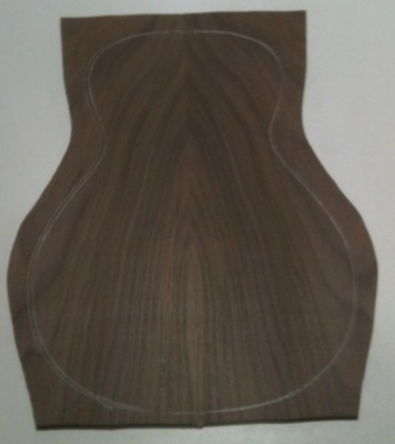

Here is a shot of the nicer back section.
I thicknesses to top to almost final dimensions. I'm torn on how it turned out. It feels really nice but I neglected to notice the color variation along the width of the board. Slip matching the sections really highlights the problem. The pic with the naptha shows it from the worst angle. The top seems so nice, I would use it if it were for me, but since I am donating it. . . I should probably start looking for another softwood option.

Progress has been slow. I have had a lot on my plate but am still in this challenge <G>
The lower rail of the old door that I wanted to use for the new top turns out to not be spruce. I believe it is Douglass Fir. The pieces ended up being too narrow for a two piece top so it will be 4 pieces, this will be better than the 8 pieces of the other option. First thing was to saw off the edges (and the 30+ years of lead paint). Then cut out a section that has enough space between the nail holes.
Here you can see the jointed top, back and sides thicknessed, lining stock made from a palate and blocks made from spruce offcuts from my workbench.
The top ended up having some interesting color variation. It may not be everyone's cup of tea, but for some reason, I really like it. Here it is with naptha:

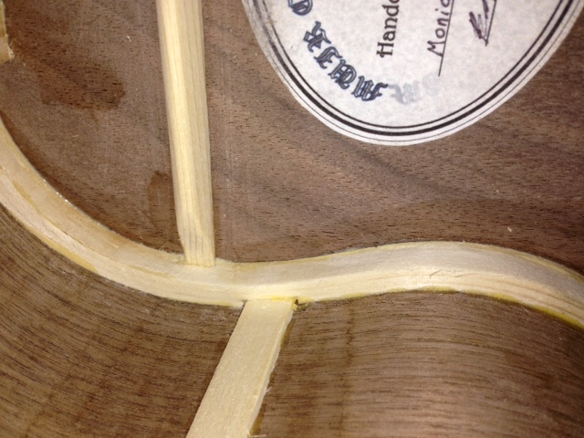

As I said, I am making this up as I go based on notes I took from some plans I had access to. I am already sure that I will make some changes on the next one. For starters, I will use a much smaller soundhole reinforcement and I will move the lower ladder brace closer to the waist. As it is now, I think both of those changes would really loosen up the lower bout.

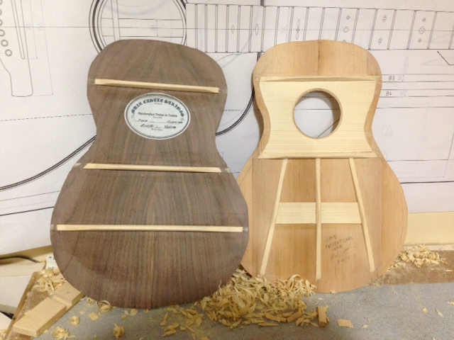

I couldn't decide if I wanted to make a 12 fret or a 14 fret. I braced it for 12, but now I think I am changing my mind. We will see how it sounds. . . When I tap the braced, free plate, it doesn't sound too musical but with the top clamped to the rim, it feels about right when I push down on the bridge area. . .
With the newborn, I am trying to jump into the shop for frequent short bursts to keep progress going. Often, I don't feel like I have time to heat up any HHG so I have been using TB for most of the gluing (plate jointing and bridge gluing are/will be HHG). I'm not one to claim that HHG is superior to TB in terms of sound or that one is cooler if s/he uses it. That said, I had forgotten how annoying TB is for glue cleanup and other workability aspects. I used it for the linings and bracing, I'm sure most won't notice but the terrible job I did of glue clean up irritates me.

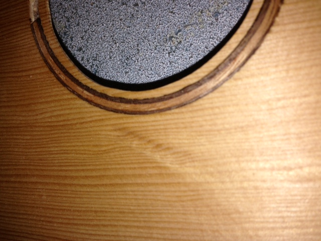

Back to the topic of the top wood changing the aesthetic "feel" of the instrument, I tried to get a picture of the grain "irregularities" in this top wood. There are several of them, combined with the warm colors of the top it really has a cool vibe. Many of you are much more knowledgeable about wood, hopefully one of you will chime in with what this is called or what causes it.

Re: Bryan Bear's tenor ukulele
Postby Jason Rodgers » Wed May 29, 2013 4:51 pm
Bryan Bear's bearclaw uke?
Not sure if that is technically bearclaw figure, but I have some Western Hemlock with that irregularity all over.
Posts: 1553
Postby Bryan Bear » Wed May 29, 2013 5:13 pm
Bear claw would be the word I am tempted to use, but it's not exactly what I think of when I think of bear claw. There are several sections of it but they are all very small (only spanning a few growth lines), it does have that 3D effect but it seems very shallow and subdued. I had a sitka top that had something similar. It was sold as a low grade top, probably because of the irregularities, but ended up looking really nice once the shellac built up. Strangely enough the back and sides of this uke came from the miscut slices from the B&S set that ended up with that top. This one is starting to feel like its little brother.
