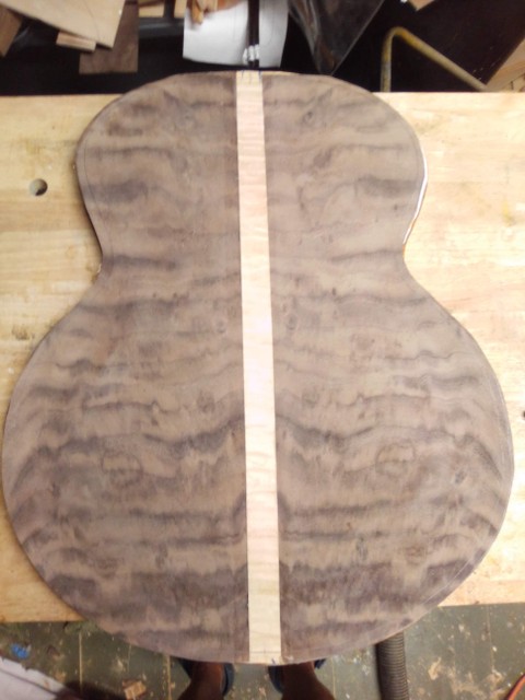

I had reservations about the recommendation to leave an 1/8" pie at the bottom 6", but I tried it on an internal layer. It did not close completely. What I finally did for my top was leave the bottom 6" of the maple center stripe untaped. I then did a dry run in the vacuum bag. Sure enough, the maple overlapped the walnut where it wasn't taped. I was able to take it out and with a fine veneer saw trim the walnut where it was overlapped on both sides of the maple. Using the inside of my 4 layer layup as a 'dish'. I pulled the maple and walnut together and taped it with blue tape (the slightly stretchy stuff from Veneersupplies,com is great.) I then flipped it over, used the outside of my layup as a form and appleid veneer tape to the outside. Remove the blue tape, apply glue (I have had better results with Gorilla (PU) glue than epoxy - just roll it out REAL thin.), and back into the vacuum bag. The result, a nice top with no wrinkles.

I, too, hated the stuff until I learned how to use it. If you spread Gorilla glue REAL thin, it doesn't foam. According to one 'authority' I read, it expands ~3x which is why it is great for nomex, it climbs the walls of the honeycomb just a bit to create nice filets. i use a rubber veneer glue roller (https://www.veneersupplies.com/products ... oller.html) and roll it out just as flat as I can. It really uses amazingly little glue. So far, I have had excellent results on veneer to veneer as well as veneer to nomex. It does not have a very long open time, so I just do one lamination at a time, but I can pull it out in 90' and add another layer before going back in the press. Eventually I leave it all overnight which I'm sure is overkill, but it is easy.
Oh, I cut the darts as they arranged themselves on the dry run, ~5" long tapering from 0 to ~1/16 on each side of center stripe.
I just got a really beautiful piece of curly walnut with a very nice crown pattern. It is large enough to do the whole top from the single piece, but how to manage the complex bends?? I think I will try using SuperSoft-2 to saturate it and then press it to the arch mold. If it takes the shape without splitting, I'll laminate it up as soon as it is close to dry. Gorilla glue likes little moisture anyway, but i don't know about the SuperSoft-2. I can tell you it melts shellac and the glue on veneer tape. (Don't ask, bad experience), but maybe just a little residual dampness to keep things flexible would be OK. Anyone with any experience with this?

I've used SuperSoft-1 and 2 quite a few times. It will make veneer fairly flexible but as I said above, it does not allow the veneer to stretch so I don't think you will ever be able to get a one piece veneer to conform to the arch without using a dart.
I usually follow the directions for the SS-2 and let the veneer completely dry before glueing or bending it. I would be cautious about trying to glue veneer before it is dry. I did some testing once and found that wet or damp wood leads to glue failure in most cases.

Does anyone layup the halves of the plates separately and then joint and glue them up like you would a flat top back or soundboard? I wonder if that would allow the veneer to be molded without darts?

I would think that very difficult to joint complex molded pieces and would take away the strength you get from cross grain lay-up.
FWIW, I just successfully molded a single wide piece of "cathedral" grain curly walnut into an arch. I used SuperSoft-2 to saturate the veneer, then placed it on my form with a couple layers of newsprint on each side and then slowly pulled a vacuum while "massaging" the wood. I know others have said it cannot be done, but my piece took the compound bends without cracking. It is scary taking a gorgeous piece of wood and knowing you may ruin it, but maybe I was just lucky. Your mileage may vary.
Just a note: I did this with the veneer by itself. Once it was formed and dry, I glued it to the other sheets in the lay-up. That way, if it didn't work, I didn't ruin all 5 layers.

I'm thinking the strength would be similar to that of a carved solid wood plate, not as strong as a plywood plate, but maybe strong enough. Jointing and gluing the edge might be a little tricky. I'm still at the "musing" stage, and researching what other peoples experiences have been.

Mark, congrats on your success with forming the veneer. I didn't think it could be done. You may have come up with a completely new technique. May I ask, how high of an arch do you have in your plate?

About 5/8" at max (around the bridge location) FWIW, it is a 17" lower bout.Barry Daniels wrote: May I ask, how high of an arch do you have in your plate?
