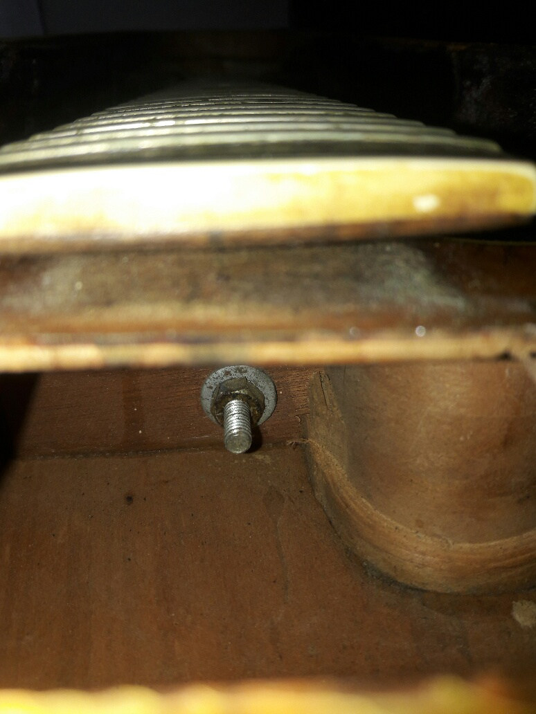

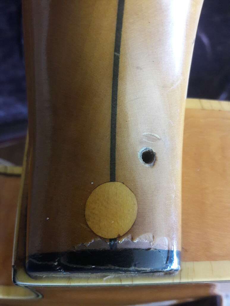

Another possible clue -- and it may be meaningless, which is why I'm asking the brain trust -- is that the neck has a bolt at the heel. I've attached a couple of pics to show this. You can see the bolt protruding inside the guitar body where the neck joint is. Outside, you can see where an apparent hole has been plugged. Seems odd to me, but we're talking 1954 here and who knows how many mods.
This bolt holds the neck in place
Plug, apparently covering bolt

I'm going to guess that the bolt was an add-on.

Humpblock fret markers would be normal in a pre-1957 model. The neck would have been fastened with a wood screw through the heel and it looks like someone removed the screw and replaced it with a bolt and nut through the head block. I think David is correct in his analysis of the truss rod problem.

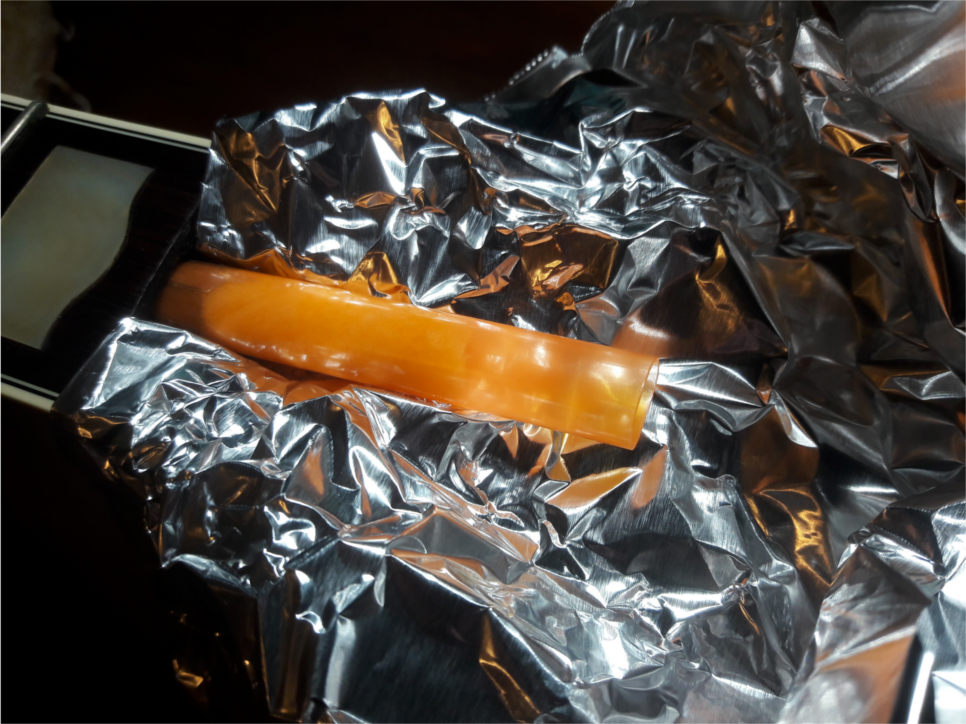

I did the penetrating oil/soldering iron thing, but so far, no luck. But I'm not giving up that easily and I'm in no hurry. I thought I'd try soaking the nut in PB Blaster, but of course you can't just dunk the headstock into a vat of the stuff. It so happens that my kids have these oversized drinking straws that fit perfectly over the nut. So I stuffed a rolled-up paper towel into the straw, soaked it with PB Blaster, and pushed the whole thing over the nut with a little foil just as a protective barrier. (See the pic ... looks kinda illegal, but I assure you it's 100% legit.) I'll leave it there awhile and see what happens, and will continue doing the heat thing until I'm convinced it's futile. I have thick skin.
Straw fits over nut; inside is a paper towel impregnated with PB Blaster.

Do you think the PB Blaster will melt the straw? Some plastics do not hold up to solvents well.

Good question, LOL! But luck appears to be on my side this time. Left it overnight and still stout.
