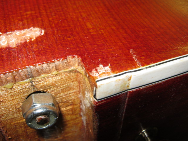

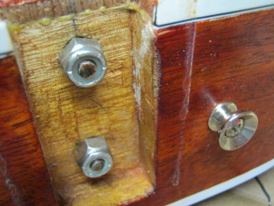

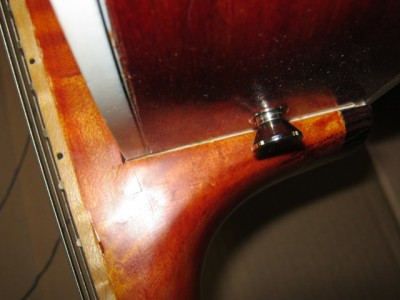

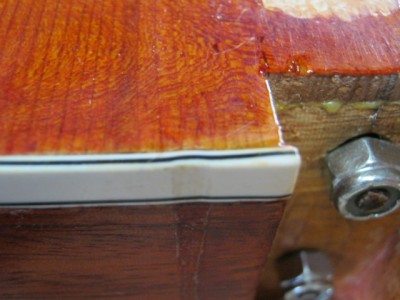

Postby Brian Evans » Wed May 24, 2017 3:56 pm
I really have no idea what kind of mahogany it is, I thought it was Honduran. I don't know how to tell different types of mahogany apart. I took the neck off and took pictures. I can measure the indentation at between around .020" at the deepest point, which is enough to change action height noticeably. You can see pretty clearly the dent in the lines in the binding, and one side is worse than the other. You can also kind of see the shim material that I stuck in almost disappearing near the top. I can confirm that I did the bolts up tight, maybe around 40 - 50 inch pounds, which is far more that string tension, and probably around 800 lbs of preload per bolt. What I can also confirm is that on the side that is having the worst issue the heel cheeks have been relieved so that the surface pressing on the side is very narrow, almost angled all the way out with no flat bearing surface at all. I think those two problems are what caused this, and I can fix them both. I may leave the top bolt out, and just do up the bottom bolt lightly after I fix the sides and put it back together.
Posts: 689
Re: neck heel crushing sides of guitar
Postby Barry Daniels » Wed May 24, 2017 4:01 pm
The relieved edges of the heel should be flat where they bear against the sides, not a knife edge.
And it sounds like you are over-torquing the bolts. I would take them to finger tight (where the heel makes contact) and then go about 1/4 to 1/2 turn more.
Posts: 1946
Location: Houston, Texas
Postby Pat Foster » Wed May 24, 2017 11:11 pm
What Barry said, plus, from what I can see in your second and last pictures, the cheeks of the neck aren't making full contact with the sides like they should. It looks like most of the force from the bolts is concentrated at the top, near the soundboard, and at the bottom, near the heel. Along with the knife edges, the force needs to be spread up and down the sides evenly from the soundboard to the back. If one side is depressed more than the other, it could mean there's a high corner, like a table with one leg too long. The cheeks should sit squarely and steadily against the sides without gaps, even with the bolts loose.
Looks like most of the denting is happening near the soundboard. If it's from overtightening the bolts there, keep in mind that it's the bottom bolt, near the heel, that has to do most of the work in resisting string forces that want to pull the neck up.
Pat Foster
Posts: 109
Location: Spokane, WA
