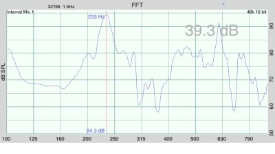

Craig, does that app allow you to set limits on the chart axes, and does it quantify frequency peaks? A lot of different frequency analyzers don't do that and I see it as necessary.
- Posts: 377
- Location: Drayden, Maryland
Re: Effect of plate thickness on archtop guitar power
You can set limits on the axes, but the setup does not stick, the next time you open the app, you are back up to full scale. But, it is very easy to adjust the scales and limits by typical smart phone gestures. Two fingers spreading apart/pinching horizontally zooms the frequency axis in/out, two fingers vertically adjusts the amplitude axis. You can both zoom and scroll. Occasionally, my fingers get confused and the wrong thing happens, but the curve is not lost, just have fuss with it some more to get the view you want.
To quantify the peaks, you can pull a guideline from the side with your finger and move it to the center of the peak. The frequency is shown next to the guide line. You can zoom in and steepen the peaks for more accurate ID by means of the gestures above. For me this is all easier in FFT than VA.
You can take a screen snapshot with a one button click on the screen and they save to your photos app on the smart photo, so they are easy to access and share.
Snapshots are just pictures though, not interactive. For future interrogation, you can save the curve in the FFT app, to be recalled later where you can apply all the interactive bells and whistles, You can also recall and overlay multiple curves easily which is handy if you want look at coupled vs. uncoupled, or before and after installing bridge, etc.
The app is supposed to allow exporting the curves to a PC, but I've never been able to get that to work. I don't know what I would do with them over on the PC anyway in that as far as I know, there is not PC version of the app. So, I back up my phone periodically.
Anyhow, I've not used VA now for over a year. FFT was okay on my little iPhone 5, much better on my 7+. It would be good on an iPad too, but the 7+ is always with me, so super easy to use. This is very helpful, not only in the shop, but also in the field when you encounter a killer guitar you'd like to investigate, takes about 10 seconds to setup, tap and save. Now if I could just find a similar app for taking top deflection readings.

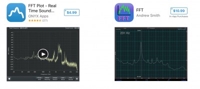

There seem to be two apps that you might be referring to. Here's a screenshot of them on the App Store.Craig Bumgarner wrote:Sorry, typo. FFT, not FFF.
Which one do you have? Both might work.
Thanks,
- Posts: 377
The second one, FFT by Andrew Smith, is the one I use. I did not research others, some one recommended FFT to me and it has worked well enough that I have not looked for alternatives.Eric Knapp wrote:Which one do you have?
