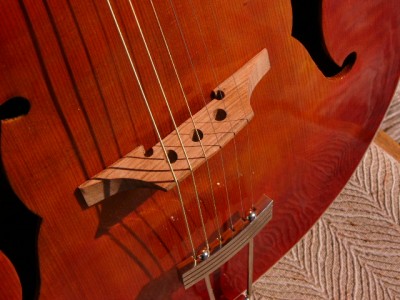

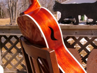

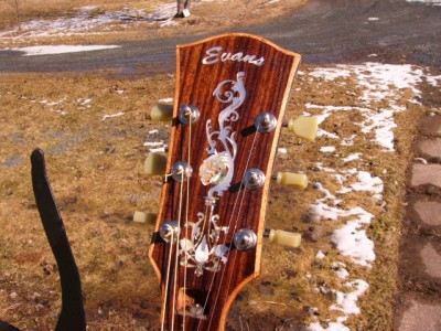

I named this one after my wife. First traditional archtop, curly redwood top and mahogany back/sides, birdseye maple neck, one piece jatoba bridge. Just put it together after final finish spraying, I will wait a few weeks and then polish it out. Hand-rubbed sunburst using alcohol based leather dyes over a shellac base coat. Sound is big and round, kind of shimmery, quite loud to my ears (louder than my 17" jumbo flat top, anyway), and pretty balanced. Mids and highs can really punch if you dig in. I bought the inlay work from England, it's pretty nice. I added a small wave-shaped sound port on the upper bout side, which makes a noticeable difference in tonal balance. The flame pattern changes considerably depending on lighting and angle.

That's a nice looking guitar! Could we see a few more pictures? Maybe the back, sound port, bridge, etc.

A couple of more pictures.

I think it's excellent. Kitty seems to like it, too.

Thanks for the nice comments. Kitty is a cast iron piece bolted to the railing, it's odd indeed to come out and see birds perched on her...

Great looking instrument. The tailpiece is the only thing that isn't yours. I'd like to see the tailpiece YOU build.
