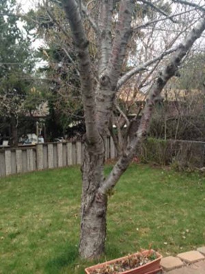

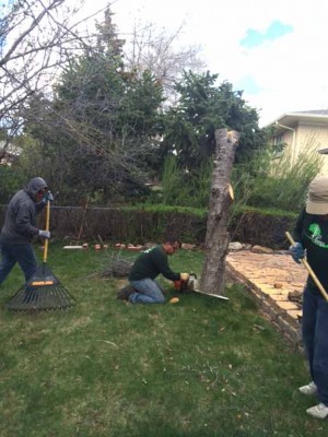

My brother's cherry tree died a few years ago, and when I flew out there to visit, I took 2 large suitcases so I could bring home some wood (2 free 50# bags on Southwest.) We cut out a 30" section of the trunk, cut it in half, pared them down to under 50# apiece (that's some heavy wood), painted the ends with latex, and I brought them back and let them dry.

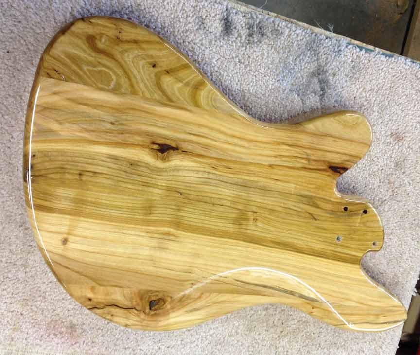

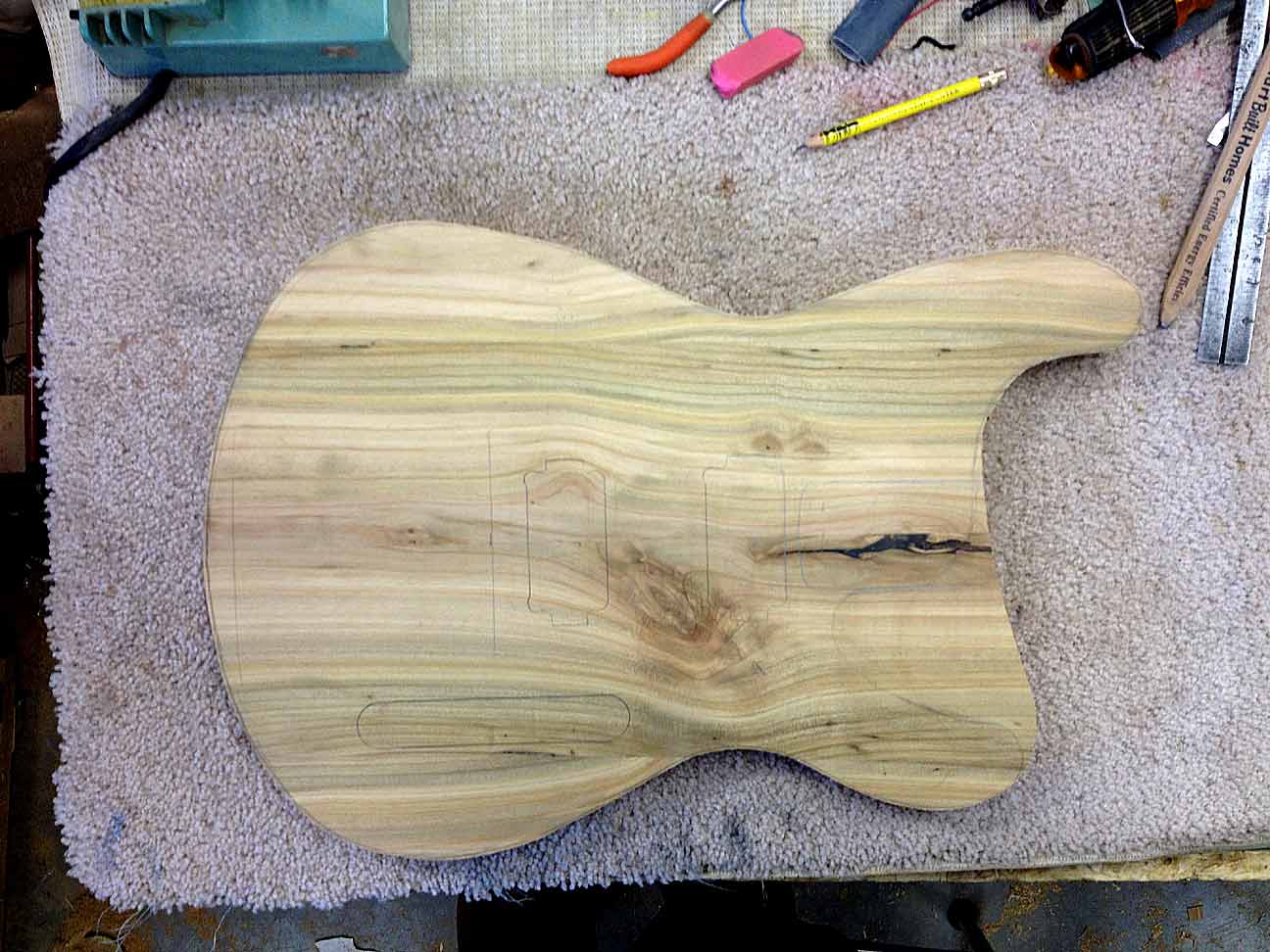

Late last year I resawed them (poorly) to build a guitar and a bass. The wood had lots of checks, splits, knots and worm holes, and I made lots of procedural mistakes, but I pushed on and they're finally done. They're very heavy, even though I thinned the guitar body to 1 3/16", which caused its owns set of problems. Building these was a learning experience.

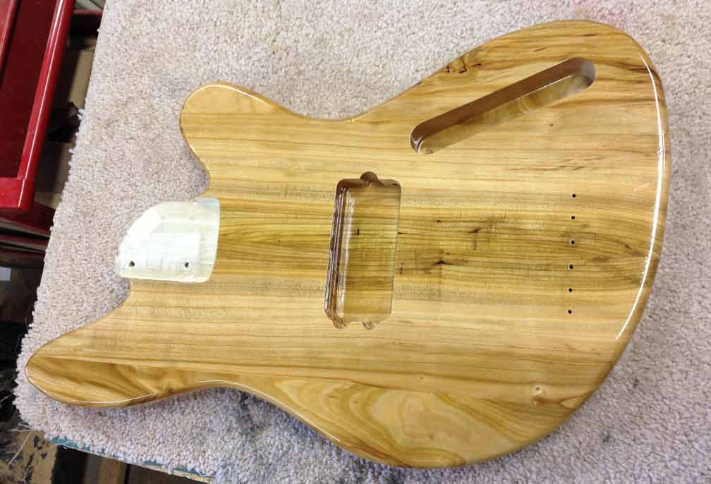

The bass is finished with clear lacquer - no dyes, stains or pigments

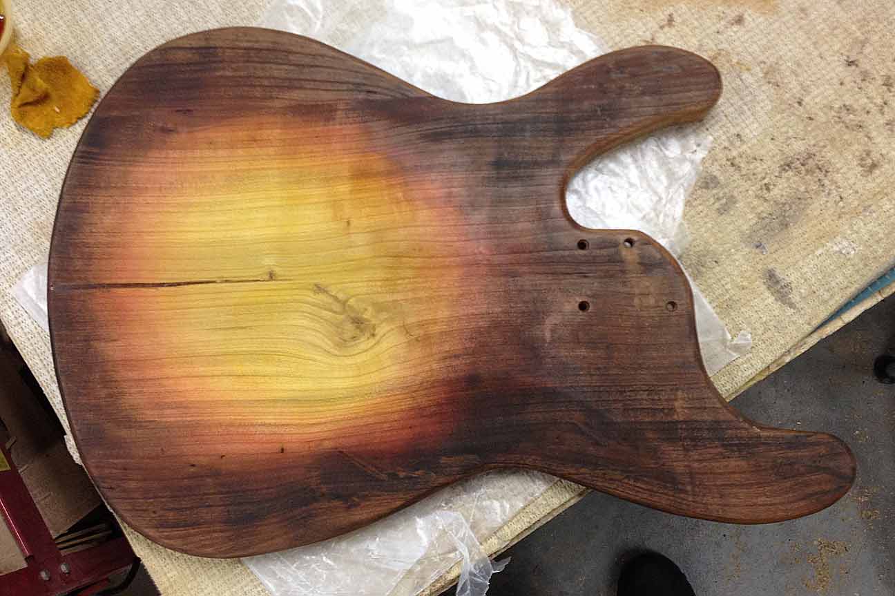

I thought I'd try a wipe on sunburst on the guitar - wow, bad mistake. In addition to my inexperience, the different cuts of wood, and the repairs took up the dyes variably. I reverted to a spray on sunburst which didn't come out too bad.

When you tried the wipe-on sunburst, was this on the bare wood?

The wipe on was to bare wood. I figured if the wood was finished or sealed that wiping it would streak it What I didn't figure on was the variable uptake of the dye by the irregular wood figure, the different cuts of wood glued together, and the epoxy repairs of the cracks and worm holes. If I try it again it will be on good wood with a regular or symmetrical figure.
Also, when I sprayed on the the sunburst, I had a brain fart and added the pigment to lacquer thinner and sprayed that, not lacquer. It sure dried fast, and came out OK in the end with multiple clear coats over it.

Thanks, Peter.Peter Wilcox wrote:The wipe on was to bare wood. I figured if the wood was finished or sealed that wiping it would streak it What I didn't figure on was the variable uptake of the dye by the irregular wood figure, the different cuts of wood glued together, and the epoxy repairs of the cracks and worm holes.
I have a build in my head that would benefit from a burst, and I was thinking of trying that hand-applied dye technique demo'd in American Lutherie a while back. I was thinking that you might have minimized the effects you observed by preceding the dye with a wash coat (1/2 lb to 1 lb cut) of shellac. I'll be doing some test runs of whatever techniques I try, so I'm interested in how others are doing this. I'll have to go back to the AL issue to see how the fellow that demo'd that technique (he was doing mandolins) as I don't recall whether he was working on bare wood or did any kind of prep.

Steve, that sounds like a worthwhile idea. The only Youtube videos I saw were on bare wood, so the dye would be well absorbed. I suppose with the correct cut of shellac that could be adjusted. Let us know if you do it and how it comes out. For now if I do any more bursts I'll spray.
