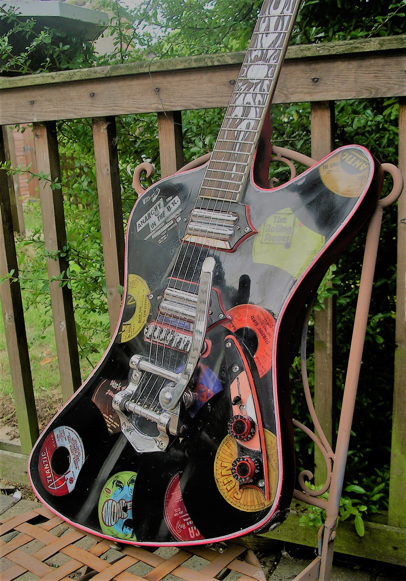

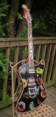

Here's one of the latest from my workshop. I actually thought that this would be an easy project, ummm I was pretty wrong on that count! Working with resin is horrible and not what I expected, the 45s are encased in the resin top which is about 10mm-12mm thick and the pickup surrounds and control plate are also made from 45s. I completely underestimated the work required in flattening and polishing the resin, also the plastic that records are made from is such a poor quality which again makes it difficult to work with and get a quality finish.
In all honesty this guitar was about five times the work I expected and I would have gladly smashed it to pieces or set it alight at many points in the build! Because of the difficulty working with the materials the finish is short of the quality that I wanted so it's not something I'd be happy selling so I had a change of heart and decided to finish it and give it to a young guitarist who plays in a local band, they play all original stuff and may be one day the guitar will end up being good advertising for me.
The "Bigsby" was a last minute change, it was going to be a wraparound but the above mentioned guitarist let it slip to me that he'd love something with a Bigsby, hence the recessed bridge. The pickups are GFS and coil tapped and the rest of the guitar is pretty standard stuff.

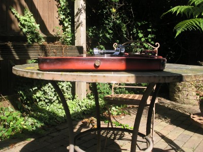

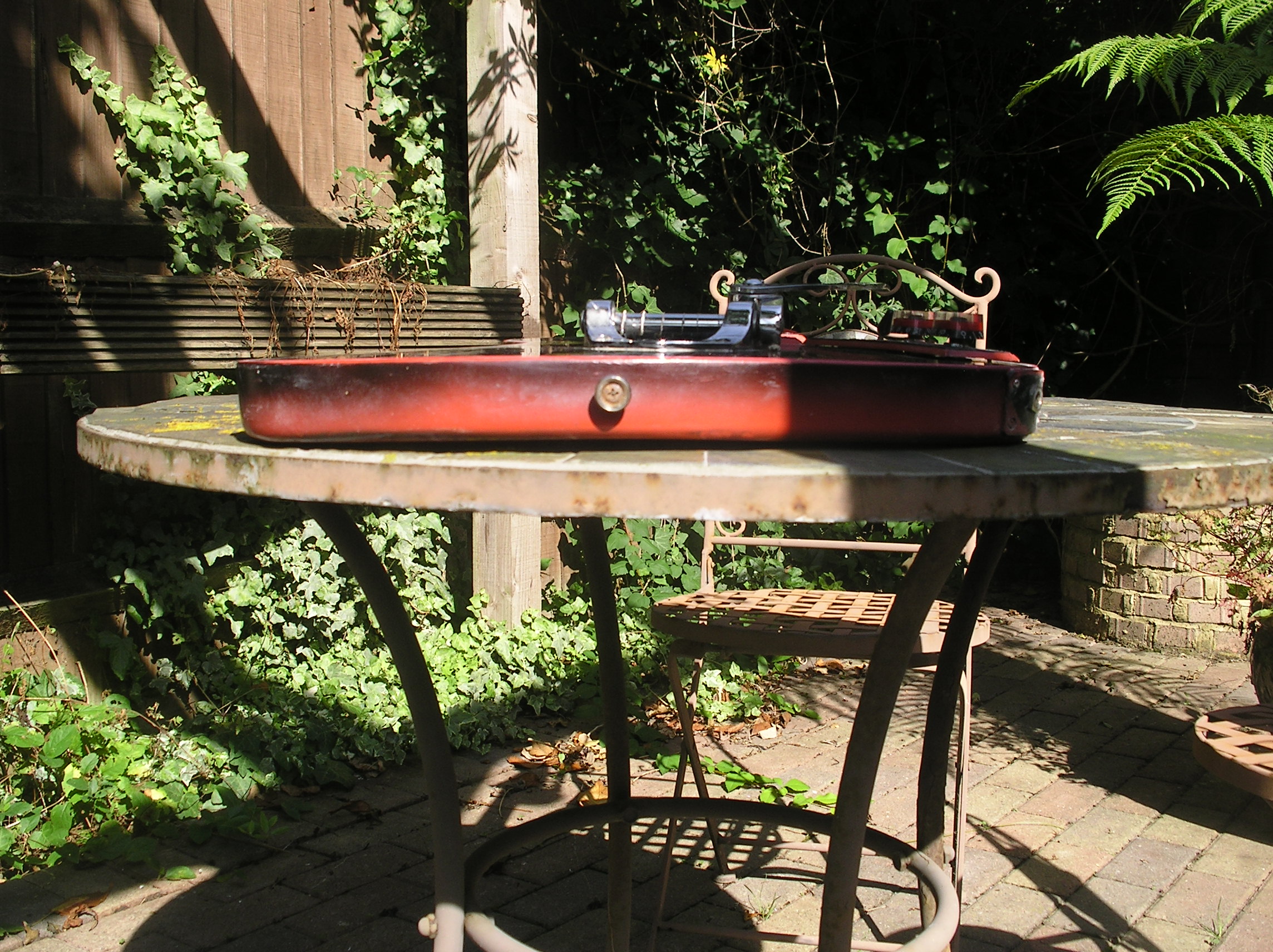

Postby Chris Richards » Fri Aug 17, 2018 5:33 am
Thanks for the comment David...Yes, like you say it should have been a piece of cake, I can't remember what type of resin I used, I know I chose a good quality product. The resin must have expanded as, one good thing, the guitar curved such that the top is convex so that's pretty cool (see picture)! Also the resin when it set was all "wobbly". Once it set I had to leave it for about a week in a warm place to completely harden then it was the bloody awful task of flattening it and polishing.
I should add that the 45s were any old ones with what I would consider "cool labels" copied from the internet and printed out.
Yes, if I ever do this again I'll do some research in to different resins and their properties.
