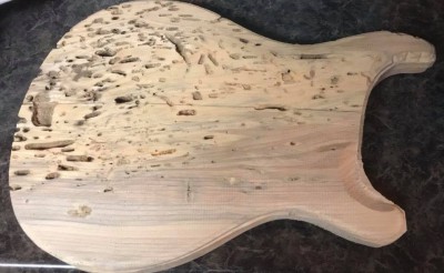

So I have been out for a while, I'm working on a couple of fun little projects.
The first is what I have dubbed as McWormy. A double cut body out of wormy ash. I'll be filling the holes with tinted/glow epoxy for what will hopefully be a pretty cool effect.

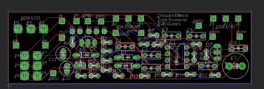

The other is an onboard tube screamer effect. I've created a prototype of it with veroboard and that worked well so I took the schematic and ordered some custom circuit boards and I'll be trying this out in McWormy.

Postby Beate Ritzert » Sun May 13, 2018 6:08 pm
Eric Baack wrote:The first is what I have dubbed as McWormy. A double cut body out of wormy ash. I'll be filling the holes with tinted/glow epoxy for what will hopefully be a pretty cool effect..
AFAIK there is the possibility to tint the epoxy with luminescence color. An example has recently been shown on the Holy Grail Guitar Show in Berlin - this instrument: https://www.saitenkraft.ch/jk-mk-ii-t-legacy there exist a documentation of the building process in a german speaking forum. A cannot provede the link because that would be against the policies here.

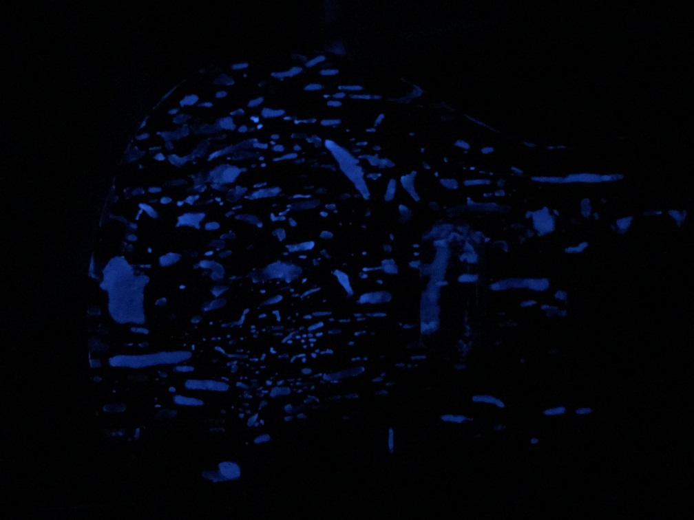

Postby Eric Baack » Mon May 14, 2018 9:09 am
I have put glow powder, blue tint, and pearl powder into it :)

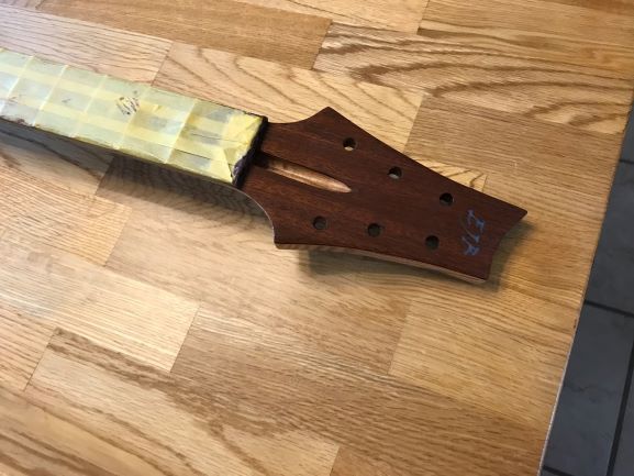

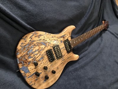

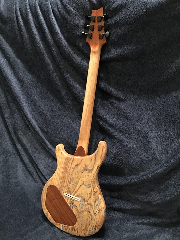

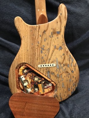

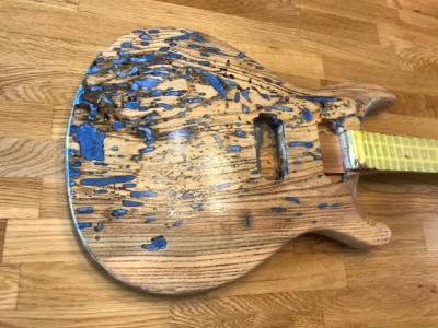

Postby Eric Baack » Wed Sep 19, 2018 4:40 pm
Here's a few shots of McWormy. It's been slow but I should be purchasing some hardware for it before too long. Gotta sand back the shellac again and apply another coat before sanding and applying the poly. The control cavity cover is being re-done so I'll have to fill the pores in that. The one here turned into a potato chip when I glued on a veneer so the new one is a solid piece of mahogany instead.
Eric Baack

Postby Gordon Bellerose » Wed Sep 19, 2018 5:23 pm
Pretty cool!
Does it glow in the dark?
Posts: 1104

Postby Beate Ritzert » Wed Sep 19, 2018 7:13 pm
Yes, pretty cool. But why blue and not something like red or a dark, slightly orange yellow?
How did You ensure the worms/beetles were not active anymore? Isopropanol?

Postby Eric Baack » Thu Sep 20, 2018 9:20 am
It was a kiln dried piece so the wormies should be dead. I did treat it extensively with some minwax wood hardener also.
I just thought blue would look good and give a bit more glow then it would with a darker color.
The wood also has some bluish streaking in it that is kind of subtle.

Postby Eric Baack » Thu Sep 20, 2018 12:36 pm
got a black hipshot bridge on it's way :) going with all black hardware on this one. knobs will be black knurled with abalone caps. I'll be putting a GFS fat pat into the bridge spot and a dream 90 into the neck.
Eric Baack

Postby Dan Hehnke » Sat Sep 22, 2018 4:13 pm
Cool! Can't wait to see it done. Maybe I'm missing this, but what kind of Poly are you using for the final coats?

Postby Eric Baack » Mon Sep 24, 2018 3:18 pm
I'm using Spraymax 2K again. It has worked very well for me in the past. My spray gun kind of sucks and this stuff is a proper 2K clear in a can. Makes for a silky smooth neck too, especially with a bit of was applied.
