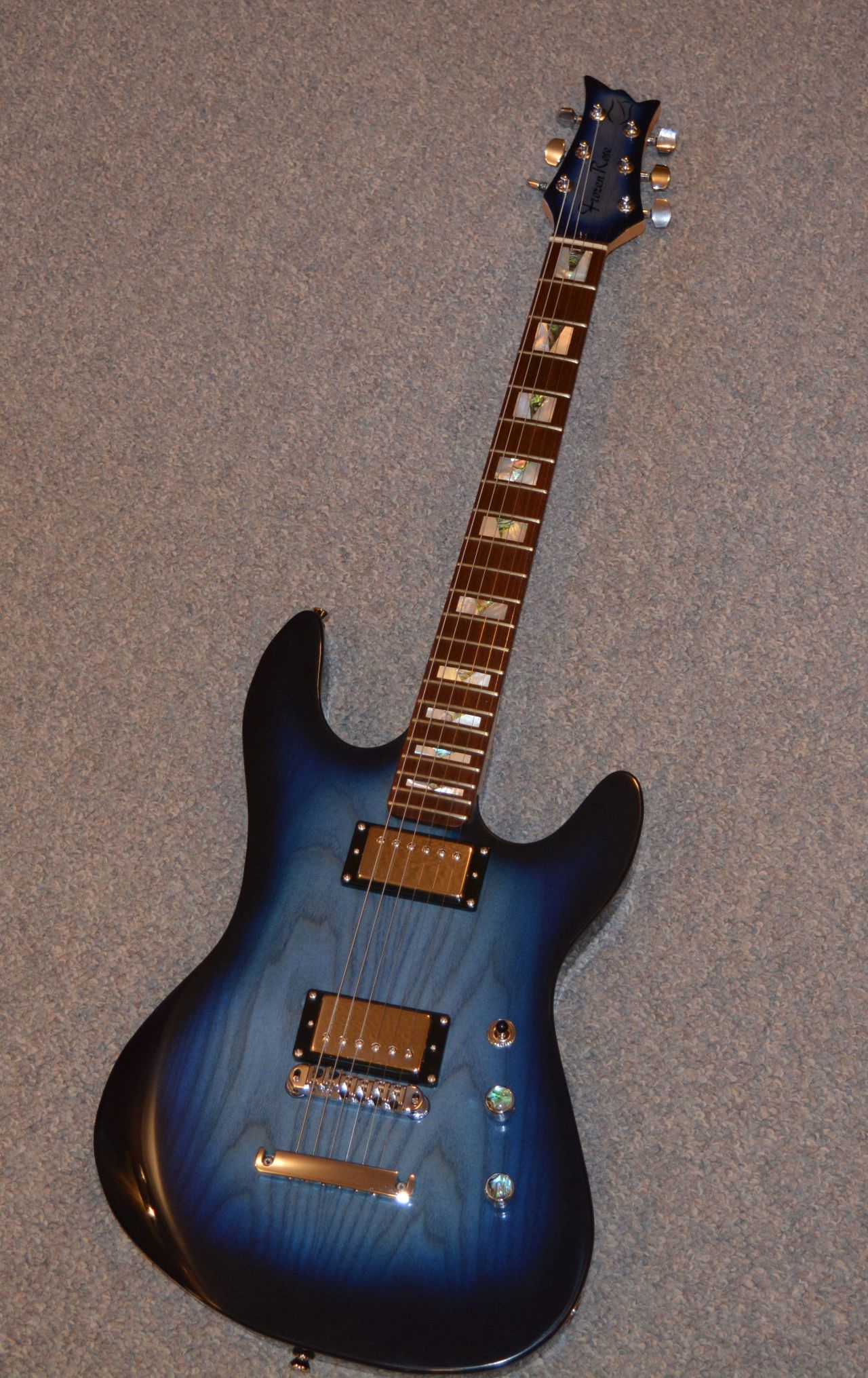

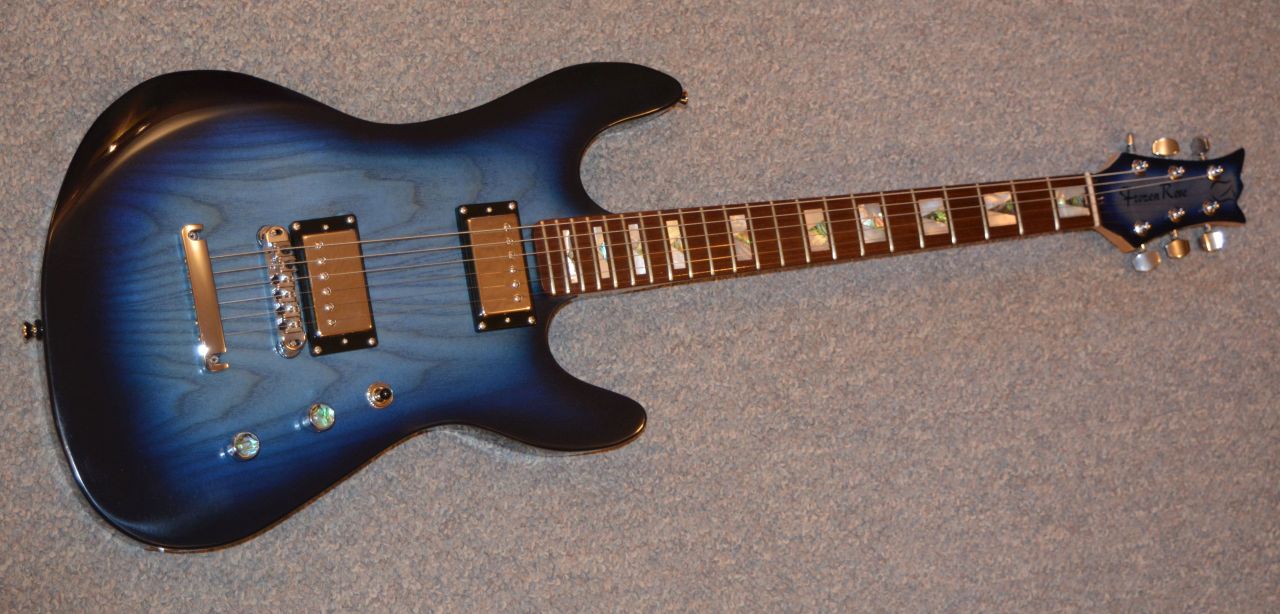

Postby Gordon Bellerose » Sat Apr 14, 2018 12:20 am
Finished this one last fall, and just got around to taking pics.
Here's the run down:
Swamp Ash body
Maple/Padauk neck
White MOP inlay with Paua inserts
Locking tuners
Golden Age humbuckers with coil split using push/push controls
Roller TOM bridge
Blue burst finish.
Plays and sounds really really nice.

Postby Freeman Keller » Sat Apr 14, 2018 12:09 pm
Very nice, Gordon. I've used the Golden Age humbuckers on a couple of guitars and was very impressed with them.

Re: New Guitar
Postby Chris Richards » Mon Apr 16, 2018 3:00 am
Very nice, love the colour, for some reason it looks a bit Mosrite'ish?

Re: New Guitar
Postby Gordon Bellerose » Mon Apr 16, 2018 8:37 am
Bob: Thanks!
Chris: I suppose it could resemble any number of guitars. It's difficult to draw and build a double cut, or any other shape for that matter, that doesn't resemble something. People have been doing this for a while now. :D

Postby Steve Sawyer » Mon Apr 16, 2018 10:05 am
Nice job, Gordon. Beautiful sunburst, and I love the FB inlay!!
Who's the manufacturer on that bridge?

Postby Gordon Bellerose » Mon Apr 16, 2018 10:35 am
Posts: 1139
Re: New Guitar
Postby Steve Sawyer » Mon Apr 16, 2018 3:10 pm
Gordon Bellerose wrote:That is the locking roller bridge from our friends at stewmac.
Thanks, Gordon!
Also, which Golden Age pickups do you (and Freeman) use (alnico 2/5, overwound)? I'm considering using them for my current build...
