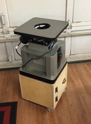

Speaking of purchase justification!... This project could not have been accomplished without an oscillating spindle sander - which I did not have - BUT I DO NOW!!
I love my little Dalek! I have no idea how I ever got along without this little beauty. It's quiet, it's compact, it's versatile, and the dust collection works surprisingly well. The sides of the solid body, the headstock shape ... sure those are all the things you associate with this tool. But I'll tell you what, I can shape a bone nut in like 2 minutes with this thing - friggin' awesome!

Didn't you use a spindle sander to shape the contour cuts on an SG?

I use a 3" drum in my drill press a lot. Every time I do, I think "oscillating spindle sander..." It simplifies my design process, every inside radius is 1.5"... Or ends up 1.5"...

By the way, I never showed the volute detail, that I could not have done so easily without the spindle sander.
