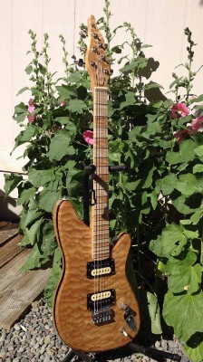

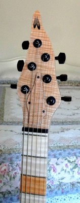

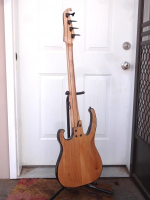

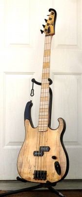

Thought I'd add another I just finished to this thread. I tried a water base polyurethane and didn't like it at all. It blunted the figure of the wood, couldn't be applied over shellac (per manufacturer), and for some reason I haven't figured out yet I kept getting fisheyes, despite changing air filters and guns, and they appeared on both the maple and the alder, so it's not the wood. I'm beginning to believe it's a contaminant in the can, but I'll have to brush some on a piece of wood to see. I drop filled them and sanded them out, but I was frustrated and didn't do a perfect job. It's an auction donation, and otherwise an OK guitar, so folks will see it before they bid.

That's really nice work.
Re: Some maple tops
Posted: Sun May 07, 2017 10:09 pm
by Peter Wilcox
Thanks, Bob, Though it was a disappointment for me the way the finish turned out, it was a learning experience, and it made $750 for a worthwhile cause on Saturday.

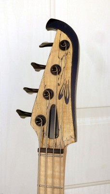

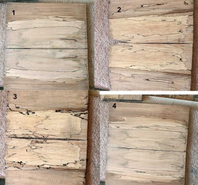

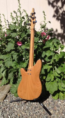

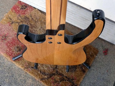

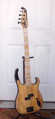

My son brought me 2 pieces of maple firewood from Washington a couple of years ago, and I resawed them a few months ago. Surprise!
He wants me to make him a guitar and a bass, so I thought I'd use that wood. The problem, though, is that it's only 15" long, so I had to make some adjustments.
I've made the bass, and just starting the guitar.
So the top is from #2 above - the guitar will be from #3. Body is alder, neck alder and walnut. Scale 34". Nitro finish.

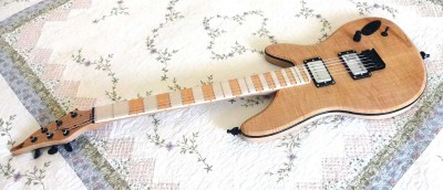

Guitar is done too.

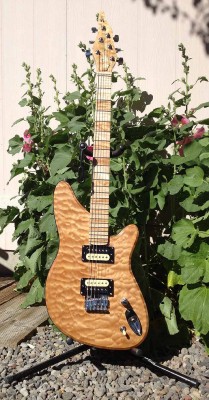

Just finished a quilted maple top - chatoyance is remarkable.
