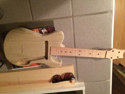

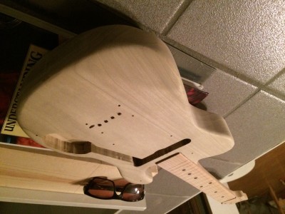

Postby Matt Baker » Mon May 16, 2016 5:13 pm
Here are a couple pictures pre-finish.

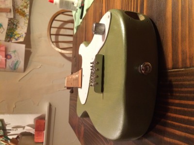

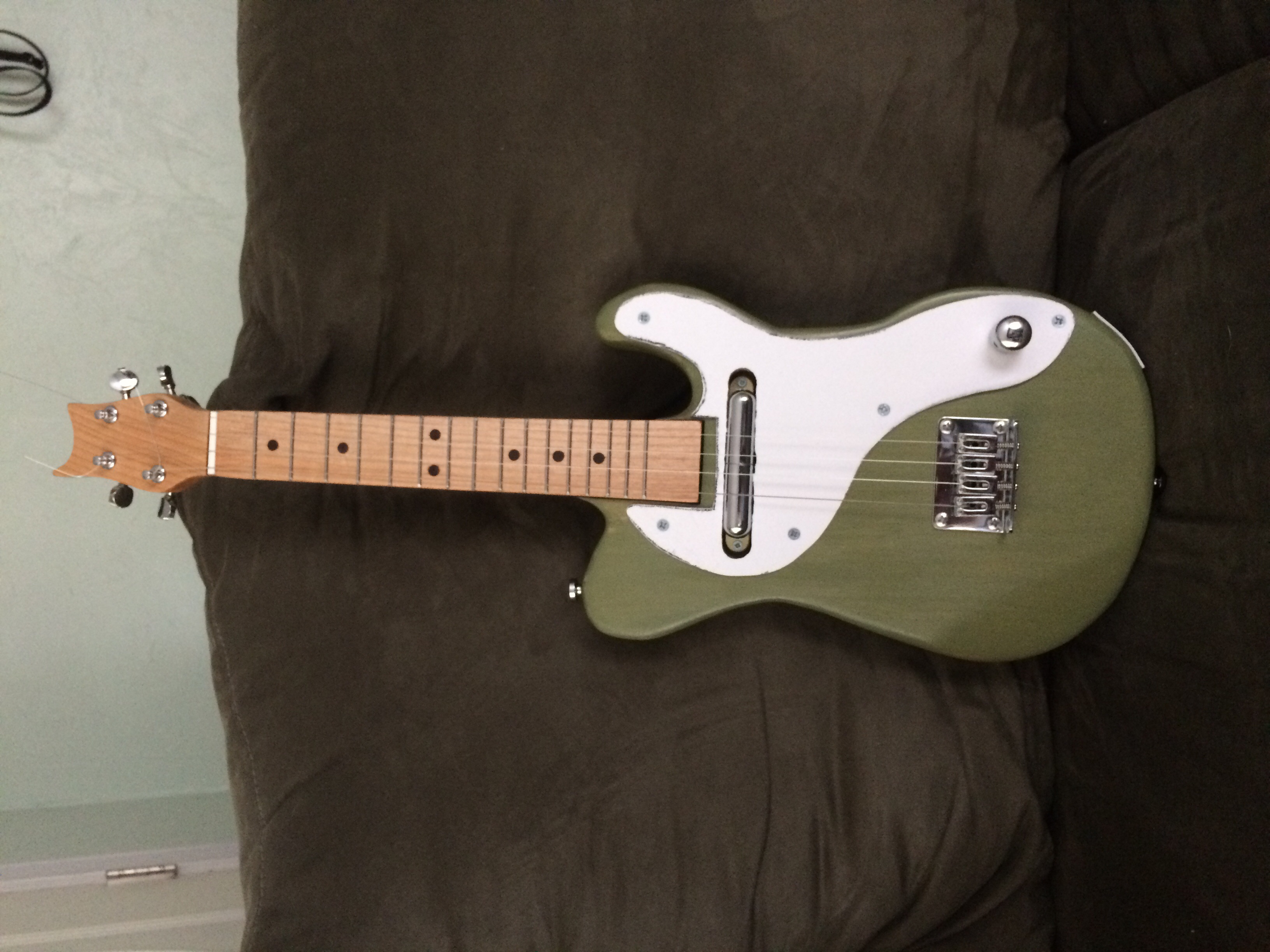

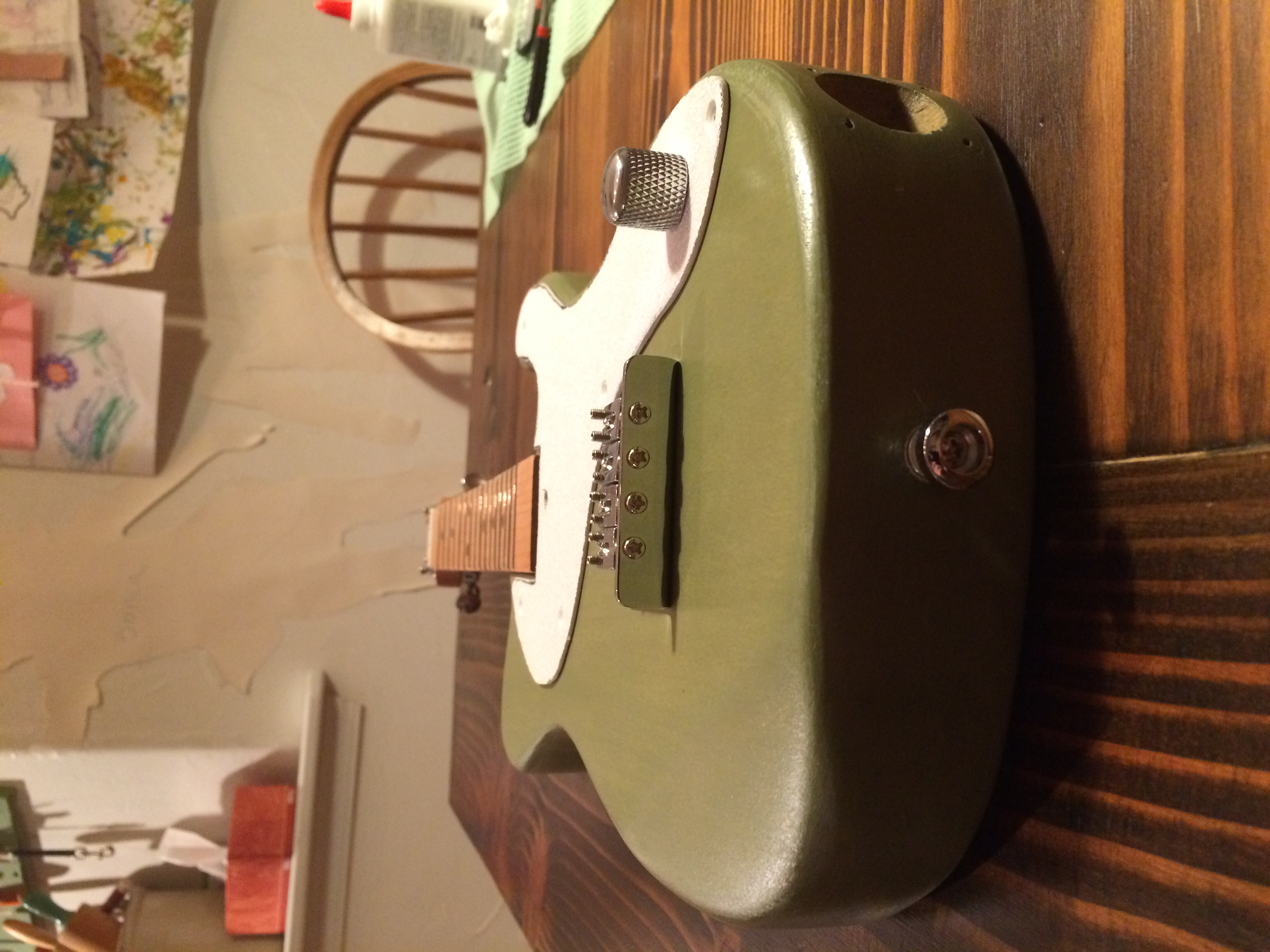

Postby Matt Baker » Fri Jul 08, 2016 3:46 am
Thanks for all the insights. Here is the finished product.

Postby Eric Baack » Fri Jul 08, 2016 10:27 am
how does it play?
Eric Baack
Posts: 598
Re: String gauge question
Postby Matt Baker » Fri Jul 08, 2016 10:14 pm
I'm quite happy with how it plays. There are a couple of notes higher up the neck that are buzzy on the G (lowest) string, but other than that the frets play the notes they're supposed to, so I won't complain too much. For being my first attempt at a real-ish style neck I am very pleased.
