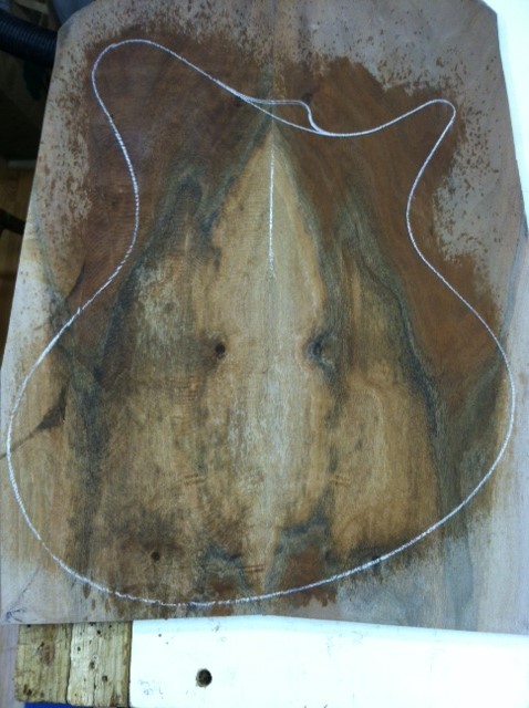

This was a one-piece spalted maple body blank that I bought from David King at the Portland Handmade Musical Instrument Exhibit about 3 years ago.

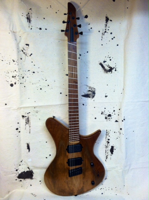

Multi-scale spread is 25" to 26", with the perpendicular fret at the 12th on the walnut fretboard (16" radius). I REALLY like this layout. You don't notice the fret splay at all.

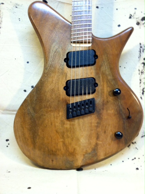

Finish is tung oil over shellac.

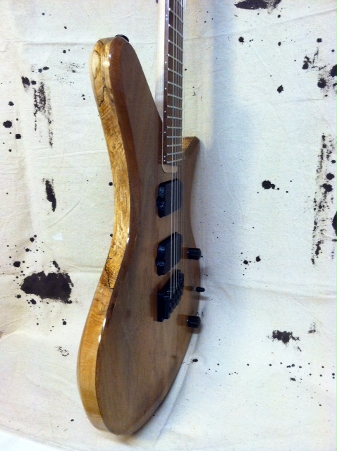

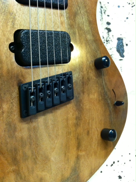

So this shot captures a bunch of cool stuff. First, you might have seen my thread about making templates for accurate reproduction of the bridge plates I designed (viewtopic.php?f=12&t=3934). Well, there is the first product. It's working well. Also, I have thermoformed some custom pickup covers (viewtopic.php?f=12&t=3573). Those are the first products from that adventure. And then, my struggles with the DiMarzio Super Switch (viewtopic.php?f=10&t=3952). I found a diagram that worked for me, but needed to do a little modification to the switch. This is a tall switch, requiring a full 1-3/8" headroom in the control cavity. This guitar is only 1-1/2" thick, so I bent the toggle switch 90 degrees and cut that smiley-face slot for it to run in! It works!

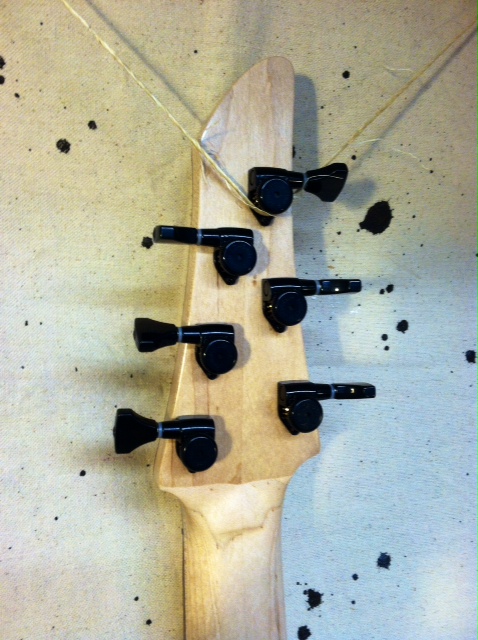

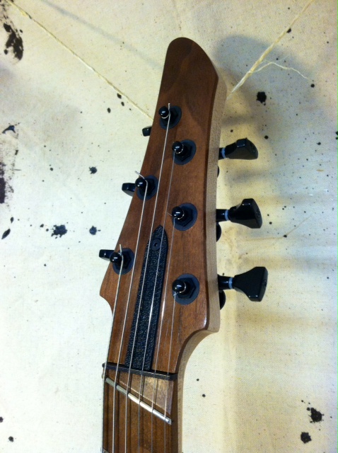

3+3 Hipshot Griplock locking tuners on the head. These are great tuners: smooth, simple action, cool-looking, and affordable. 1/4" carbon fiber tubes in the neck, with a double-action truss rod. The truss rod cover is the same 1/16" black textured ABS that I used for the pickup covers.

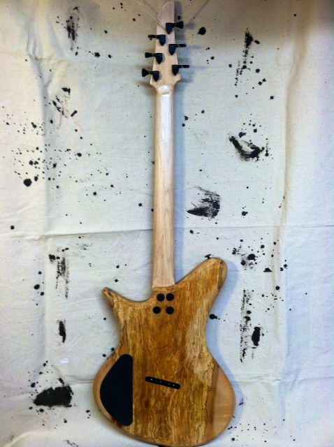

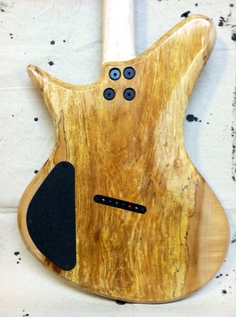

Postby Jason Rodgers » Thu Aug 20, 2015 3:54 pm
This spalt is some cool looking stuff. A challenge to work with, but worth it. Thanks, David!

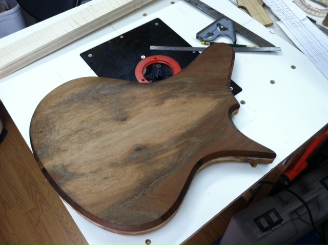

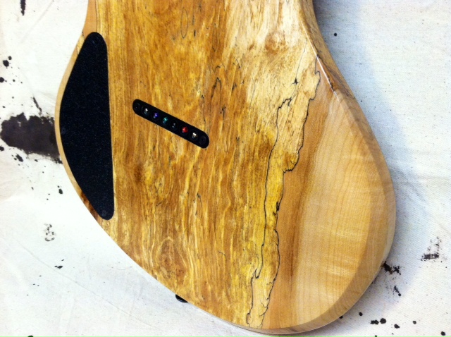

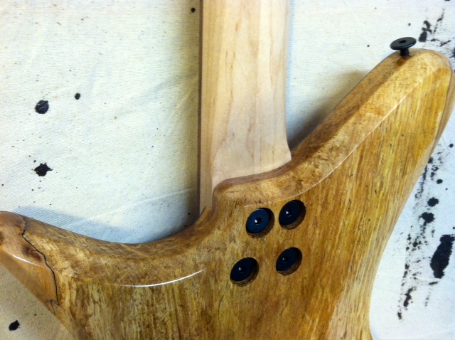

I use hex head hardware that I get at ACE everywhere on the guitar. These are 1/4-20 furniture bolts. I use them on the neck joint and for the strap buttons (wide, flat head, no slipping straps!).
This picture shows how the tree was punky on the inside, with the fungus stripes at the edge of that, and then some perfectly healthy heartwood. Very different densities! Along with the chambering I did, this makes for a light and resonant body. Total weight came in around 6-1/4 pounds.

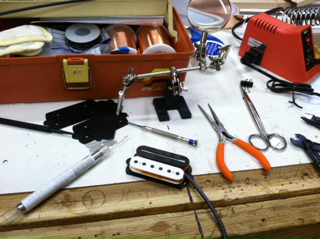

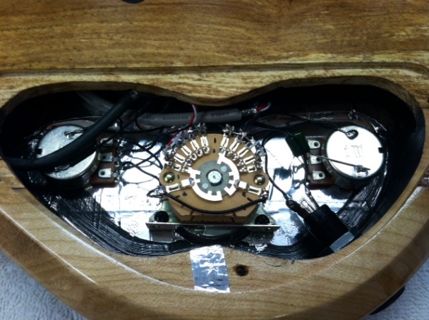

Ok, just a couple more, for the pickup and electronics nerds.
Here is what's inside those pickups. This was TOTALLY an experiment, shooting from the hip. Each pickup has:
- Blade coil, ceramic magnet, 5000 (neck) or 6000 (bridge) turns of 42awg wire.
- Slug coil, neodymium magnet, 5000 (neck) or 6000 (bridge) turns of 43awg wire.
The Super Switch gives me:
1- Bridge
2- Bridge + Neck blade coils
3- Bridge + Neck
4- Bridge + Neck slug coils
5- Neck
They sound pretty good. Both have good string separation. The bridge is pretty edgy and cutting, and the neck is full and warm. Not surprisingly, the isolated blades and slugs have their own distinct sounds: blades alone are very dry, with a stark, crisp tone. The slugs alone have a lot of depth and clarity. I guess another way I would describe it is the blades are sort of 2-dimensional and the slugs are more 3-d (if that makes any sense).
Here is that switch tipped on its side! I'm telling you, it works!

You gave me an idea with the super-switch mounting.... I might have to try making a bit of a pocket in the top of a guitar sometime so I can mount the switch sideways with the lever pointing down as the guitar is held.. Kind of hard to explain but could make for a nice solution as well.
Eric Baack
Posts: 617
Re: Jason's #3: Walnut over spalted maple 6-string
Postby Jason Rodgers » Fri Aug 21, 2015 5:32 pm
Eric Baack wrote:You gave me an idea with the super-switch mounting.... I might have to try making a bit of a pocket in the top of a guitar sometime so I can mount the switch sideways with the lever pointing down as the guitar is held.. Kind of hard to explain but could make for a nice solution as well.
Do you mean the switch lever would protrude from the side of the guitar, or there would be a slight recess where the lever would appear as like a wiper? I can say from this attempt that it switches smoothly, but it would take some getting used to for quick pickup changes. You can't just flick it.
Also, I should mention that had to extend the switch lever by about 1/4". I did this by cutting a little rectangle of similar sheet metal, drilling holes in the lever and extension piece, and peening little lengths of finish nail into the holes. It was all rather delicate work. This was followed up by some good ol' fashioned JB weld. It's holding solid.
I've seen some cool solutions for knob and switch mounting. This was a fun problem to solve.

Pretty much but I'll probably stick with rotary switches. You do nice detail work.
Jason Rodgers wrote:
Eric Baack wrote:You gave me an idea with the super-switch mounting.... I have to try making a bit of a pocket in the top of a guitar sometime so I can mount the switch sideways with the lever pointing down as the guitar is held.. Kind of hard to explain but could make for a nice solution as well.
