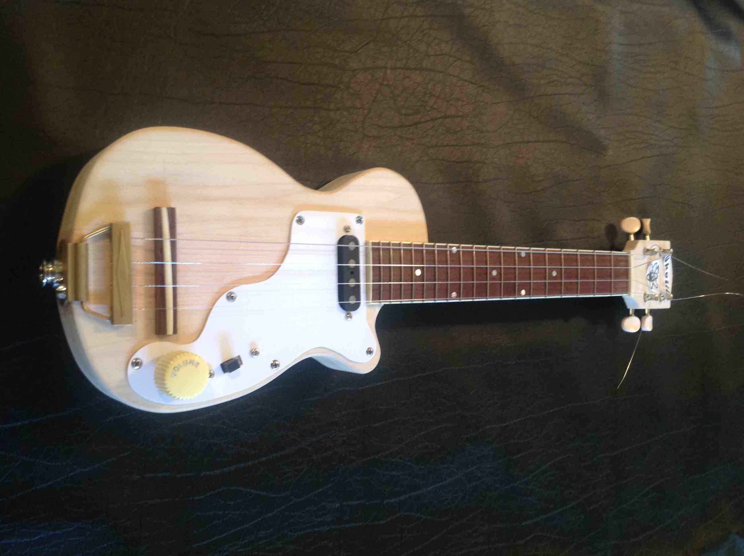

Postby Chad Schmidt » Thu Jul 02, 2015 5:01 pm
I've been waiting until this is complete before posting as a build thread, but since you asked the question…
Here's a concert sized steel string electric ukulele I built for my 4-year old daughter (and yes, it is waaay overkill!). Her name is Lili so I've been calling it the UkuLiLi. Anyway, it's modeled after the Harmony H44, 14.75" scale length, maple through neck, poplar body and head plate, rosewood fingerboard and bridge. I machined all the hardware from brass; there's a pickup cover too that isn't shown. I also machined a custom sized bobbin and wound my own pickup- a first for me! Lastly, I put in an onboard headphone amplifier so the jack output can go either to an amp or directly into a 1/4" headphone plug. I'm happy to share photos of the process- though the bulk of the work was really in the pickup and hardware.

Postby Dan Smith » Thu Jul 02, 2015 10:04 pm
That's great, Chad!
Awesome!
