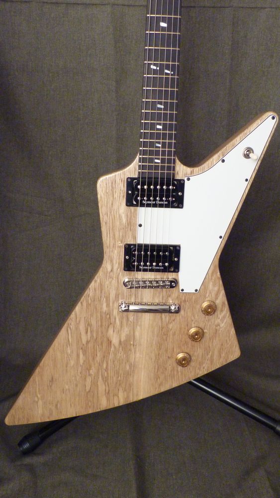

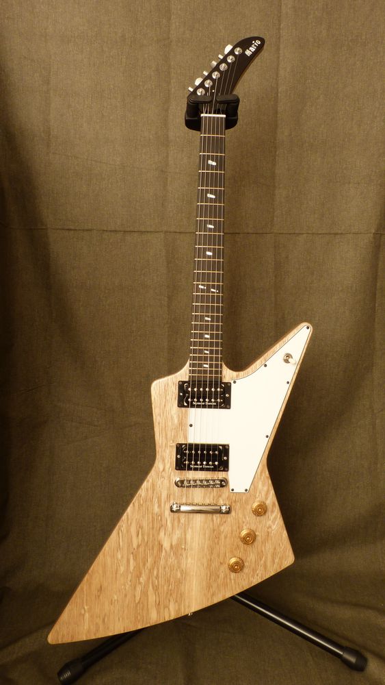

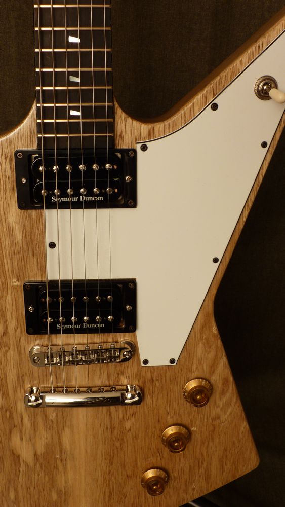

It's been a long time since I posted something here. So here it goes. Finished this baby a week before Christmas. I used Ronald Trigo’s laser cut explorer templates for shaping and routing.
Korina body and neck
Ebony fretboard , 24.562 scale
Seymour Duncan JB at the bridge and Jazz at the neck
Gotoh tune-o-matic bridge and tailpiece
Sperzel locking tuners
Mother of pearl inlays
Bone nut
Plastic pickguard, cavity cover and truss-rod cover
Stainless steel frets
10 coats of Tung oil
The neck has a 1.5° degree angle. It’s depth and width is pretty close to a PRS wide fat neck and I really like the feel of it.
I wasn’t sure about the pickups but a friend of mine had the same kit installed in his Epiphone Les Paul and it sounds really good. So I gave it a shot and I’m really please with what I hear so far
The guitar is surprisingly not that heavy (7.6lbs) and because of its shape is very comfortable in standing position. It was my first time working with korina and found it was pretty easy to work with but it dings and dents like crazy. Anyway, I still have plenty left for another project

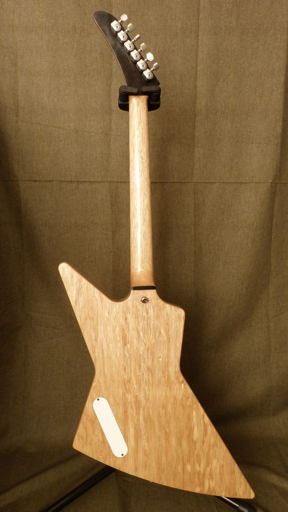

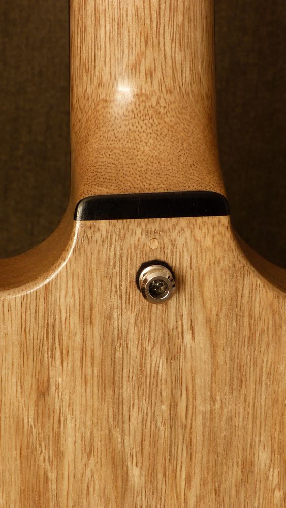

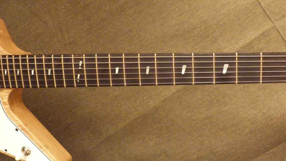

More pictures

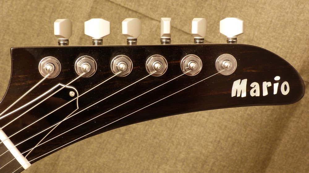

Last one
Ebony headplate and backstrap

I love that heel cap detail!

Regarding the pickups, those two(Seymour Duncan sells them in a boxed set called the "Hot-rodded Humbucker" set)are my absolute favorite pairing for an electric guitar. Really hard to beat, IMHO. Congrats! Nice git!

Nice job! I've never been a fan of that body-style but you certainly did it justice! BTW...regarding your pickup choices, I built a thinline T-type a while back and used a JB in the bridge and a 59 in the neck and I was very pleased with the results. So I'm sure, you'll be happy with your choices.

Those pickups, the more I play them the more I like them. Great sound
