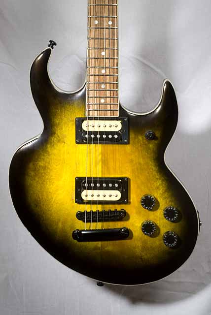

The empress in a full frontal pose

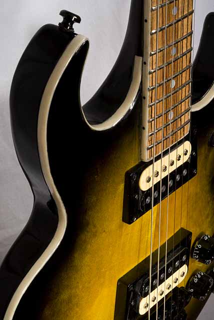

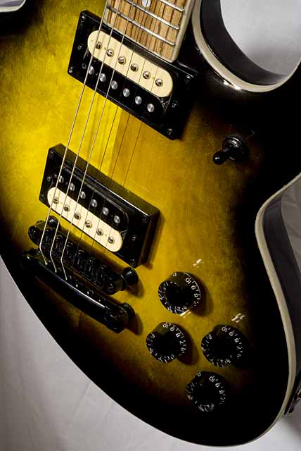

Her body from the front...
... and in a close-up

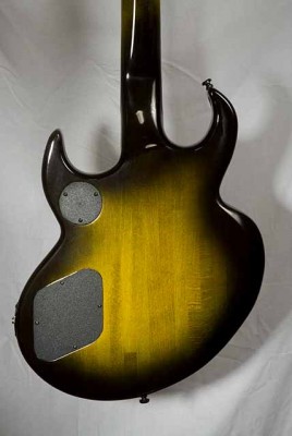

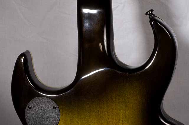

Her sweet rear pose...
...and her body from behind
