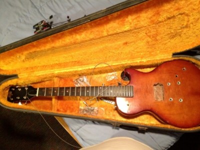

Hi, all! This will be my first build, ever. I am also documenting this build on the ResoHangout forums but I think there are many more active users here so I thought to post my work here as well. I have good math skills and rudimentary (at best) wood working skills. I have never dared to do anything to any of my guitars for fear of destroying them. It took some time to get over the intimidation of ruining the guitar but I have already caused sawdust to fly and feel much more freedom and less pressure.
It's always nice to share but, more importantly, I can hopefully get some feedback on my methods and ideas as I go through this build. I will measure and cut to the best of my neophyte ability however I will be using the TLAR method often!
A quick and dirty rundown:
Guitar: Hondo II Les Paul Jr. (ish)
Year of production: No idea (stick with number on bolt plate "HD990AB" and a stick on the head that says "3021" then "Inspected by" then either "128" or "138")
Cone: National 9.5" biscuit
Neck: bolted
Pickups:
  • GFS P90 (don't know which version),
    Piezo (undecided which or how)
To do (tentative):
  • Route resonator well and pickup cavity
    route out the neck joint cavity so as to move the neck further down as the cone center is 1 3/8" below the original bridge location
    Drill out some hidden cavities in the body to enhance resonation, possibly add some air holes with fancy (cheap) speaker covers
    Install cone
    Figure out how the hell I'm going to wire this thing (so lost...)
    Solder fest
    String it
    Test electronics (also remind self that hair is thinning and ripping it out isn't going to help)
    Test intonation (and inevitably fix it)
    Strip it down
    Remove the paint and sand
    Lacquer it
    Profit (i.e. play it)
Questions:
  • Better to put piezo under bridge or on cone? I want a good resonator sound
    Piezo: how the hell to do it (hand made with varitone or $10 Ebay preamp)
    Paint or clearcoat? The wood covers are pretty quilted, might go au natural
    Is the plane in the neck joint level with the top/back? If not how the hell will I replicate that angle (which I can't even measure)
    How moveable is the biscuit bridge? Since it's on a circular base I assume it can be rotated but can it be slid forward and backward?
    Need to see the shape of cone before routing to see which part is 9.5", the lip or the inside of the lip
    Should I route the cone well all the way through the body as Keith Hosterberg did on his "Black Cat Bone"? I don't much like the aesthetics of the back cover plate
    Can I adjust neck angle with shims?
    Should I sand the black paint off the fretboard?
    P90 pickup has 3 wires and I don't know which wire is which (red, white, bare copper)
    Can I strip the paint, use regular wood stain, and cover it with polyurethane rather than lacquer?
Notes:
  • Entire guitar is beaten but sound; needs to be refinished
    Fretboard seems to have been painted black, assume is rosewood
    Neck binding isn't binding at all but instead just black paint
    The head is extremely heavy; balances about 2-3" below the nut, even though the rest of the neck is thicker and wider
    Body weighs a ton
    Don't know how to check if the P90 pickup is in working order: need to find multimeter
Inspiration:
http://youtu.be/J6XXFPvIU_M
http://youtu.be/v4uNHp-Lzl0
http://youtu.be/VTZw2v8hENc
My thread on Reso Hangout forums:
http://www.resohangout.com/topic/29602
Now, onward!
Last edited by Justin Pruitt on Sat Aug 18, 2012 12:44 am, edited 1 time in total.

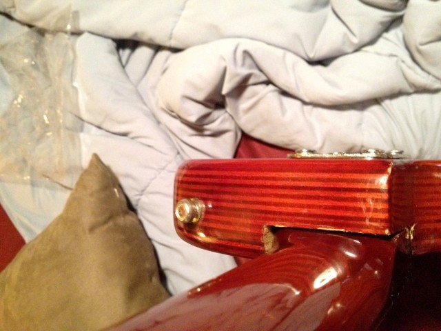

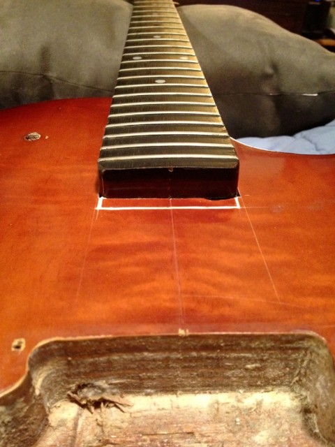

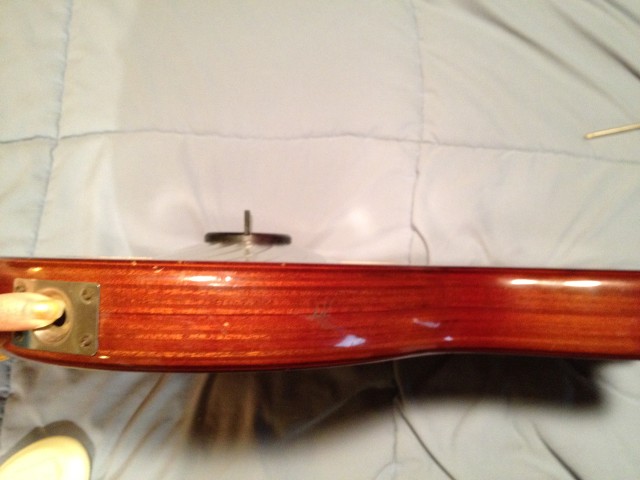

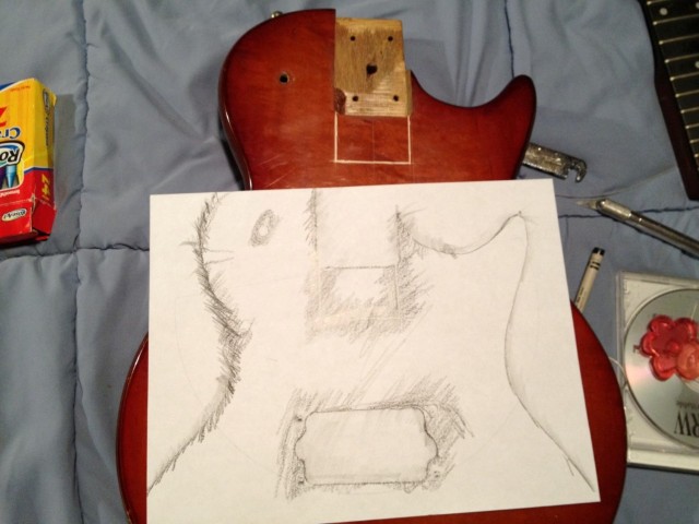

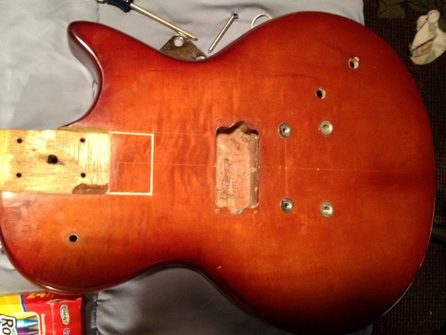

Here's the body all marked up. I used a hobby knife to finely etch the lacquer on the body to find the center line, bridge placement, etc. I also marked the neck where it met the body.
Body 2
Body 2
Body1
Body1
Hondo II as received

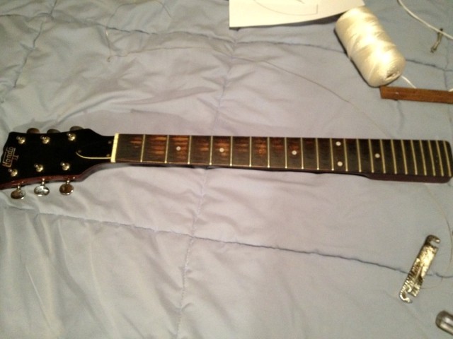

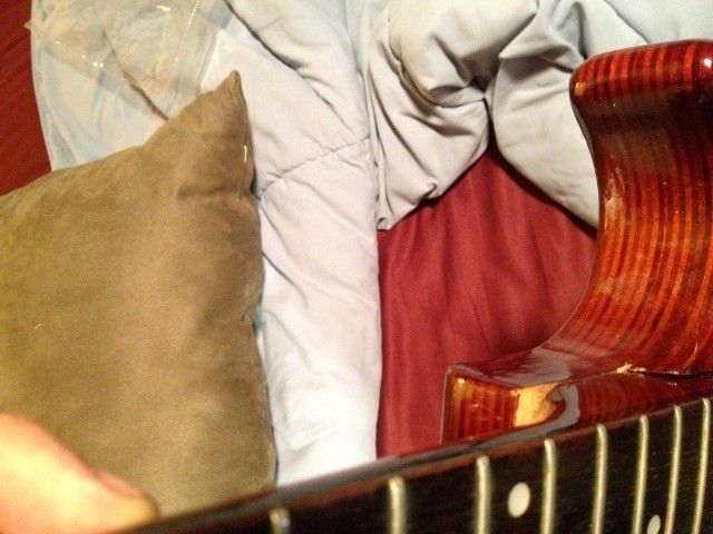

There's the neck right after I took it off of the guitar.
I needed to make a template for routing so I needed to find some way of getting what was on the guitar body onto a piece of plywood. Due to my laziness, I didn't really desire to painstakingly measure every component in relation to some arbitrary axis (which would also introduce a lot of error) so I decided to make the lines very deep and, using a piece of paper and a black crayon, make a rubbing of the guitar face. It worked perfectly.
Original neck as removed
Finished template
Finished template
Rubbing the template

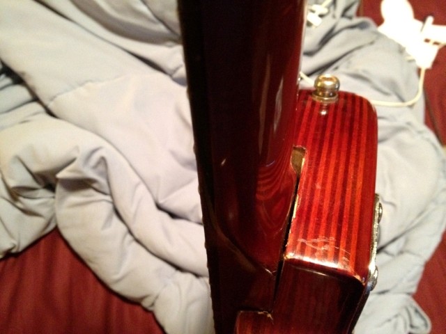

I didn't get any pictures but I was able to make the plywood template based upon the paper rubbing I made. I drilled out the holes for the bridge poles and used them, along with the hole for a switch/knob in the top left of the guitar body, to align the template correctly. The routing came out ok. The routing bit I used was cutting the same diameter as the rod that goes into the router so there was no washer. I don't know if this caused a bit of heat but for some reason, in one corner, it cut into the template leaving a dip. I plan to fill it with wood filler, later, and try to hide it.

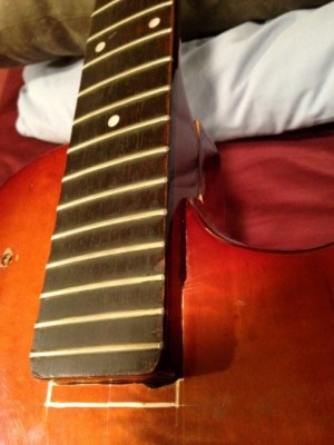

You can see from the scratch I made earlier that the neck doesn't meet the body at the same angle it did before. I routed parallel to the guitar face at 9/16" deep but neglected to take into account that it was originally installed at an angle. Using this scratched line, I will measure the angle and put it into the new neck joint plane with a wood chisel.
The white line below the neck is my original "to be routed" area. However, after consideration, I decided to not move the neck down so far. The idea was to put in some compensation due to the fact that the original bridge was about 1/8" short of the scale length (which is 24 3/4") and that the action will likely be higher than the original action.
Justin Pruitt
Posts: 19
Joined: Sat Aug 18, 2012 12:11 am
Re: My first build: Solid electric to electric resonator conversion
Post by Justin Pruitt »
Originally, the neck was square where it was within the body and at the body's edge is where they began the neck shaping. Since I've moved the neck down quite a bit, the shaping now enters the body cavity. I'm considering either filing/sanding the body down to meet the neck smoothly or simply routing that much of the body off. Would love to hear your suggestions.
Next step will be to wait for the resonator cone to arrive so that I can figure out how it will install in the body. It's just been shipped today so it will be awhile. I'm considering removing all of the finish/paint from the guitar. The wood cover is quilted maple which looks good. I'm thinking I can lightly stain it and then simply cover it with some polyurethane (NOT polycrylic!). What are your thoughts on that? I considered using this project to learn how to lacquer however finding a dust free area where I live is IMPOSSIBLE.

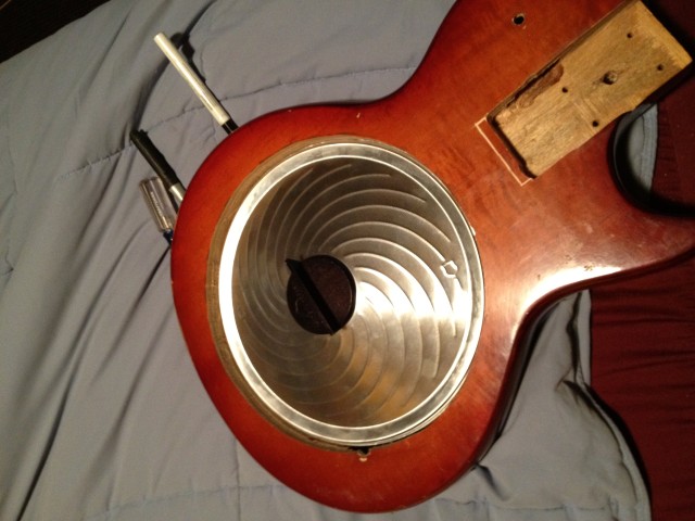

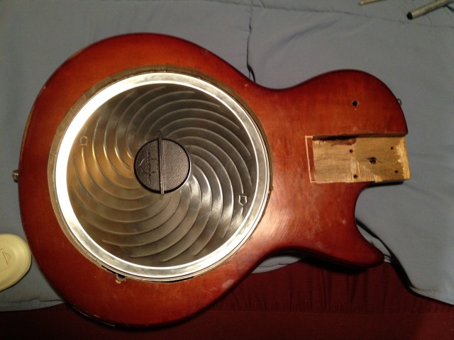

Well, I've routed the cone well and it seems to have come out well. It's a perfect fit! Measure's ok, too, but I'll have to wait for my tailpiece to arrive and have the nut carved before knowing how the intonation is. I also want to route out the inside some more and find a way to allow the air to escape.
Justin Pruitt
Posts: 19
The bridge currently sticks out about 1", as predicted. I will get the bridge carved to match the fret board radius and dips for the strings to go in. After that, and after my tailpiece arrives, I can check neck angle and then intonation. I don't know how much the cone will settle while under the tension of the strings so I'll let it sit a week before deciding whether the bridge is too high.
Thanks, Mark! I had considered that although I wasn't sure I could get my neck perfectly flat as it's supposed to be. The reason is that it's 30 years old and the frets are pretty worn down. Can't hurt to look, right?
I'll use your tip and give it a check!
I will still wait until it's strung before making a decision, however. I don't know how much the cone will settle or go down until it's strung.
Freeman Keller
Posts: 494
Post by Freeman Keller »
Sweet - looks like it was made to have a cone. Carry on.
Justin Pruitt
Posts: 19
Used a straight edge from the neck and it just hit the base of the biscuit. The bridge is 5/8" tall and its center is 24 13/16" from the nut (putting it 1/16" past the scale length). It's about 1/32" shorter than where I wanted it but after sanding the cone well it should be able to move back that much. I have 5/8" of bridge height so plenty of room for adjustment. I could probably route the cone well another 1/4" deeper but I'm going to carve the bridge and see what happens. Perhaps I will only need to carve an extra 1/8" off the bridge and increase the neck angle to have good action. On the other hand, the cone stand well past the front of the guitar (est 5/8") which may make fashioning a cover plate more difficult.
One other area of concern is where the original electronics went. Their previous location was partially where the current cone well is. Because of this, there is an area (circumference length est. around 4 inches) for which the cone rim is unsupported. With a 9.5" diameter, that's around 13.4% of the cone rim unsupported. I worry that this will cause the cone to fail in the future; what do you think?
Too bad, you should have made a wood piece to glue in there before you routed, and then you would have had a perfect section in there to support it over that span. Right now, I'd see if I could build a piece like that in and then re-route it to fit. After that you can figure out where the new electronics will fit in, but first you'd need to give the cone a full support. That's my opinion, others might say that you could leave it as-is but I'd feel better with it supported.
Justin Pruitt
Posts: 19
I shaped a piece of plywood that would fit the cavity and will glue that in place before stringing. It only took a few minutes, no big deal although it was nothing but curves hah. Chisled the neck joint of the body down a bit to increase the angle by about 2 degrees (which is about 1 degree more than original). Once I finish sanding the cone well, I'll fit it together and check that it all matches up. Tailpiece is in Indianapolis so it should be here in a couple of days.
