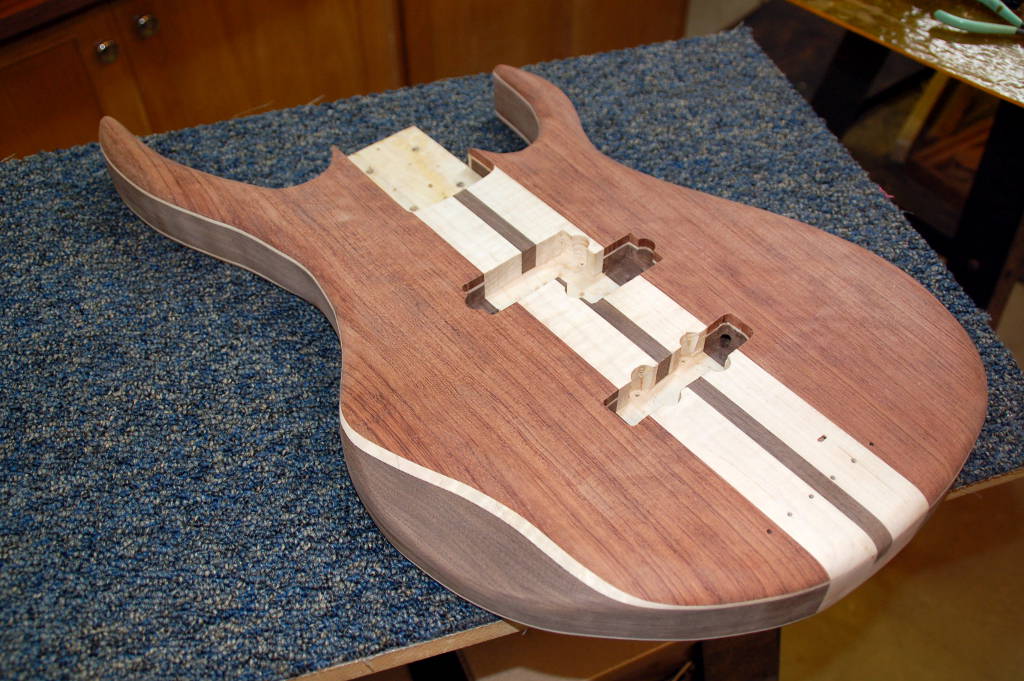

I am getting into the finishing phase of my project and I thought I had a plan until I read something in another thread.
The body is bubinga, maple and walnut. My plan is to pore fill with shellac and then sand back to bare wood leaving the shellac just in the pores of the bubinga and walnut. I would think the maple shouldn't retain anything and sand right back to wood. After that come brushing lacquer (don't have a spray booth) with the requisite wet sanding using a progression of micro-mesh all the way down to 12,000 to get the mirror gloss.
Where my question comes in is the sanding of the shellac back down to wood. My plan was to sand down using 400 grit to prep for the lacquer. I just read a post in another thread that said:
"I usually sand to 400 or even 600 grit before the oil goes on, that may be too smooth for lacquer to stick, but it works fine for TruOil or Rockhard Tabletop varnish."
Now I'm concerned that I'm going too far with the 400 grit under the lacquer. Should I stop at 220? Your thoughts?
Here's how the body is constructed.

400 is a good grit to sand the shellac sealer coats. Shellac by itself isn't that great of a filler of the pores but it'll help some. You can expect that grit to sand through the shellac in spots, depending on how thick you put it on and how much you sand. Much of the shellac will soak into the wood for a few coats.
I don't agree with the statement you quoted. You can put lacquer over as smooth of a surface as you want, because it "burns in". That means it will melt the surface of the basecoat and bind with it. If you have a clean shellac surface, the lacquer will surely stick, in fact melt into it and it'll be fine. Because of that same reason, there is no reason to sand any finer than 400.

Postby Chuck Raudonis » Sun Jul 08, 2012 3:03 pm
My intent is to sand the shellac down to bare wood and just leave the low spots (the pores) filled with shellac. If I do that, there won't be any shellac there for the "burn in" to lock on to. Thus the question about is 400 too smooth.

Postby Greg Robinson » Sun Jul 08, 2012 3:30 pm
Hi Chuck, I think Mark might be on the same page with me here, but I believe that a good quality finish starts with a chemical bond, rather than a mechanical one. The idea that a finish will not stick to a highly polished surface I think comes from people who have left too long between prep sanding and laying on finish, which allows the surface to oxidize, and reduces "surface energy". If the finish is layed on within 10-15 minutes of sanding (ideally), I think it will stick to any sanded surface. It is widely accepted around here that the best glue joints are fresh, and are as smooth as possible (scraped preferred). I believe the same principles apply to finishes.

Postby Mark Swanson » Sun Jul 08, 2012 6:19 pm
Chuck, you're worrying too much and overthinking it. First, it will be almost impossible to sand the shellac and stop right at the point where it's just in the pores. It's easy to open up new pores if you are down to the wood, which will happen in some spots while in others there'll be patches of shellac. It would be better to leave a thickness of shellac to use as a basecoat and not sand down to the wood. And I can tell you that even if you do that you'll still see pores after the lacquer goes on. The lacquer will burn in, and shrink down into the wood and the pores as it cures. Shellac makes a great sealer but a poor filler of the pores all by itself.
If you sand with 400 down to the wood, it will not be too smooth. The lacquer will soak into the wood as it dries.
All you have to do is not worry about this, it's a non-issue. Just go ahead and lay down a good shellac coat - and some just start with the lacquer alone on the bare wood, which is ok too- and then go with the final coats of lacquer. It'll be fine.

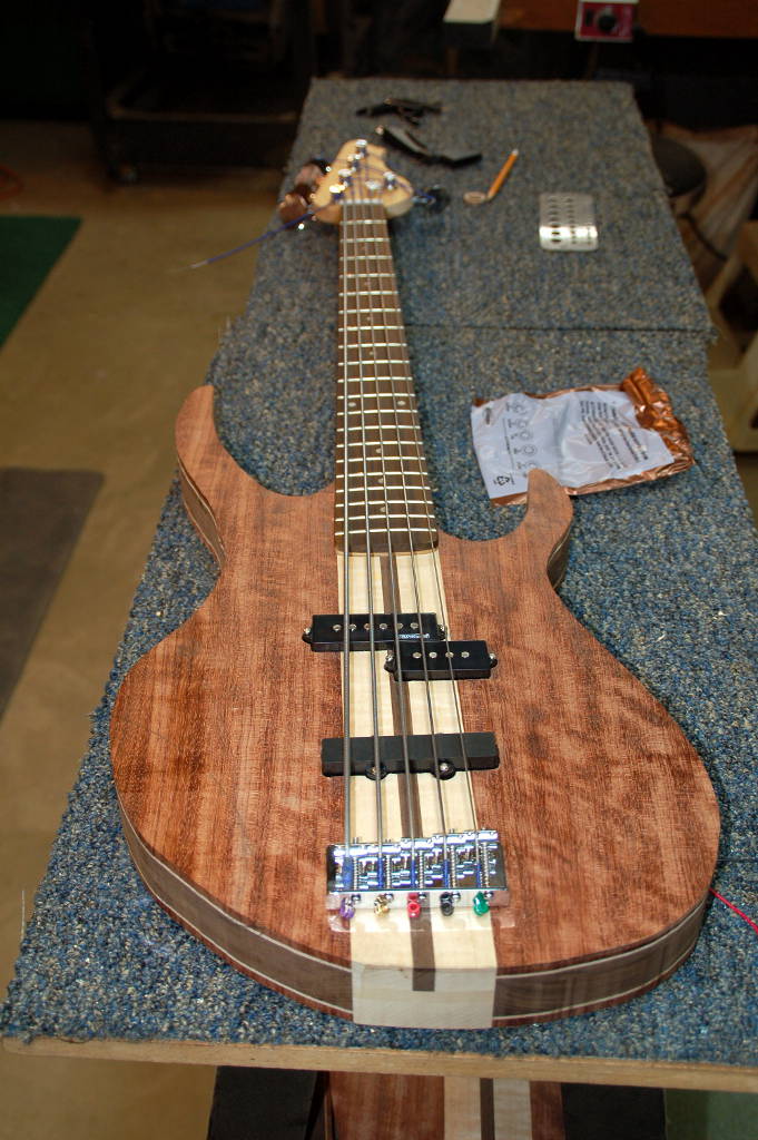

I really like building furniture, but this is so much more enjoyable to pick up and play what you built. I did a test assembly a little while back just to make sure everything was lining up while the body was still "In the square" before I invested the time in shaping the body. I wanted to check the action, make sure the strings were lining up on the neck, make sure the pickups were working, etc. I couldn't put it down for a couple of hours. I just thumped on it even though is was unbelievably uncomfortable to play due to the sharp edges and the fact that I didn't have strap buttons on it. I had a blast. Even more excited because it was truly mine from the ground up. Here is a pic of the test assembly.
Thanks again. I'm sure I'll be bugging you again.
