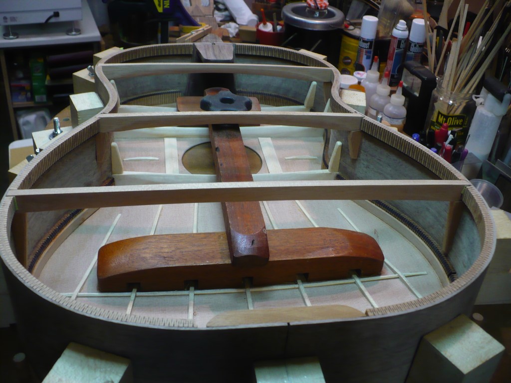

This may be laziness on my part, but I just love the A-4 Kerfing that Ryan sells. It's laser cut, bends in every direction and looks great. The only weakness I've found with it is that it is somewhat brittle, so has to be handled with some care. I do stiffen in the lower bout against the top with an outside/inside layer of something - usually Spanish Cedar - not because I feel it isn't stiff, but because I think an added bit of stiffness at the top join gives better projection.
