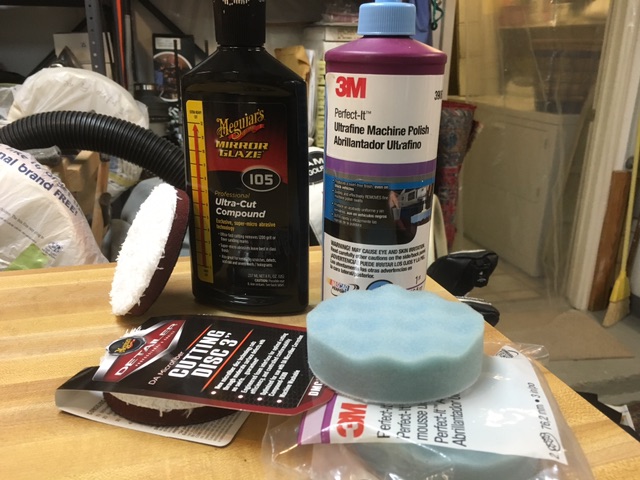

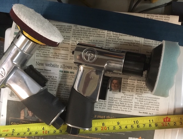

I can't tell you what speed I am using because its an unusual setup. The pads are small diameter (from 2 to 3" in diameter) and the pneumatic tools are mini-air tools with a top rated speed of 2500 rpm, but the variable speed trigger is not always run full open. The two tools in the photo run differently. One is a true or simple rotary but the other is a random orbital (ROS) or what the auto guys call "dual-action (DA)". Some of the automotive compounds work better with one or the other but some will work with either.
There are a lot opinions online regarding favorite compounds and/or complete systems of polishing products. After a lot of reading I saw a few compounds get repeat positive reviews. The one I settled on was Maguire's #105 Ultra-Cut Compound which starts with a heavy cut but it polishes down to a high gloss. And it works with either DA or rotary.
Another interesting product is microfiber pads for use in powered buffers. The microfiber works best for more aggressive buffing (like the #105). If additional gloss is needed then follow up with a swirl remover on a soft foam pad. The 3M Perfect-It Ultra-fine Machine Polish and matching soft, blue foam pads gives a great final polish. Residue cleanup is also good with a slightly damp microfiber cloth. So far this combo is working pretty well.
