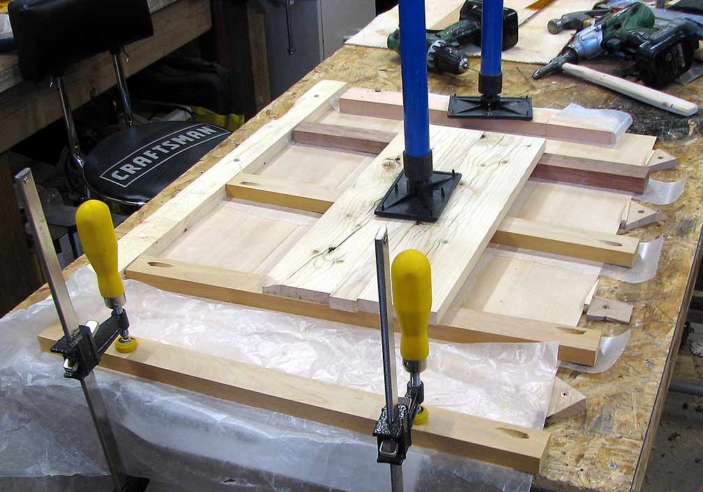

Postby Peter Wilcox » Sat Apr 28, 2012 7:22 pm
Gluing the top.

Postby Steven Wilson » Sun Apr 29, 2012 3:44 pm
Wow. That's the most elaborate clamping system I've seen for a top. Looks good.

Postby Peter Wilcox » Sun Apr 29, 2012 4:19 pm
Steven Wilson wrote:Wow. That's the most elaborate clamping system I've seen for a top. Looks good.
Steven
:) Yes, I know it was huge overkill, but since it is a four piece top, and it's 31" X 21", and only 1/8" thick, I wanted to make sure it stayed flat against the bench, and that it wouldn't buckle.
