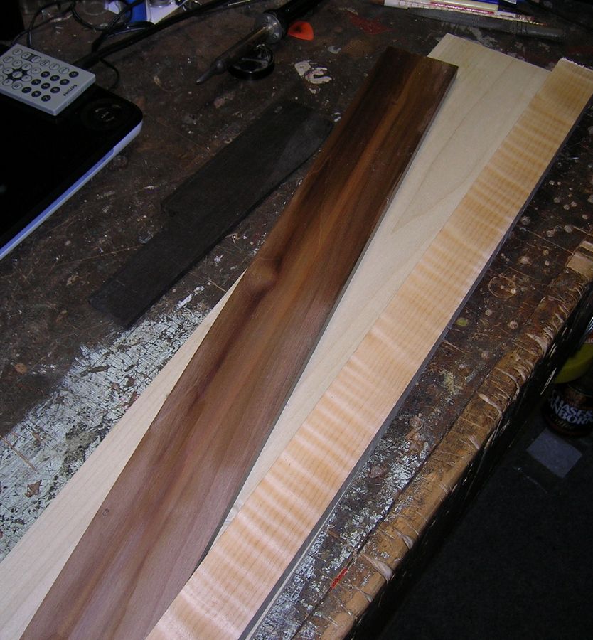

For my next build I'm going to attempt to make a Japanese gottan. The gottan is the poor mans shamisen, a three string banjo like instrument. The gottan differs in that it has a wooden head instead of one made out of cat skin. I will be making it out of poplar and maple from the Depot, and some other scraps I have laying around. And no masonite, plastic, or fabric!
poplar, maple, and ebony scrap

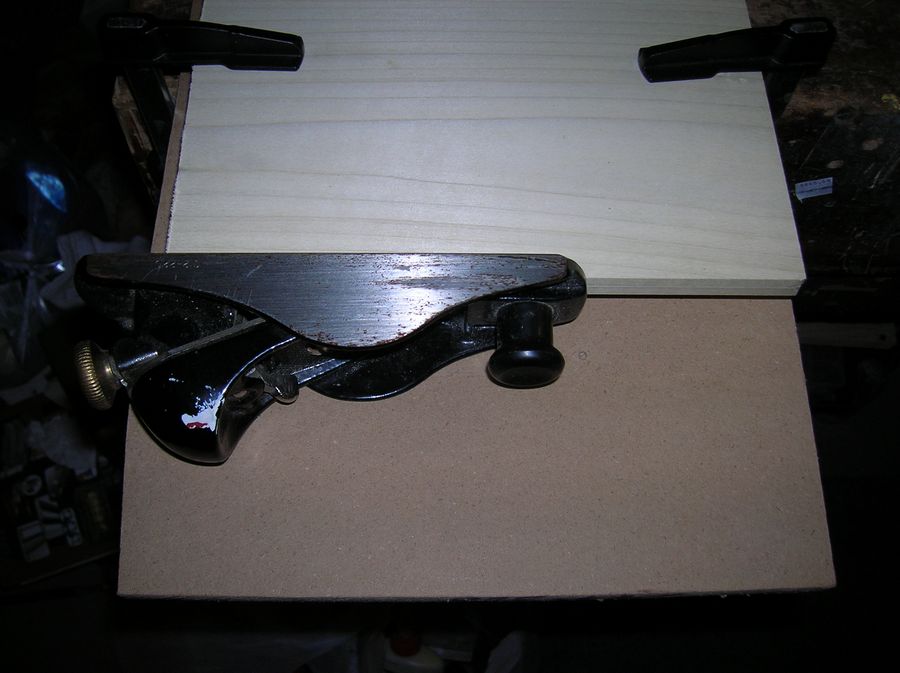

I got some work done yesterday, After squaring up the edges on the shooting board I glued the top plate together.
squaring up the top on the shooting board
top plate glue up

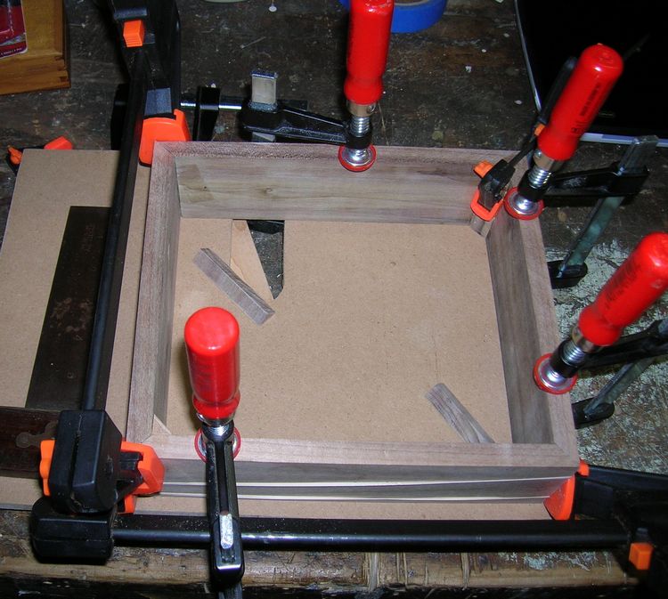

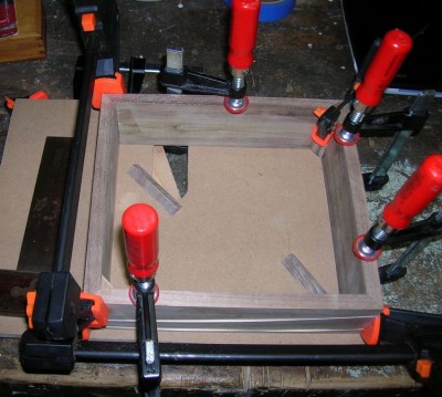

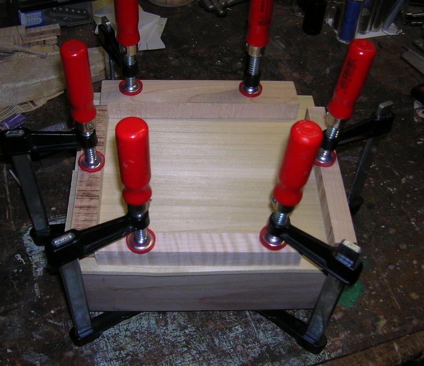

Then I cut the body sides out, beveled the ends and started to glue it together. The body is 8x9", just enough to get from one 3 foot long poplar 1x3. This is the darkest piece of poplar I've seen, almost purple in places.
body dry fit
glueing up the body

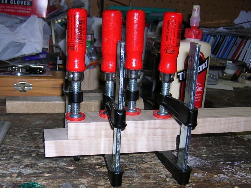

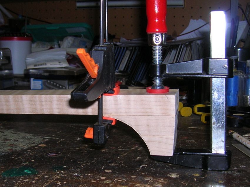

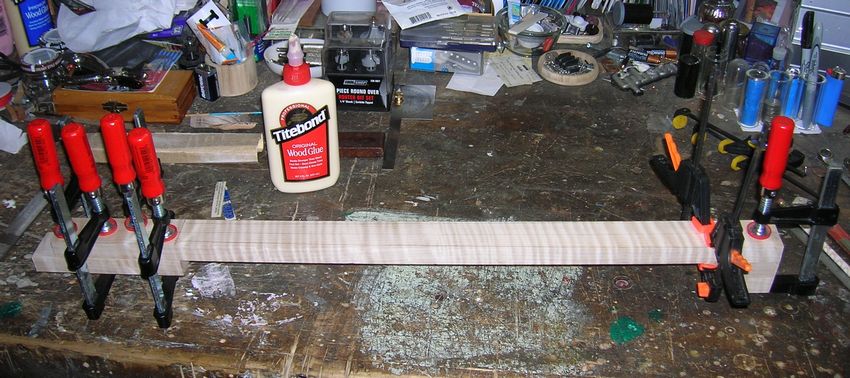

A little more done today. I cut the blanks out for the neck, heel, and peg box and glued them up.
neck blank
peg box
heel

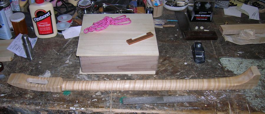

Some more progress to report. I finished shapeing the neck and peg box today. It took longer than usual because I had to stop frequently due to the nerve damage I suffered recently. Rapid repitative motions like sanding and filing cause my arms to sieze up so I have to stop and let the nerves calm down before I can continue. I also cut a piece of bone for the bridge and found a little piece of cherry to use as the base of the bridge. The pink knot is the neo (tailpiece). I found a video on YouTube showing how to tie it but it still took six tries to get it right (big clumsy fingers, tight spaces). I've sent for some real shamisen strings but I don't know if they will get here in time. The shamisen strings are made of spun silk but the book says you can use classical guitar strings and get good results so that is what I mighyt have to do.

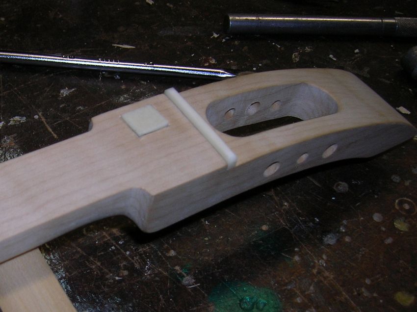

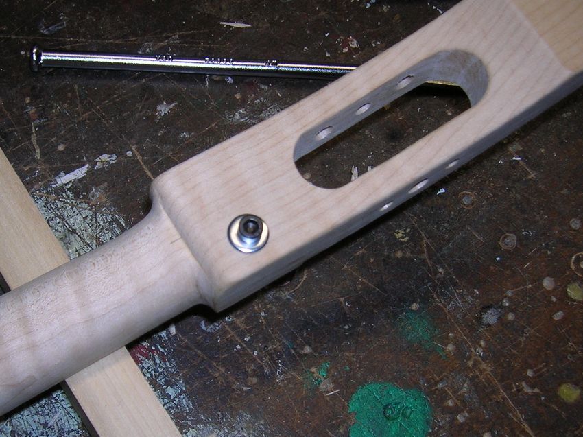

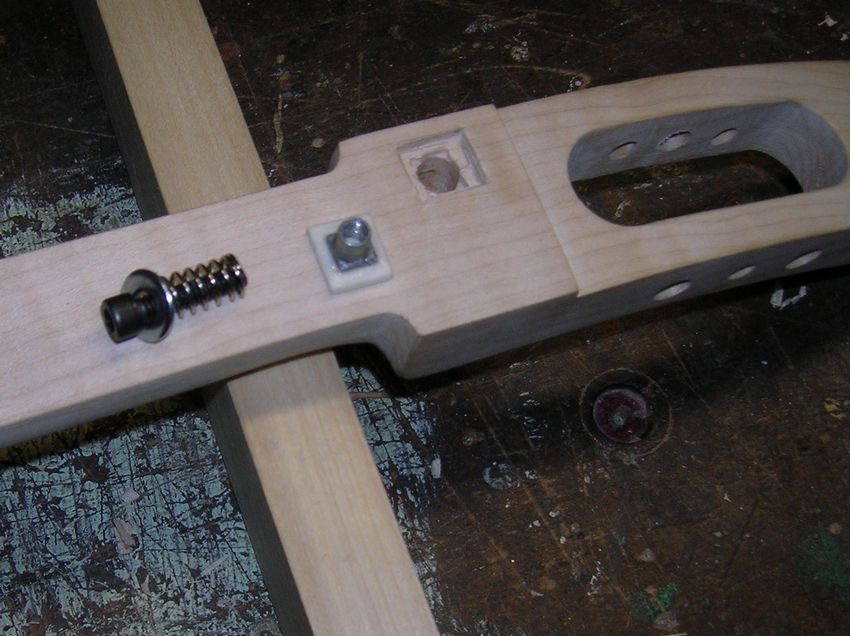

I also made the azuma sawari. This is a device that sits under the lowest string and is adjustable to get a buzzing sound from the open string, kinda like a sitar.
I used a small tee nut, cut down and glued to a piece of bone left over from a saddle blank (I never throw any bone pieces away, they come in handy sometimes). This is secured by a cap screw and a spring set into the neck. By loosening the screw the bone raises up towards the string and you can get the desired amount of buzz. This is useful for some types of songs.
azuma sawari top view

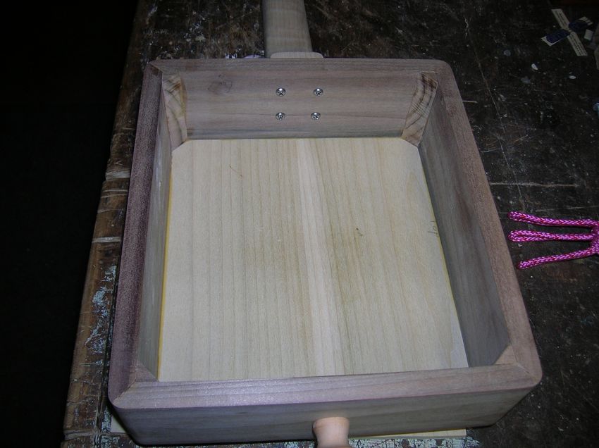

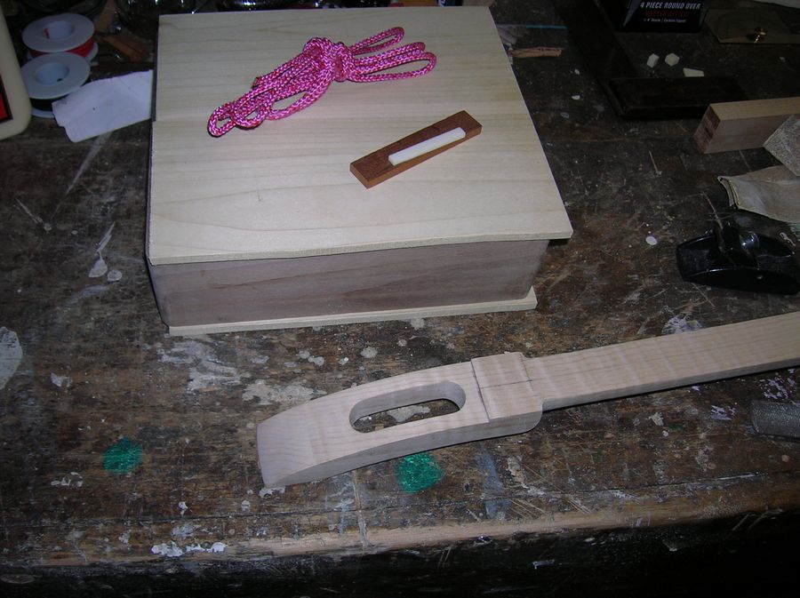

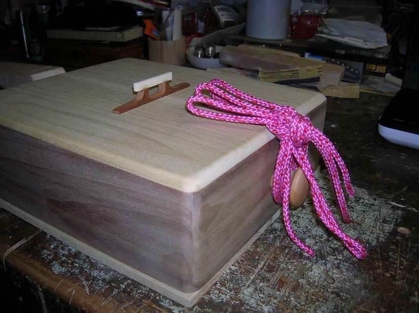

Today I attached the neck to the body. I used 4 #6x1" screws to bolt it on. A shamisen has a dowel stick much like a banjo but a gottan does not and usually the neck is just screwed on.

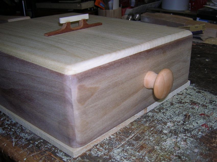

To attach the neo (tailpiece) I used a maple drawer pull, an extra from our kitchen remodel of several years ago. On a shamisen it would be looped over the end of the dowel stick. I think this looks good and it works.
The bridge is made from a scrap of cherry and a piece of bone that was left after cutting a nut blank down.
neck bolted on
drawer pull end pin
body with bridge and neo

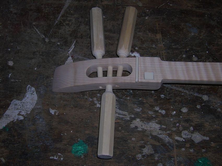

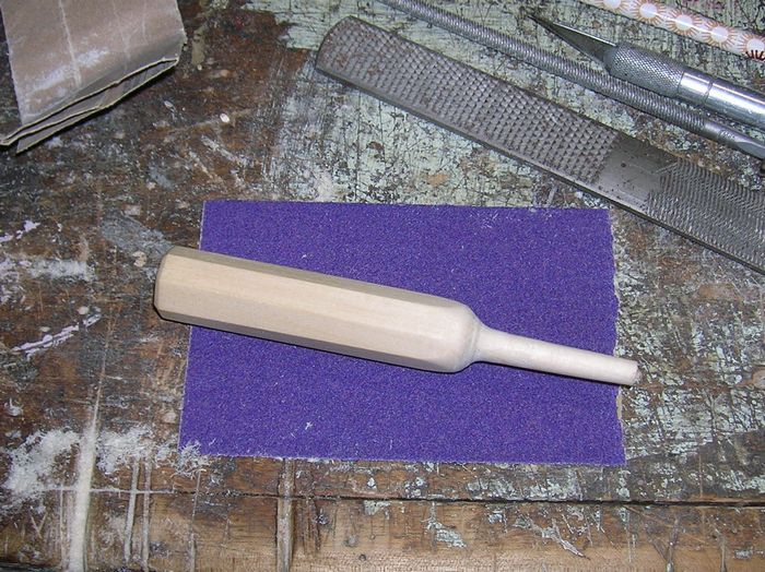

So today I started the part I've been dreading, making the itomaki (tuning pegs). After last years rebec I swore I would never make another tuning peg by hand but the itomaki just don't look like any other peg.
I tried some ot the maple I had left from the neck but that just wasn't going to work with my nerve problems (too hard to carve). I found a 3/4" square basswood (I think) dowel in the wood pile and this was much easier to carve. So after about 4 hours of whittleing, filing, and sanding I've got one done. Only two more to go!

Postby david frassetto » Fri May 04, 2012 2:20 pm
And then there were three! Onward to the finishing.
Ready for final sanding

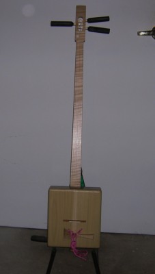

Well I'm calling this one done!!

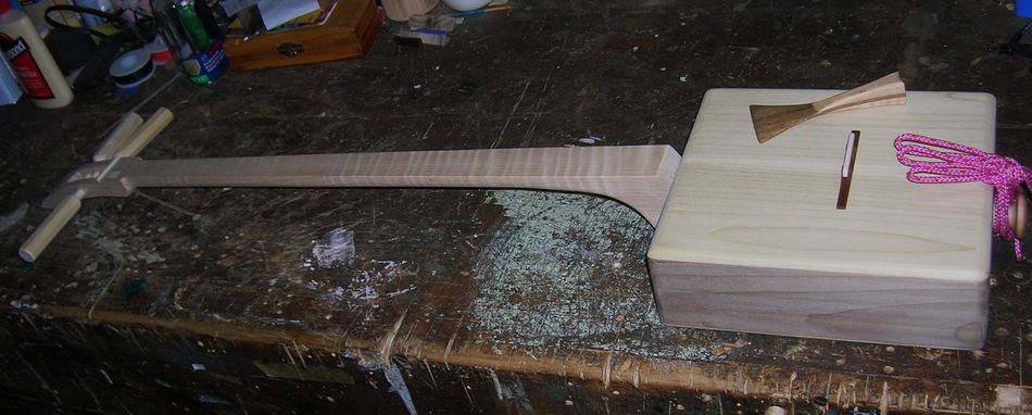

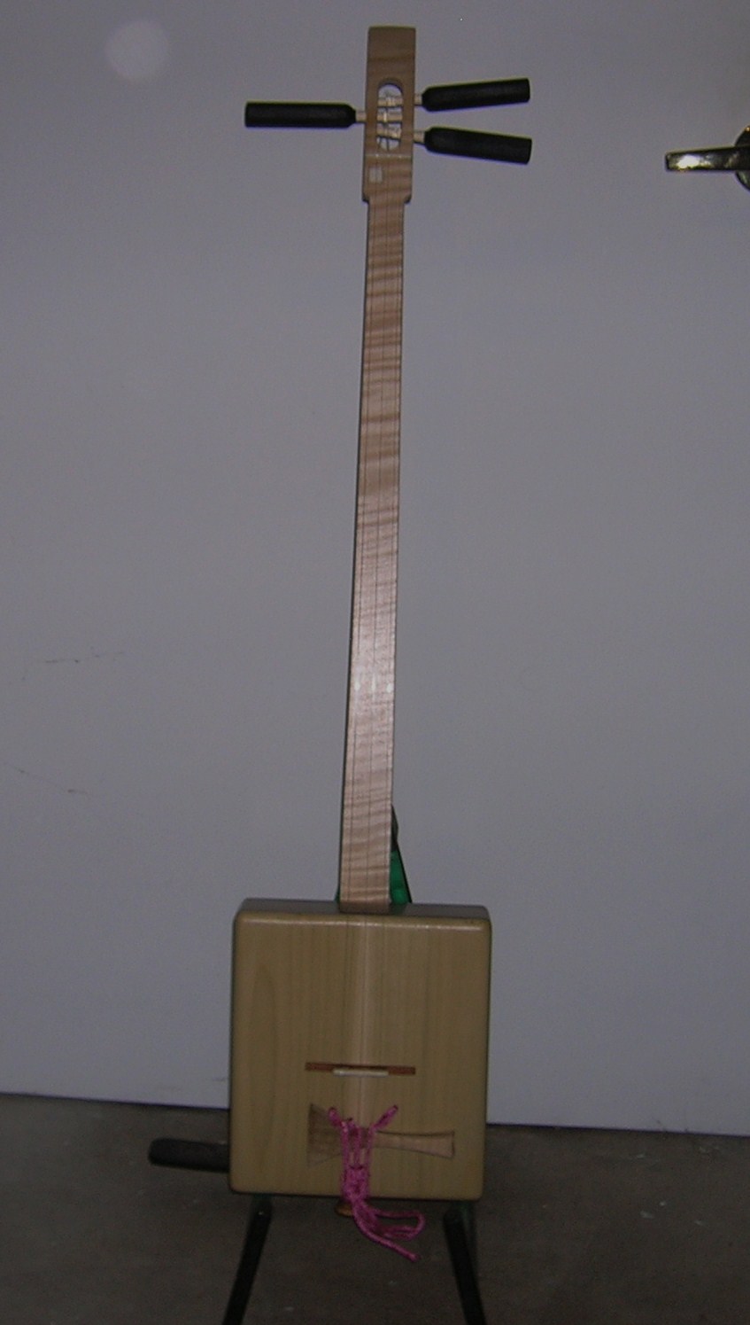

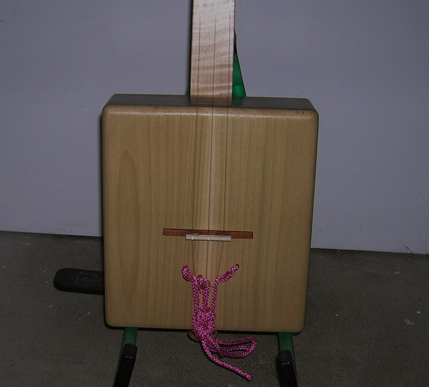

Here are a few more shots.
The body. The strings are from a classical guiter set.and are tied to the neo (pink knot). I found a video on you tube showing how to do it.

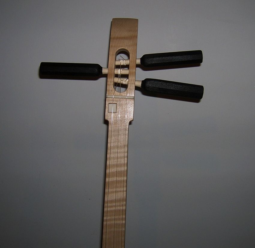

The head stock. I painted the itomaki (tuning pegs) matte black. On a shamisen they would be made out of a dark hardwood and I didn't like them white.
