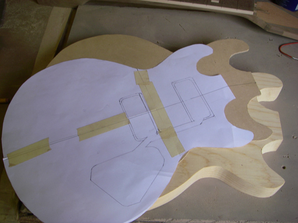

Now I am back to the body. I made a paper templet to transfer the location of the pickups, and channels for the wire.
Patrick DeGreve
Posts: 308
Re: $100 Local Materials Challenge,Patrick DeGreve's Pine walnut Les Paul Jr.
Postby Patrick DeGreve » Mon May 14, 2012 3:27 pm
Then I cut the 1/4' MDF to use a a routing guide.

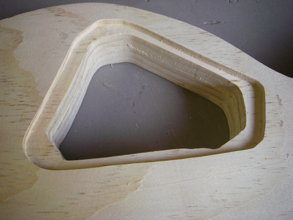

Here is a pict of the body after the route. I made the recess for the P-90s deeper than I think I will need at the sugestion of a friend, who told me that I should add shims later to get the height right after the bridge is installed.

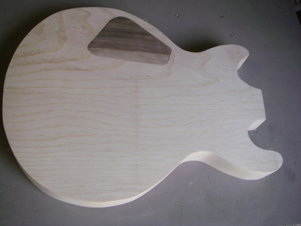

I did the same thing for the access panel on the back. I made a templet, and then routed a recess for the walnut cover plate.
Patrick DeGreve
Posts: 308
Postby Patrick DeGreve » Mon May 14, 2012 3:34 pm
I then cut a plate from the walnut.

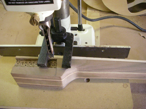

I am using a set of plans for the Les Paul that has a carved top. I am not going to carve the top, so I had to re-figure the neck angle. I made a full size layout on butcher paper, and used two straight edges to find the right angle for the action. In this case 2 degrees seemed to be right. Then using a hollow chistle morticer, I drilled a recess on the neck block to create the tenon of the neck.

I posted the wrong picture on the last post. Here is the picture of the morticer. I then routed the mortice in the body for the neck (previous picture).

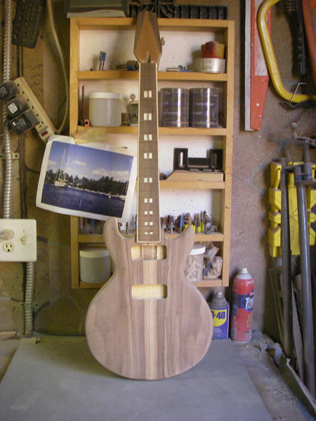

And here is a shot from the front. I am getting close. I am not sure I wil make the deadline, but I am going to try. This is my first electric, and I am having fun just holding it. I am glad I decided to join the challenge.

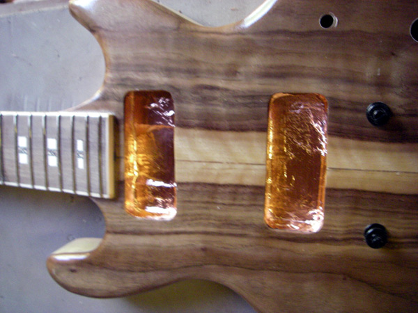

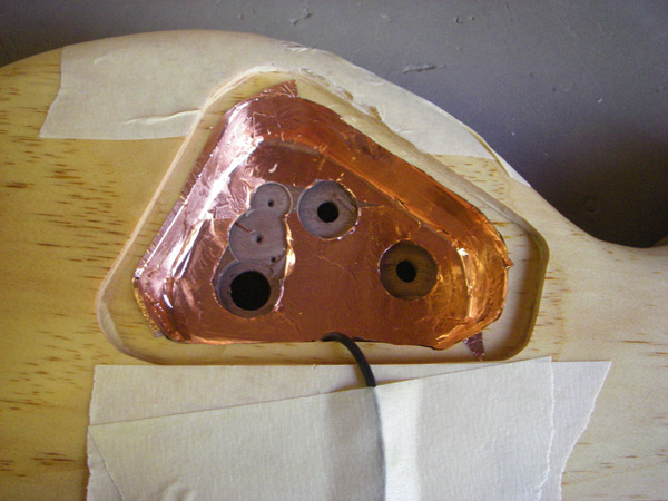

I finished last night! I have got a bunch of pictures to post, but she's done. I am very happy! I put D'Addario 010-046 strings in it and it plays great. I love how easy it is to set the action with the tune o matic bridge. The best part for me was that my Rogue amp has an earphone out, so I can play late at night without bothering anybody. I played last night until about 1;00 am. I couldn't put it down. Here are some pictures of what I did in the last couple of days. The first is a shot of the control recess area, I applied copper tape to shield the cavity.

I did the same thing for the pickup recess.

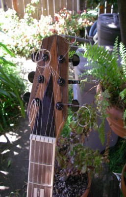

Here are a few shots of the finished Les Paul. First a shot of the peghead. The trussrod plate is just double faced taped on for now, I have to get some sm black screws.

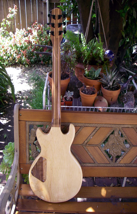

Here is a shot of the back.
