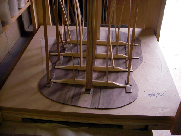

Postby Patrick DeGreve » Fri Apr 20, 2012 11:59 pm

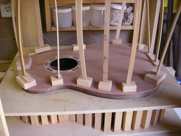

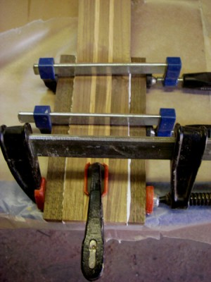

Next I glued up the back, on a 15 foot radius disk. I think I mis-spoke on an earlier post when I said I glued the soundboard on a 15 foot disk, when in fact I glued the soundboard on a 25 foot radius disk. I also glued small strips on the seams, with the grain running perendicular to the grain of the back.

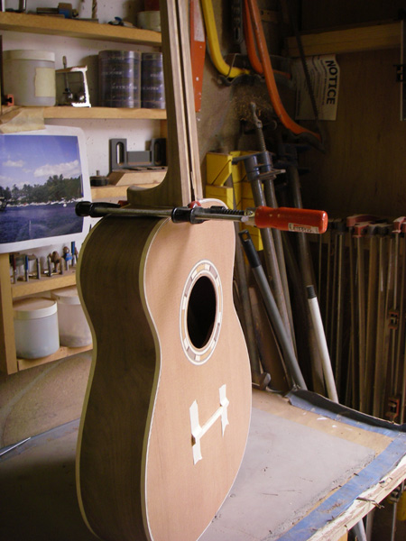

Re: $100 Local Materials Challenge, California redwood, walnut OM
Postby Patrick DeGreve » Sat Apr 21, 2012 12:10 am
I put the sides in the form to hold it's shape, and glued the soundboard onto the sides, using the go-bars.

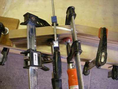

Postby Patrick DeGreve » Sat Apr 21, 2012 12:14 am
I glued the back on the same way.

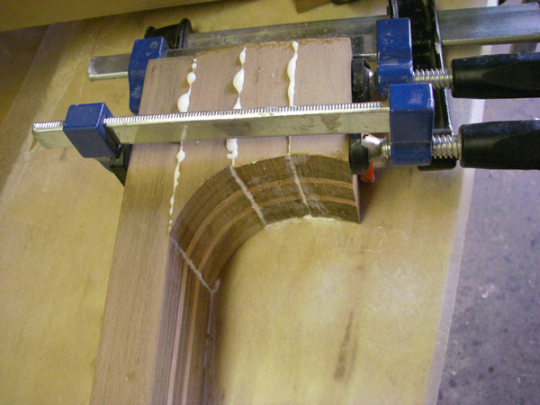

Postby Patrick DeGreve » Sat Apr 21, 2012 12:20 am

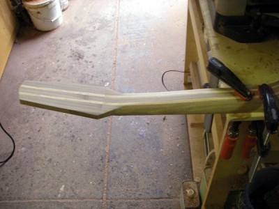

At this point I went back to the neck. I cut a 14 degree angle in the neck block for the peghead, and using a plane, scrapper, and sanding block I smoothed the joint for a good fit. Here I glued the peghead onto the neck block.
Patrick DeGreve
Posts: 307
Postby Patrick DeGreve » Sat Apr 21, 2012 12:22 am
Then I glued the heel pieces on the neck block.
Patrick DeGreve
Posts: 307
Postby Patrick DeGreve » Sun Apr 22, 2012 1:32 am
Because I want the peghead to be just a little bit wider than the neckblock, I glued two "wings" onto the peghead.

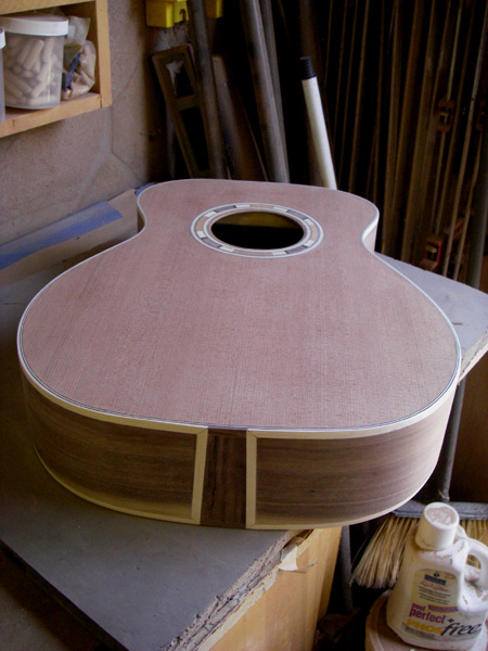

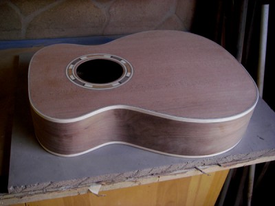

Next I went back to the body. Using a homemade jig, I routed binding channels in the sides for purfling, and binding. I glued and taped the purfling, and binding to the sides. Here is a shot of the sides, after scraping and sanding.
Patrick DeGreve
Posts: 307
Postby Patrick DeGreve » Sun Apr 22, 2012 1:42 am
Here is a shot of the back. The bindings were cut from some maple I have.
Patrick DeGreve
Posts: 307
Postby Patrick DeGreve » Sun Apr 22, 2012 1:43 am
Picture of the top.
Patrick DeGreve
Posts: 307
Postby Patrick DeGreve » Sun Apr 22, 2012 1:45 am

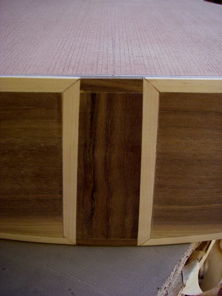

Here is a closeup of the heel binding.
Patrick DeGreve
Posts: 307
Postby Patrick DeGreve » Sun Apr 22, 2012 1:47 am
And a shot of the purfling and binding.

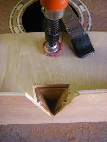

Postby Patrick DeGreve » Fri Apr 27, 2012 11:20 pm

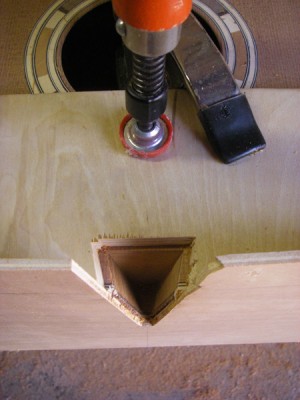

I have had a busy week, and haven't posted any pictures, but I have been able to do some work every day. I routed the dovetail using a simple jig.
Patrick DeGreve

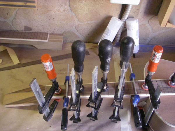

Posts: 307
Postby Patrick DeGreve » Fri Apr 27, 2012 11:39 pm
Here I am gluing the fretboard onto the neck.
Patrick DeGreve
