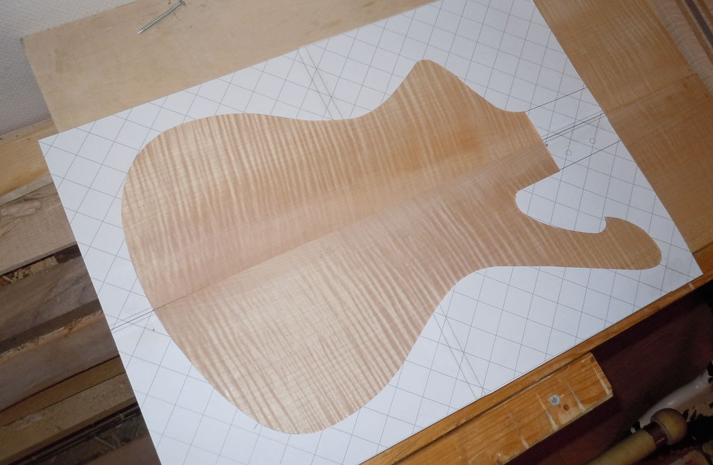

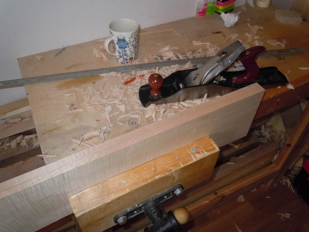

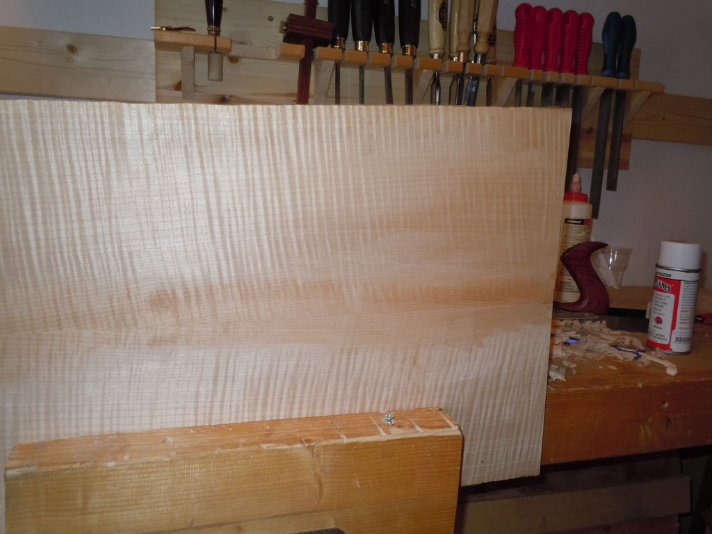

The day started with cleaning up all the maple and jointing each piece for the back and then gluing that up:
Then it was time to joint the bookmatched top ready for glue-up (my ever-present coffee mug was closer than usual during this process):
I spent a lot of time tweaking to make sure the joint was as tight as possible, then glued it up. I wasn't going to be able to clamp this satisfactorily so I wound up using dots of CA at the extreme ends of the wood and Titebond in between - this seems to have worked great, and let me finely tweak the position of the wood:

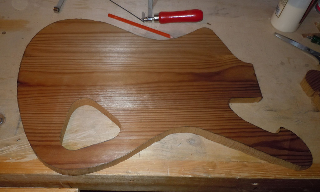

Some mocking up with the offcut from the plan printout was in order:
I set that aside after that little bit of fun to let the glue fully set up, and moved on to cutting out the guitar shape into the middle layer:
A reasonably aggressive blade in a coping saw makes surprisingly quick work of this job, although I think I'll build a 12" bowsaw like the Gramercy ones at some point. I chose to take advantage of the layered construction by cutting the control cavity right now:
Finally it begins to look like a guitar! The Iceman-ish shape is actually extremely comfortable - that huge horn sits very positively on the knee, and the slightly offset upper waist is a better fit to your ribcage than a symmetrical one.

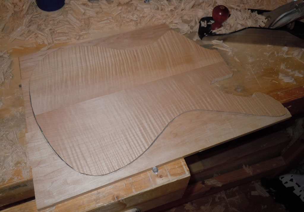

I got impatient after 12 hours and decided to work some more on the back. I first flattened and smoothed the side that will be glued to the pine:
Then I cut the shape, again with the coping saw. This time under the beady-eyed supervision of my master:
This "plain" maple has some nice undulations to the grain. It gives a nice iridescent effect to the wood.

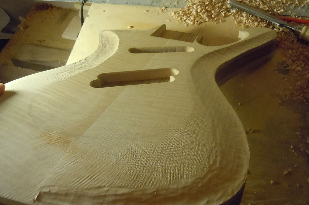

Carving, carving, and more carving! I started by wasting away most of top contours with rasps, then started carving the top. I'm doing this by hand, with a gouge:
Carving is fun! This is where I left it off this evening. Plenty more to do, then a LOT of sanding...

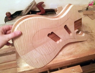

Plenty of rasp and spokeshave work on the back to give it a simple bevel for the most part, with a broader bevel around the ribcage area:
Before starting the carving I marked guidelines on the side so that I'd be left with a faux-binding on both top and back. I love the result:

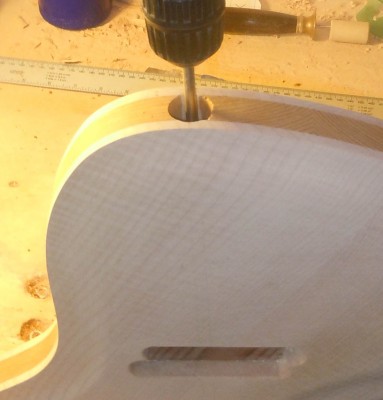

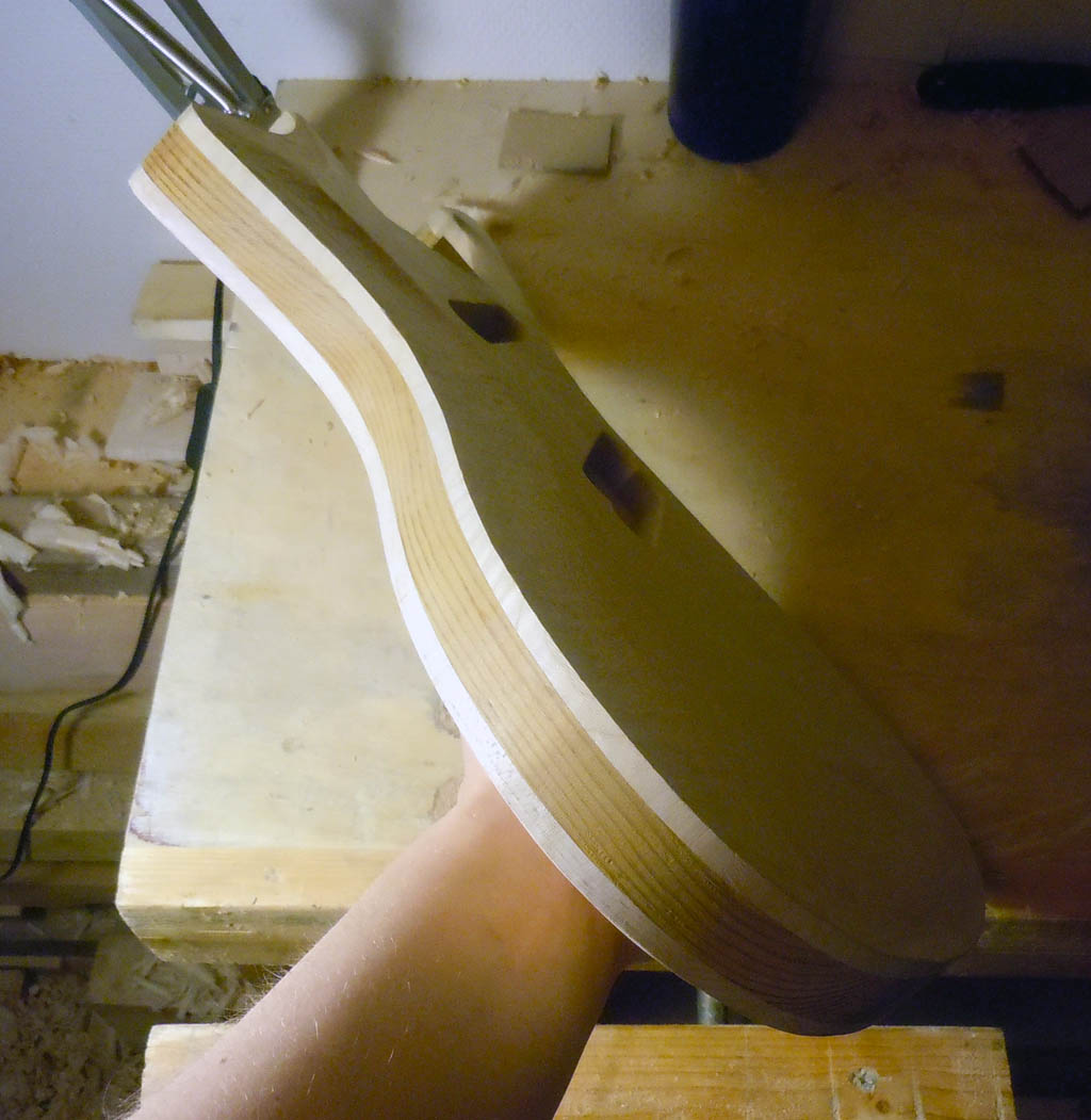

Yesterday after completing the rough sanding I took a break by drilling the rest of the holes that needed to be made. First came the jack hole:
Then I drilled the long hole through to the pickup cavities - investing in a good quality extremely long bit is well worth it:

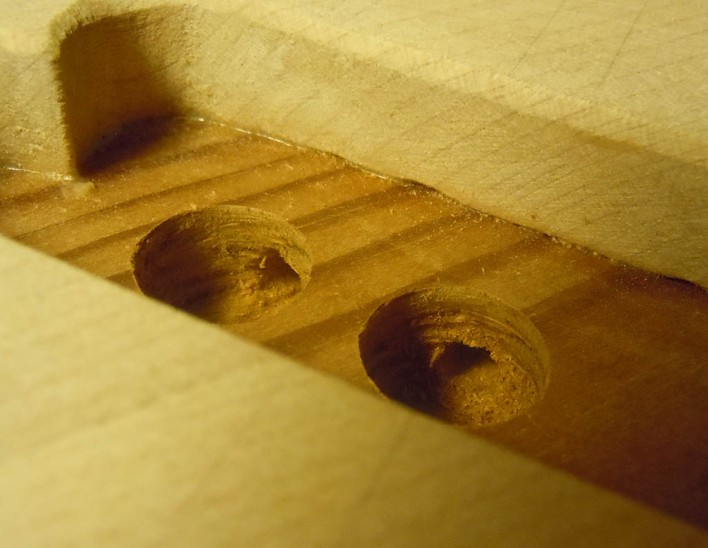

Next I used a Forstner bit to drill down in the pickup cavities and find the holes. It would have been a better idea to cut slots in the pine part before the glue-up, but in my eagerness to get it in one piece I clean forgot.

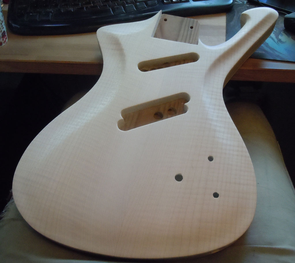

Next up I laid out and drilled for neck mounting bolts. I'm using ferrules on these, so I counterbored them with a 15mm Forstner bit for a nice clean recess:
Here is how it looked after sanding:
I've decided on a blue finish, so I have just applied the first coat - black. This will be almost totally sanded away.
