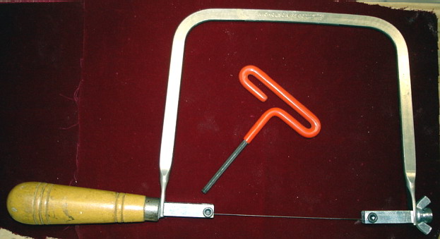

I did once make a jig for the jigsaw that kept the jigsaw at the correct plane for coping crown. The results were really good, I have to say, but the crown had to be clamped and unclamped from the jig (I used shims) and my POS jigsaw loves to blow dust right into my eyes. And someone invented it already! It did save a little bit of time, but the cleanup afterwards was way longer.

With a bit of modification the coping saw becomes and excellent inlay saw, much preferred over that other brand...
