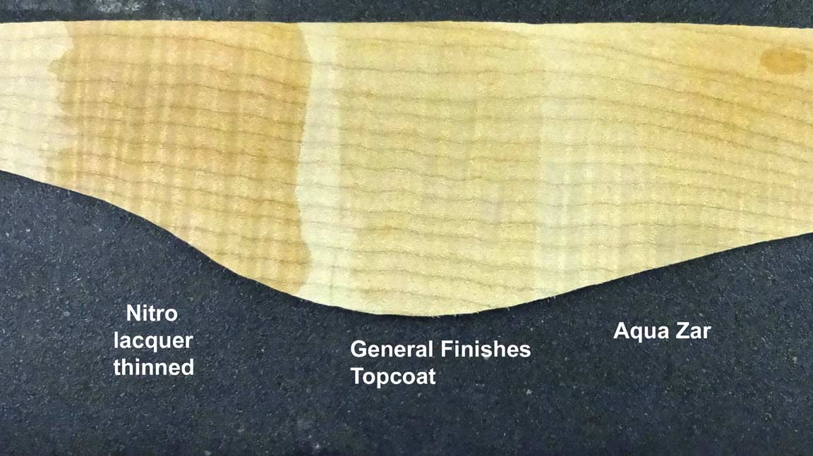

Postby Peter Wilcox » Mon Apr 24, 2017 11:52 pm
I've not had much satisfaction with the water based finishes. I couldn't brush on the General Finishes Top Coat smoothly and it took a lot of coats and sanding to get it flat, and then I couldn't polish it to a good gloss - my fault, I'm sure. I decided to use a waterborne polyurethane again, sprayed on a guitar that needed to be built and finished in less than a month, so found one I could get locally, Aqua Zar. When I was testing on scrap I was more concerned with dye color, and didn't really notice the low contrast of the maple's figure until I had it on the guitar and saw how bland it looked. So I put it, the General Finishes, and nitro lacquer on the wood for comparison. Yechh!
Back to nitro for me, even if it kills me, unless someone can suggest how this problem might be overcome. :(

Doesn't the epoxy pore fill, aside from filling pores, "wet" the wood and pop the grain? I've not done this. On my recent projects, I chickened out and went with tung oil over shellac, and the shellac does wet the grain and give that lustrous depth.
Re: General Finishes Waterbase Topcoat - SM is pushing this - anyone tried it?
Postby Bryan Bear » Tue Apr 25, 2017 10:27 am
Peter, that picture is very telling! My first thought was the same as Jason's to "pop" the figure with epoxy (assuming your poly would stick to it). But, Like Jason, I've not tried it myself.

Postby Peter Wilcox » Tue Apr 25, 2017 12:59 pm
My problem brushing the Top Coat probably had to do with low humidity and temperature (60 degrees) that didn't let it level well. I used a foam brush and thought I was keeping it wet and no overbrushing. Maybe it's a summertime finish. I also applied it over shellac, which let the figure come through.
The Aqua Zar states specifically not to apply over shellac or lacquer, so I'm hesitant to do so. Maybe epoxy is the answer, but it's another step to go through.
I've also gotten fish eyes with the Aqua Zar, but it's my own fault for initially not using an air filter. I haven't tried to polish it yet as I'm still in the process of coating and sanding.
The cheapest I could find the General Finishes was $27/quart plus shipping (no one carries it within 75 miles), whereas locally the AZ is $18 plus CA tax = $20 total.
