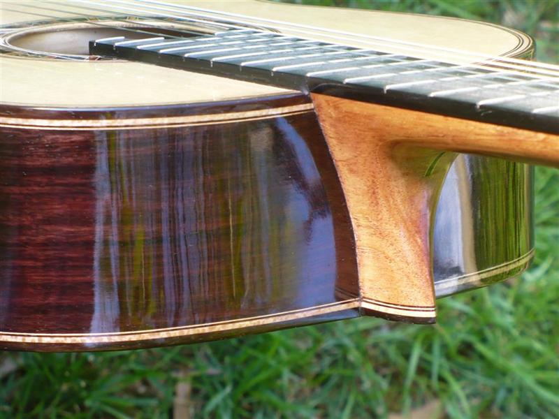

In looking closely at a recently finished guitar right now, it appears that most of the irregularities appear to be small straight lines parallel to the grain. I'm guessing these are very small ridges of shellac being left by the pad cover.
