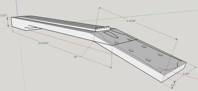

Here is an example of a neck that shows the neck resting within the blanks that will be used to make it:

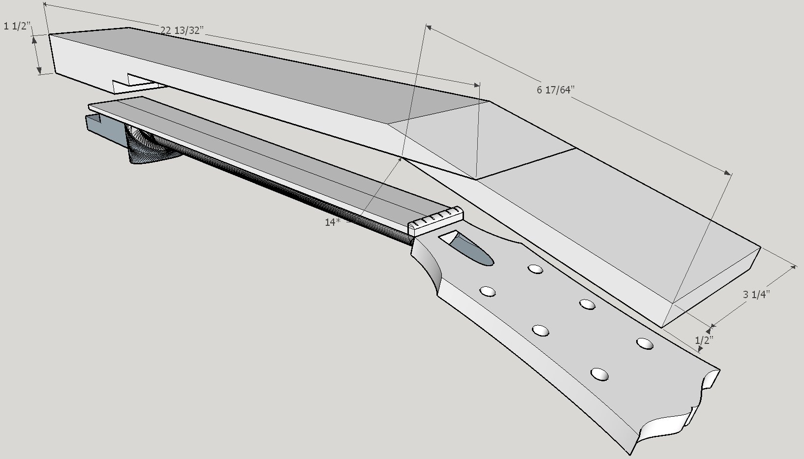

Here is the same set of components, pulled apart:

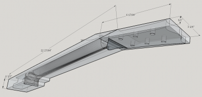

Here is an x-ray view of both the blanks and the neck. Note the rough layout of the volute, and that the blank hasn't yet been modified to provide some "meat" from which to carve it:
