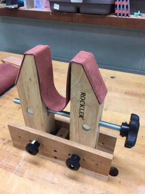

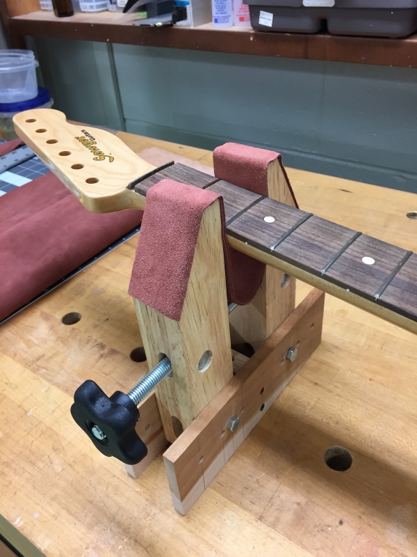

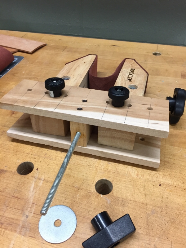

I really like the looks of the StewMac guitar repair vise, but at over $150 it's a bit steep, so I cobbled up one of my own for less than $20 and some odds & ends around the shop. An 8" wooden handscrew forms the basis. The knob is one of those from a jig fastener kit that everyone sells. I drilled out the 5/16" brass threaded insert on my mini lathe and pinned it to the screw using a spring-pin. I pivoted the bottoms of the jaws with some bushings from the local hardware store. To secure it to the bench through one of the bench-dog holes, I threaded the center block for a 1/4-20 piece of threaded rod, and epoxied it in place. Some leather secured to the jaws with some contact cement finished it up.

I spent a lot of time thinking about this before I arrived at the simple solution. Some of the earlier designs would have taken me a week to realize instead of an afternoon!! :mrgreen:
