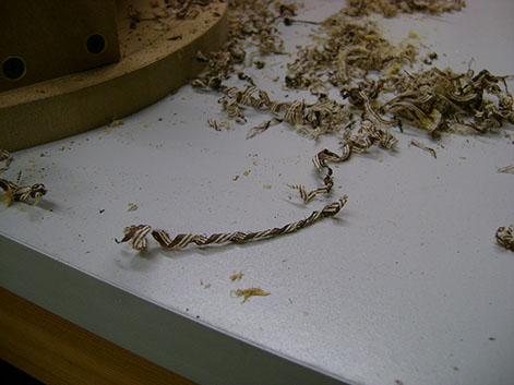

Bryan, if you want to have some fun with a scraper try scraping some Bz. rosewood or cocobolo. It scrapes almost like creamy hard plastic if your scraper is sharp.
The reason for different approaches to sharpening scrapers are many, but the important ones are dependent on the job at hand. For example, rough material removal likes a coarse and maybe even ragged edge, but for finish surfacing wood you need a much finer and smoother edge, I use card scrapers for leveling finish, especially for drop fills, and for this you need a very smooth and sharp edge. Stone the edges square with a fine stone and then do the edge drawing and roll the hook over. For the fine edge you don't need much hook, and hold the scraper as close to vertical as you can get it to bite. This keeps the cutting edge supported so it lasts longer.
